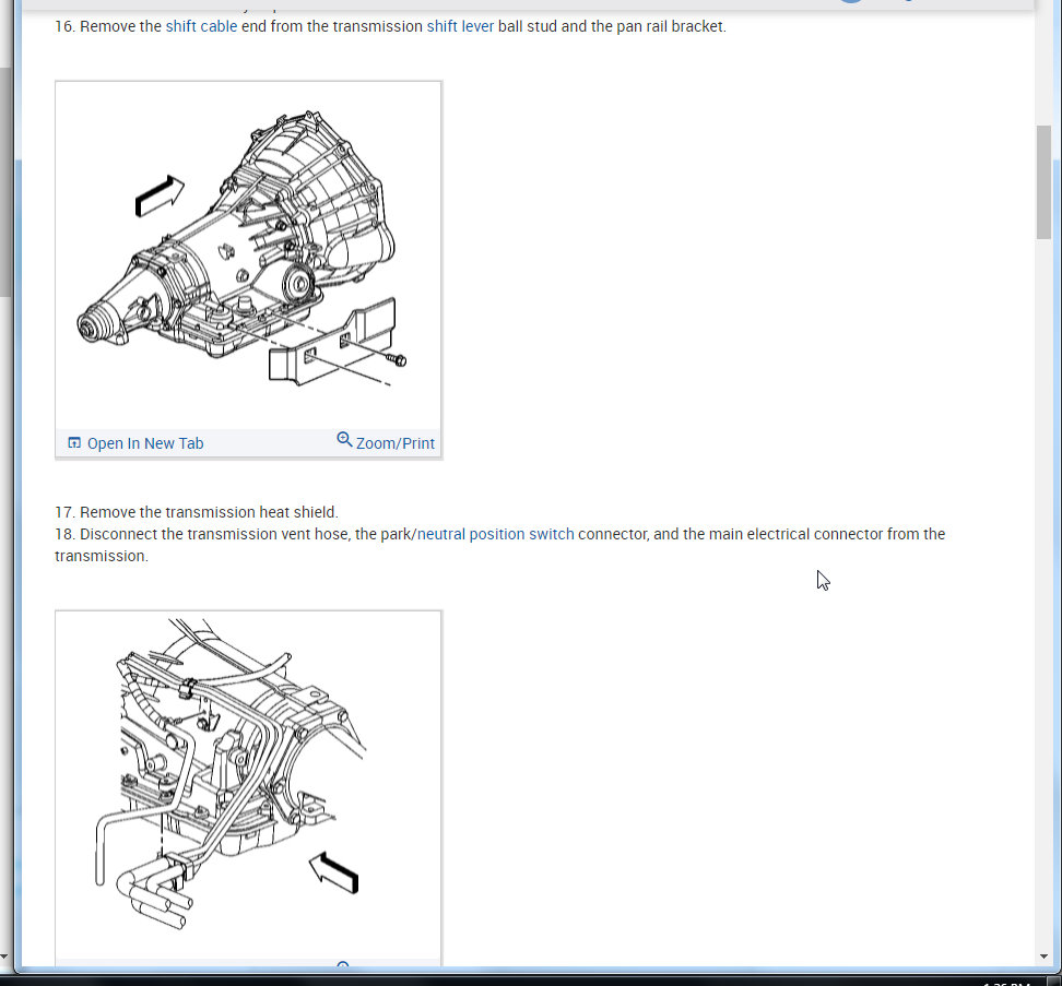

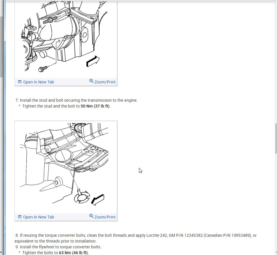

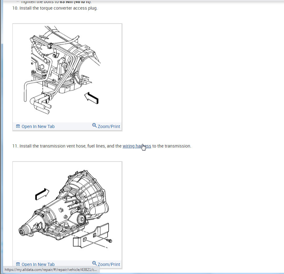

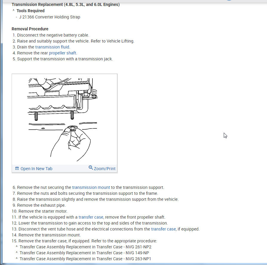

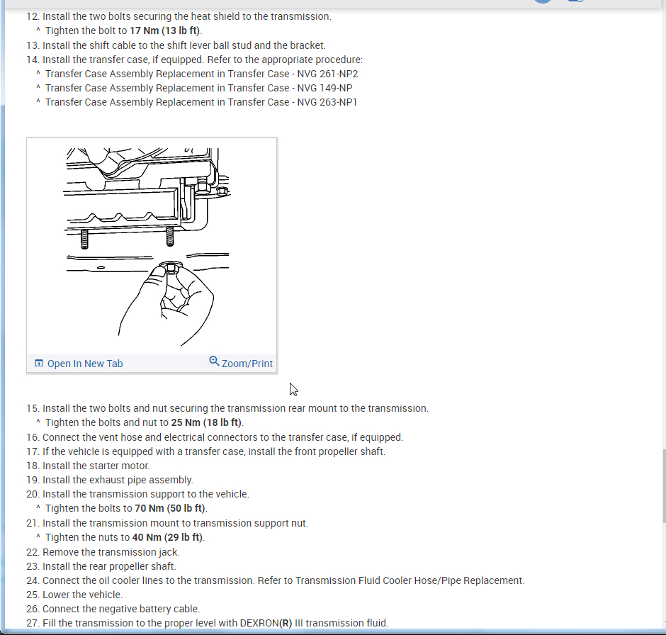

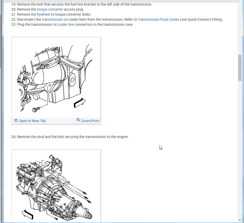

It does sound like you need to new unit. Here is a guide that will help with this:
https://www.youtube.com/watch?v=3vJAojsrfuU
Below is the process from the manual on how to replace the unit.
Please run through this material and let us know if you have other questions. Thanks
