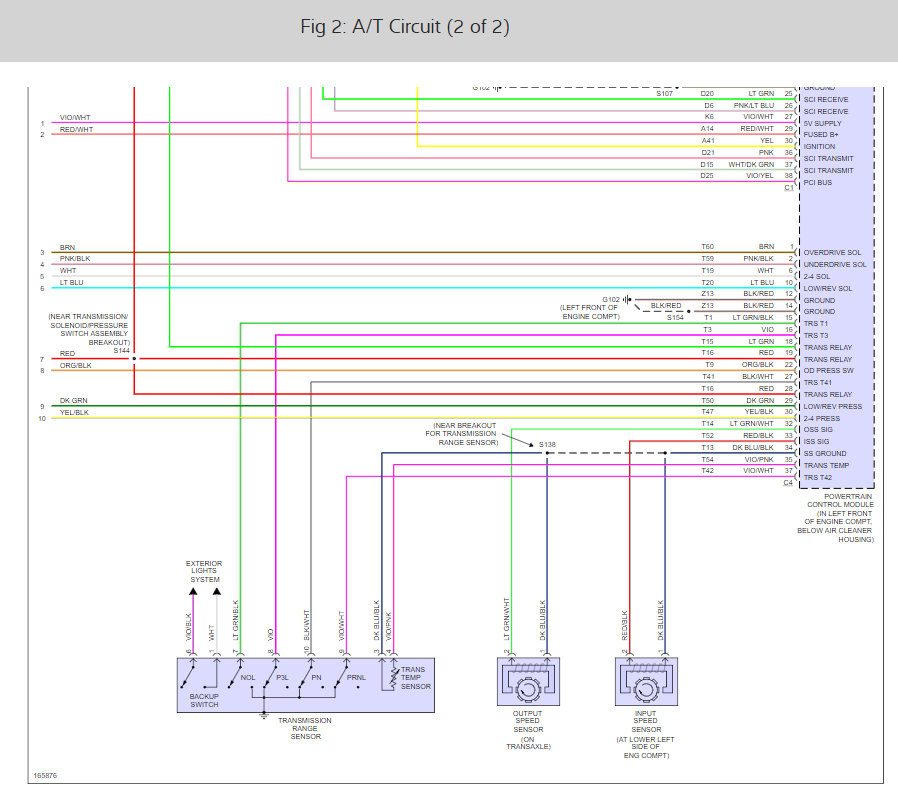

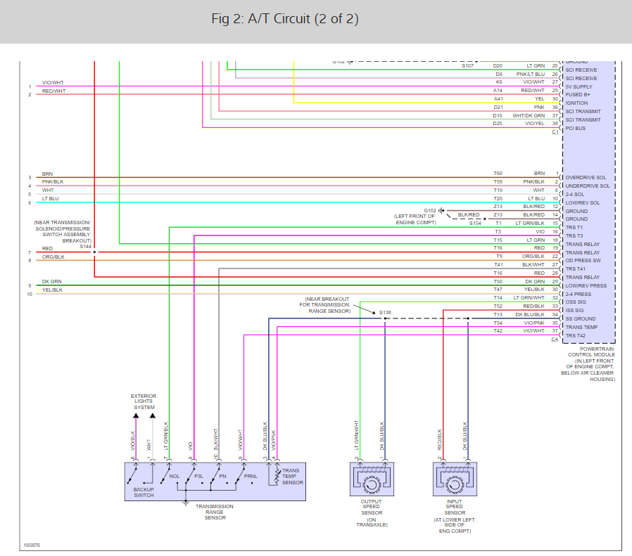

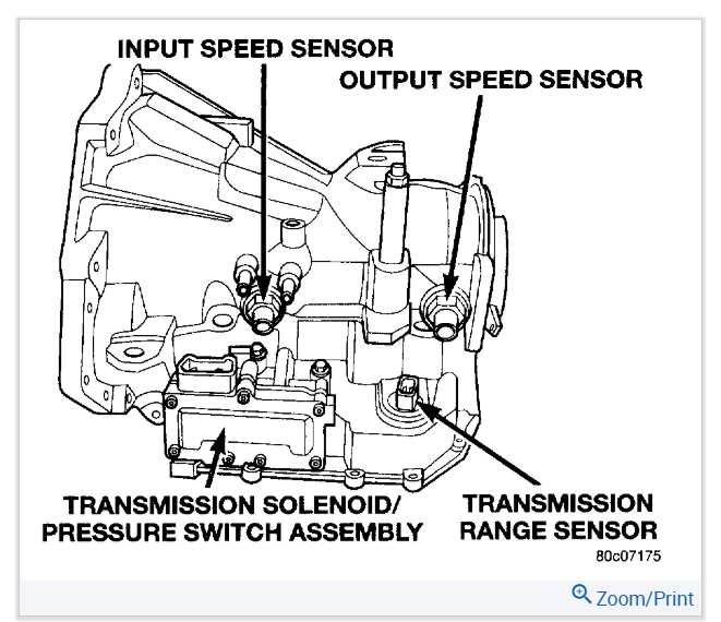

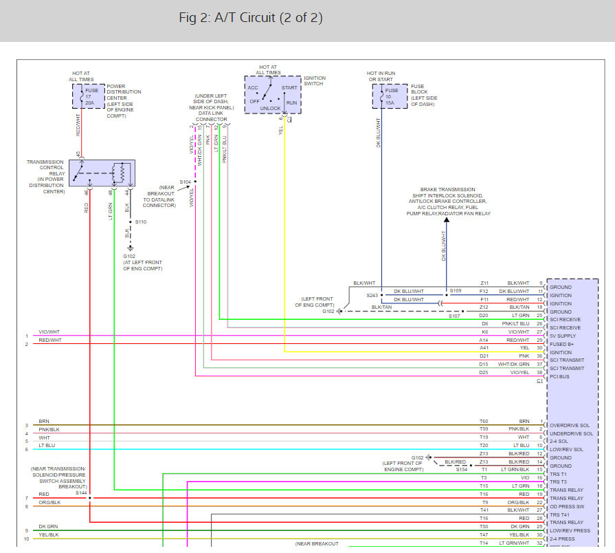

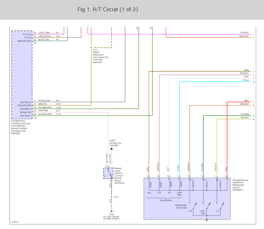

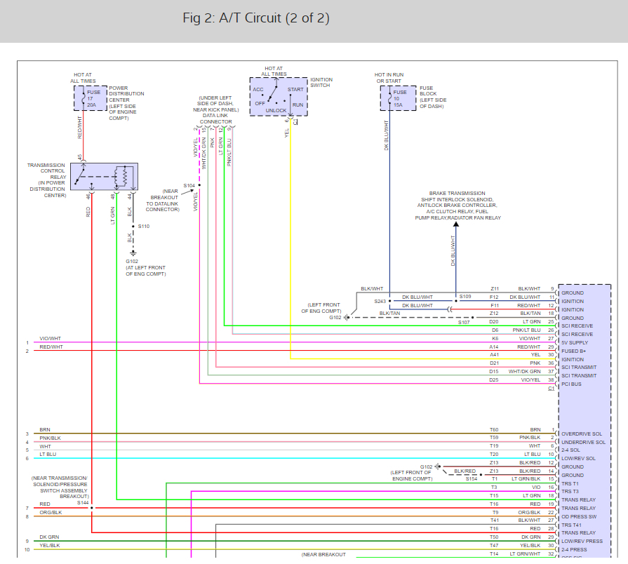

I was driving my car and got off the freeway, stopped to get has and when I left the gas station I noticed it would not shift out of first gear. It shifts into drive and reverse just fine but when driven will not go beyond first gear. Before this happened it shifted extremely smooth and had absolutely no issues. We had changed the transmission control module and it did not help. Any ideas?
