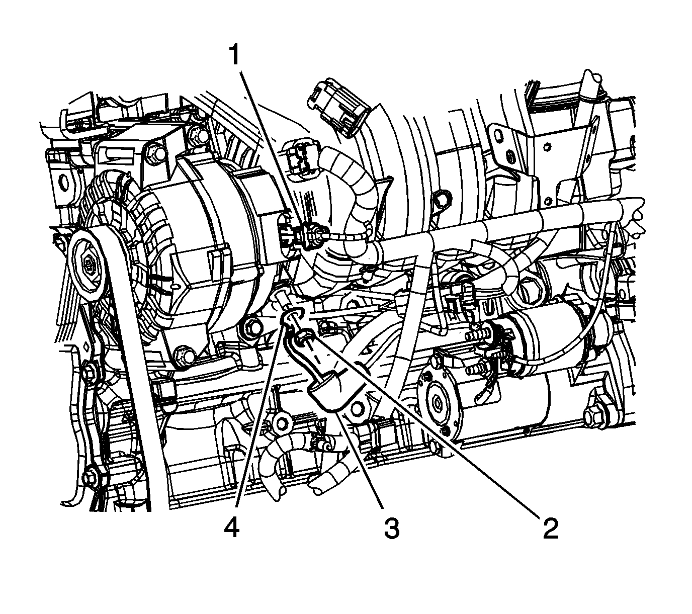

4. Remove the radiator inlet hose.
5. Disconnect the generator electrical connector (1).
6. Reposition the rubber boot (3).
7. Remove the engine harness terminal lead to generator nut (2).
8. Remove the engine harness terminal (4) from the generator stud.

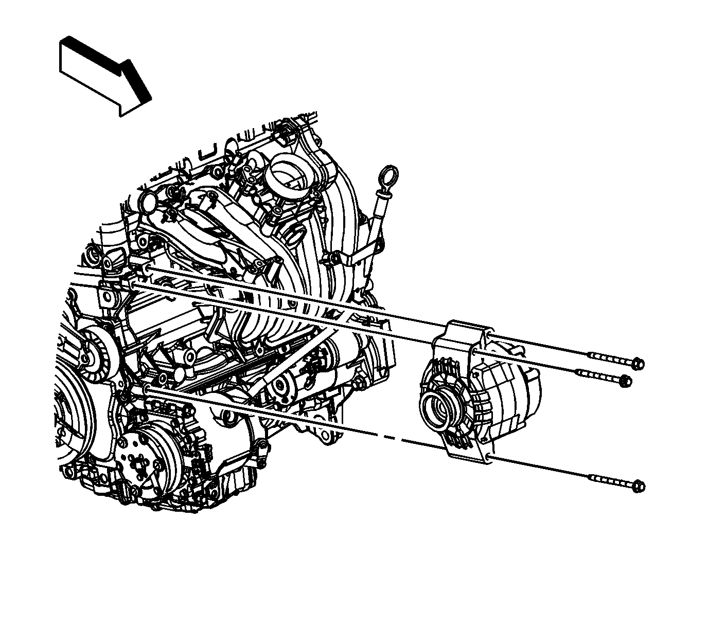

pic 2
9. Remove the generator bolts.
10. Remove the generator.

pic 4
3. Install the engine harness terminal (4) to the generator stud.
4. Install the engine harness terminal lead to generator nut (2).
Tighten the nut to 20 N.m (15 lb ft).
5. Position the rubber boot (3) over the stud.
6. Connect the generator electrical connector (1).
