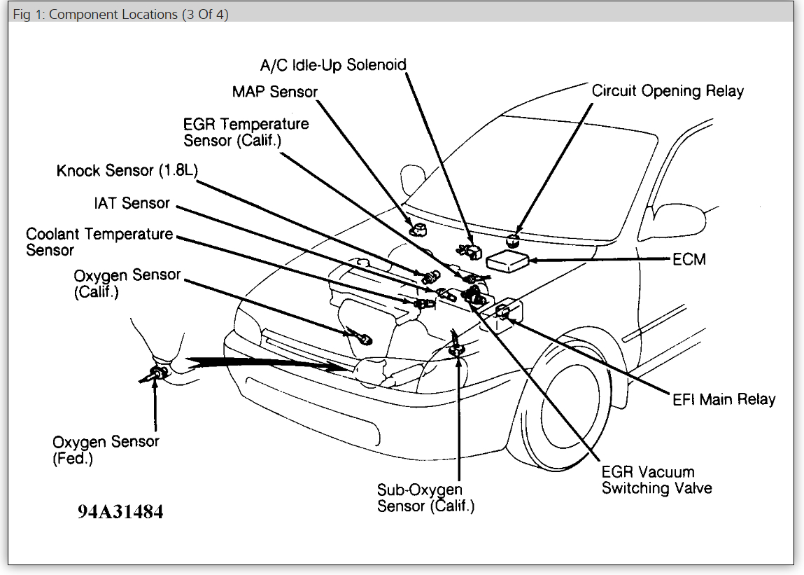

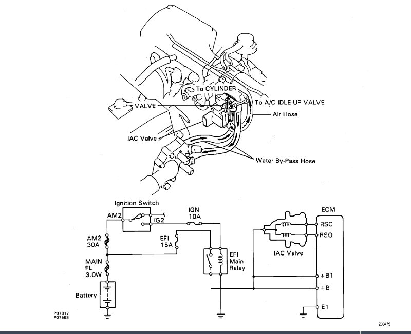

A couple weeks ago, my car started hesitating once it got to its normal operating temperature at slow speeds. It was intermittent, mostly when I was accelerating from a stop. When I tried to accelerate, the rpm's would fall to around 200 to 400, with no shaking or backfiring. I had really step on the gas, it might creep forward a few inches, stop, creep forward again, then the rpm's would jump up and my car would take off like nothing was wrong or it would stall. When it stalled, it would start right back up usually, sometimes stalling again or would drive like there is nothing wrong with it.
The problems gotten a lot worse. My car reached normal operating temperature on the highway and the rpm's suddenly dropped off, but picked back up again. Once I got off the highway, my rpm's would drop off every time I would slow down, and my car would try to stall out. Once it stalls, it will not start until my car's had time to cool off, and will not run unless it has cooled off for at least forty five minutes.
Now this happens every time I drive it and it gets to its normal operating temperature. If I am in traffic, the temperature will creep slightly over its normal, and I start having trouble.

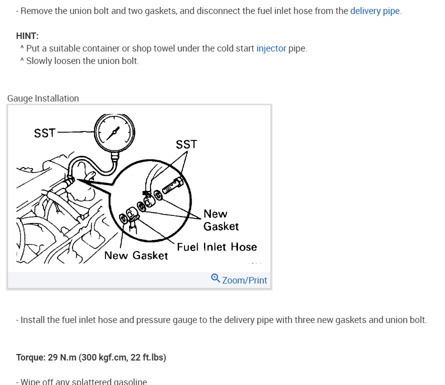

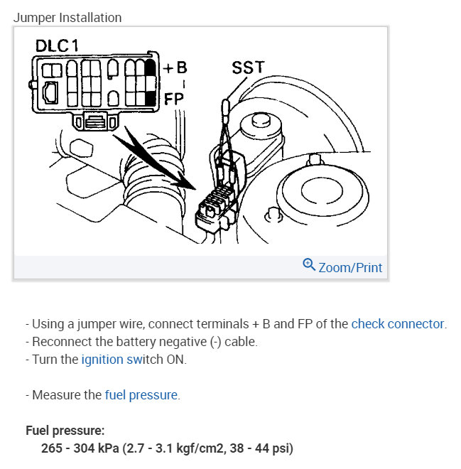

I have changed the distributor cap, rotor, spark plugs and wires, air filter, fuel filter, and coil out a few days ago, and it has not helped. The fuel pump is only six months old. I have checked for vacuum leaks, and taken a look at my PCV valve, pressure regulator valve, lines, etc.
