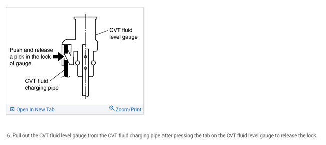

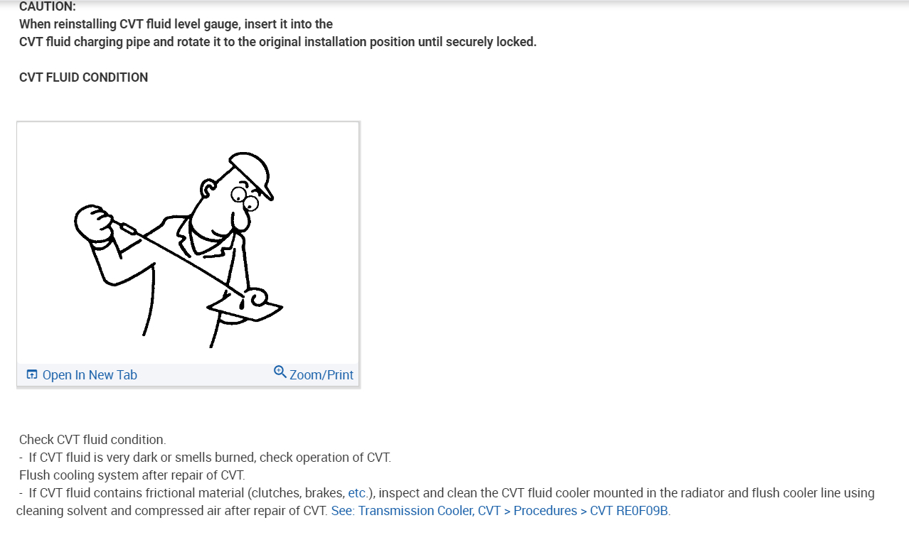

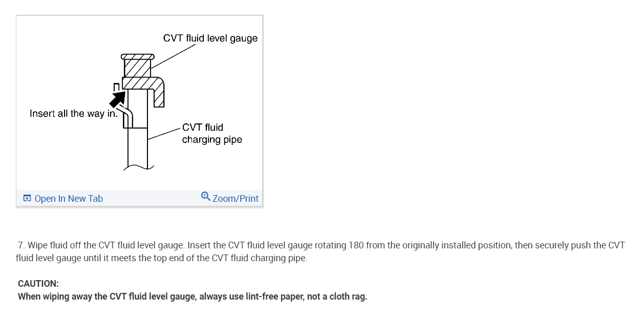

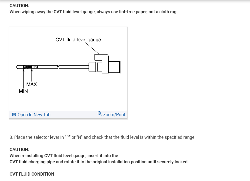

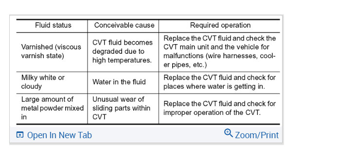

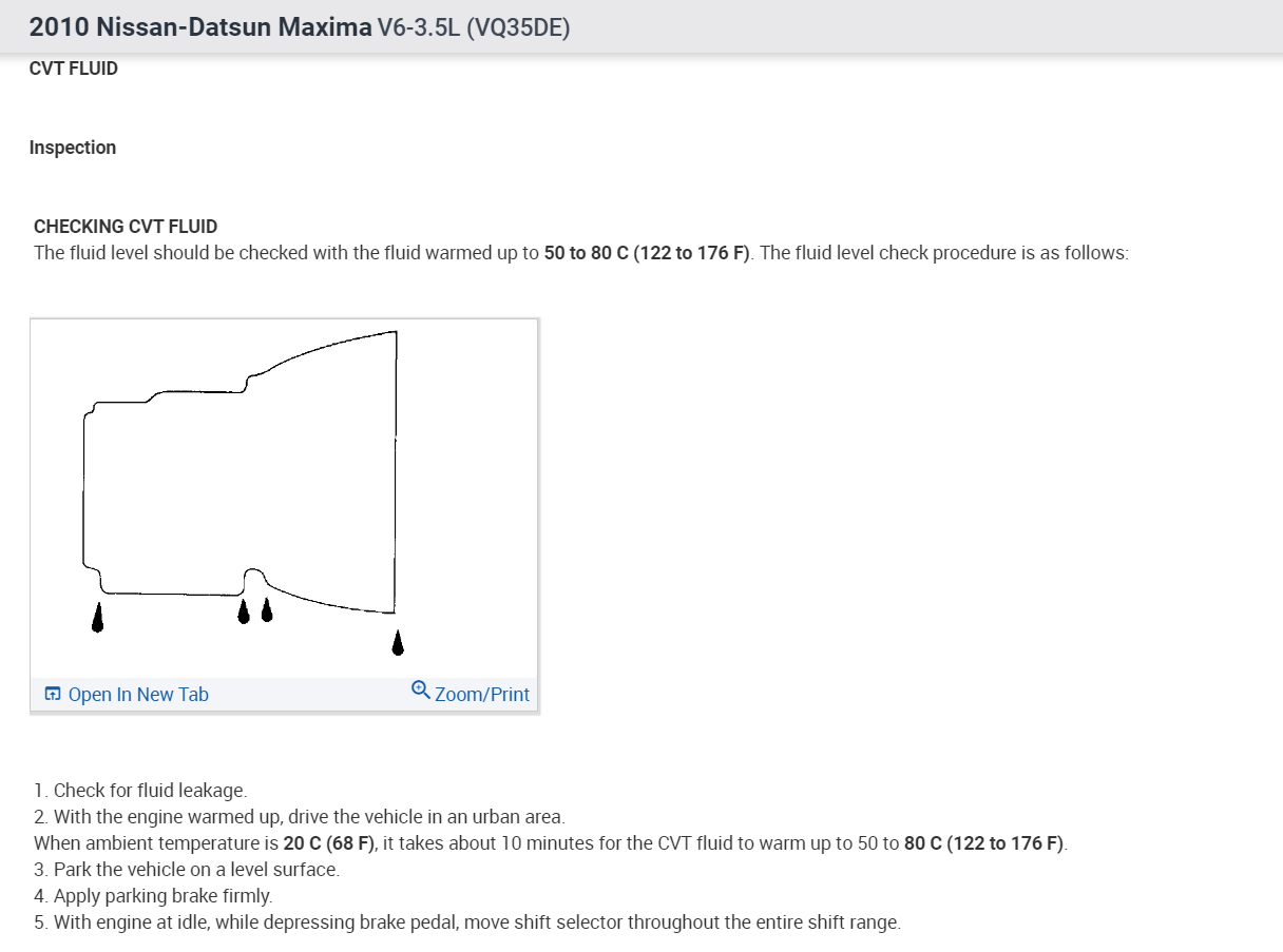

Here is how to check the fluid and a guide as well:
https://www.2carpros.com/articles/automatic-transmission-problems
Check out the images (below). Let us know what happens and please upload pictures or videos of the problem so we can see what's going on.
