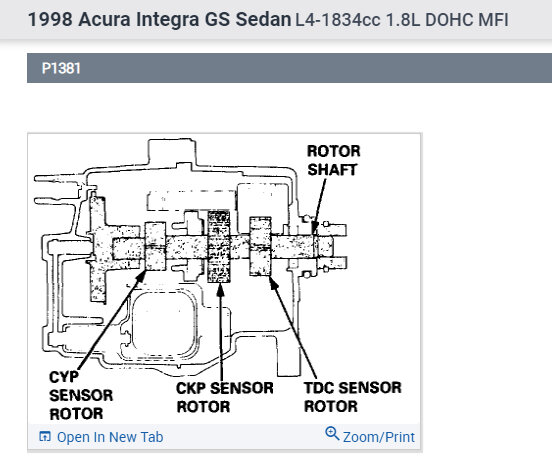

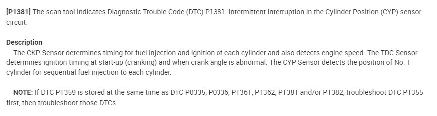

The code indicates there is either a wiring issue to the sensor or the sensor itself has failed.

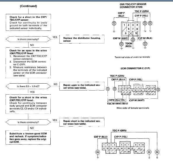

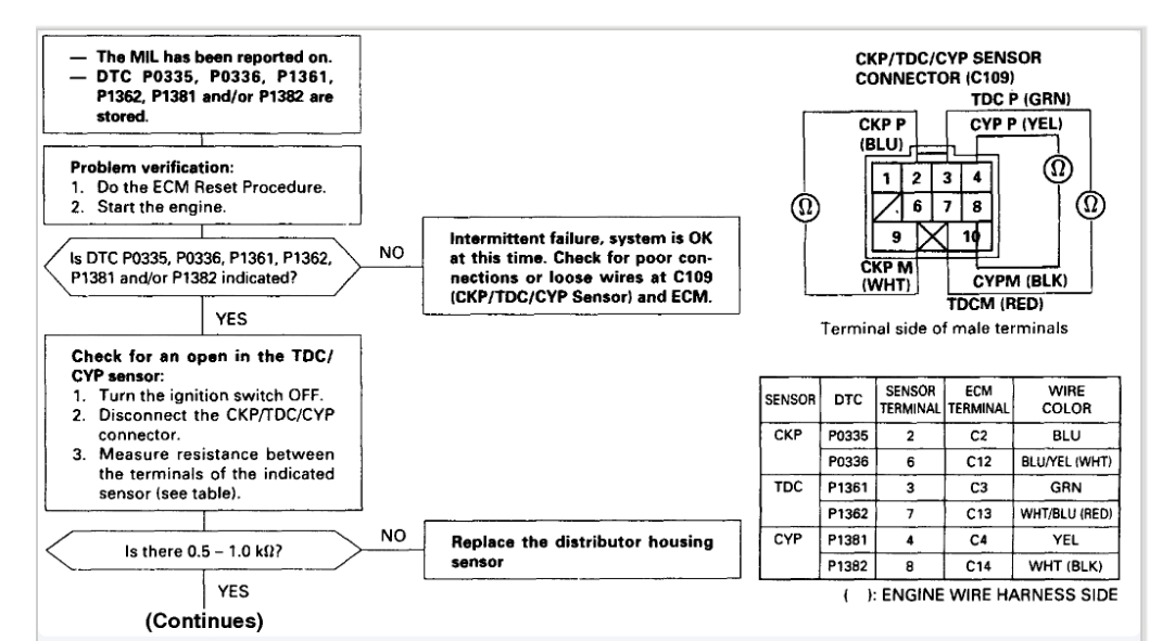

Do me a favor. I attached the diagnostics below specific to this code. Take a look through them and let me know if you are comfortable performing them.
See pics below.
