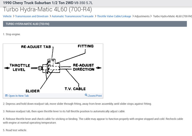

Okay I have the vehicle listed above Sierra with the 350 and the 700r4. When I had gotten the truck transmission only had 1 and 2 gear but ran and drove fine. Then one day when I was driving it jumped time so I said okay I'll swap transmission as well. I redid the timing and no issues, then I went and swapped the transmission and issues aroused. It would start but when put in gear it'd take about four seconds and would stall out. So I would give it a little gas so it wouldn't shut off but it wouldn't move. So I gave it more and more and finally it moved but at all crawl and I was at about 60-70% throttle. So I asked so Mechanic and he told me it was the TCC solenoid. I replaced it and now it doesn't stall but it still won't go without giving way too much throttle. I'm stumped and I need help.

Just a quick question first. Did you or a garage/shop install the transmission? The 700R4 transmission requires a T.V. line adjustment for proper performance.The symptoms you describe sounds like it's not properly adjusted. Get back to me and let me know.Hope this helps and thanks for using 2CarPros.

I did it and the tv was real tight when installed, then next day was loose. I didn't think about that. How do I adjust it properly sir?

So I watched a youtube video and tried to adjust it to max TV and when the throttle is left alone I can adjust it but when I move the throttle to full like it says and try to adjust it I can't move it at all.
Sep 1, 2019 at 10:13 AM
Here is how you adjust the TV cable. Check out the diagrams (below). Please let us know what you find.
