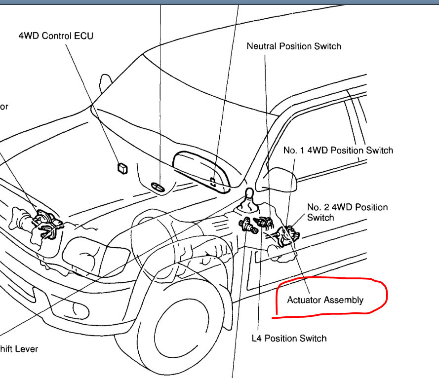

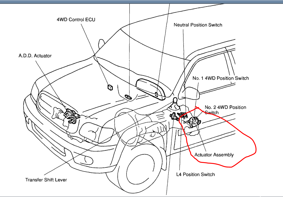

I attached a picture of the actuator to help locate it. I suspect that it isn't engaging properly and may be going into the neutral position. i need to just confirm if this is a push button system for 4wd or is it full time awd.

I suspect, based on your description, that the actuator is not fully engaging and is placing the transfer case in neutral. At this point, the actuator should be removed and inspected. If you have 4wd when selected, I doubt anything is wrong with the actual transfer case.

Where is it located? can you send me a picture of how it look?
Jan 13, 2020 at 4:35 PM
Hi:
It will be on the driver's side mounted to the transfer case. I have a long diagnostic flow chart for checking, but it is quite involved. However, if you want it, I would be happy to send it to you. Just let me know.
As far as a pic, this is the best I could find. More than anything, it shows location. Let me know if it helps.

There should be an electrical connector at the actuator motor as seen in the above pic. Make sure it is attached, not damaged, and there is no corrosion in the plug.
