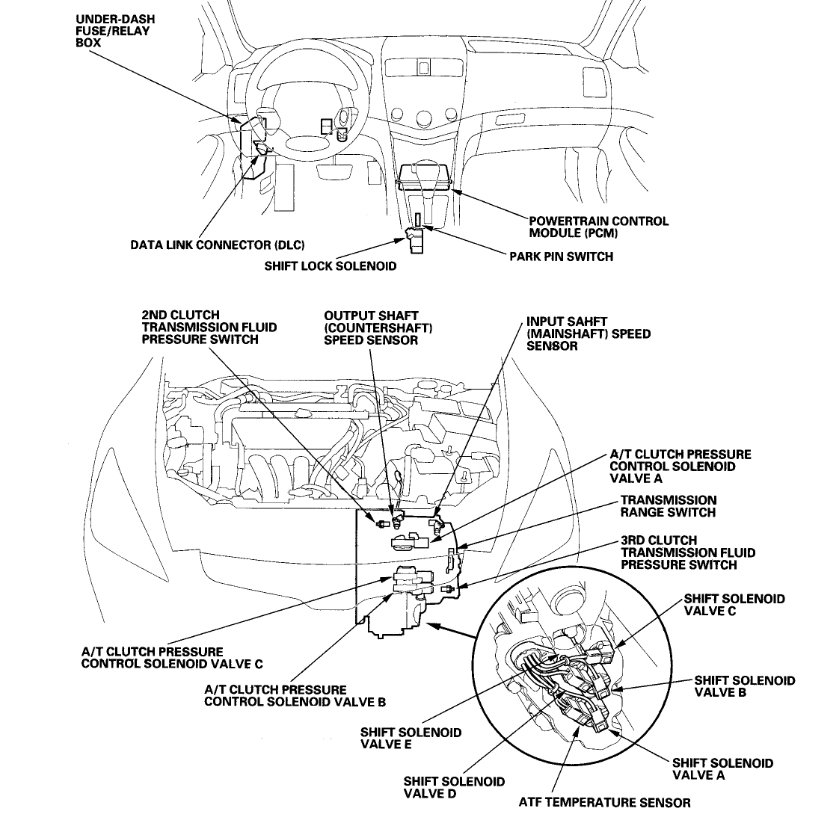

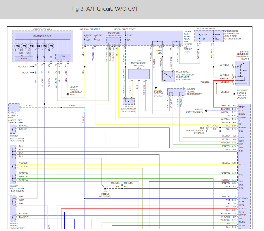

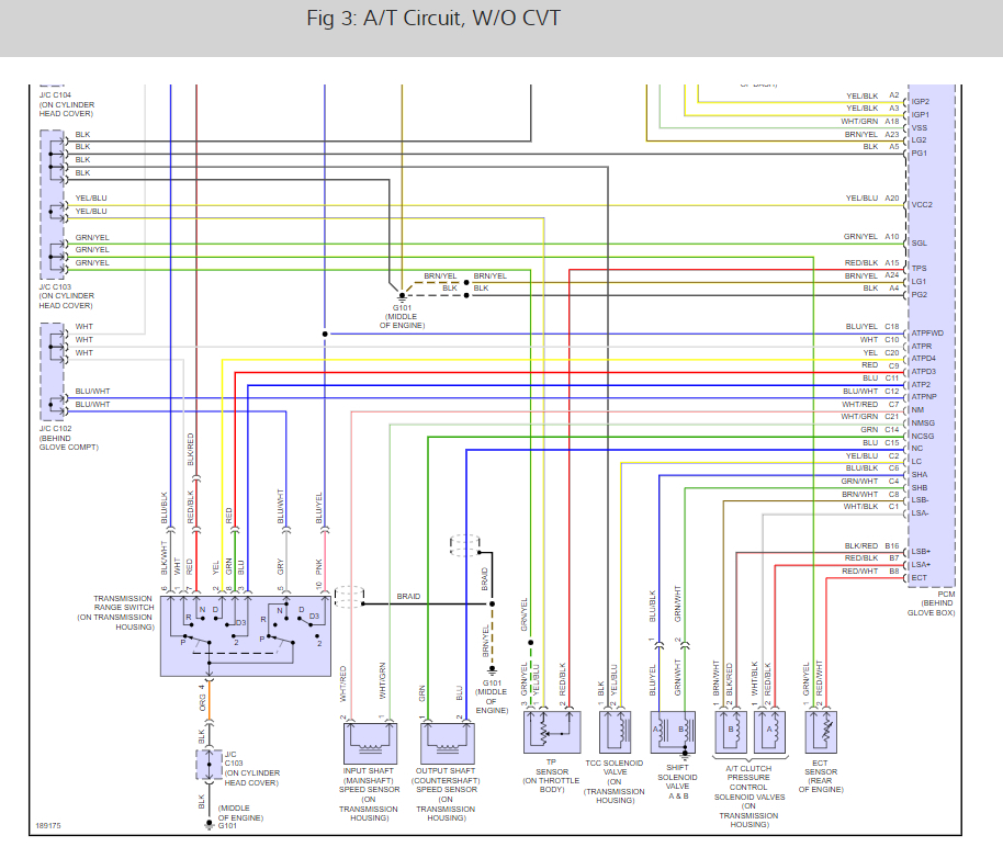

Blown engine swapped out with a replacement, original transmission on new engine. Swap went okay, it runs fine.

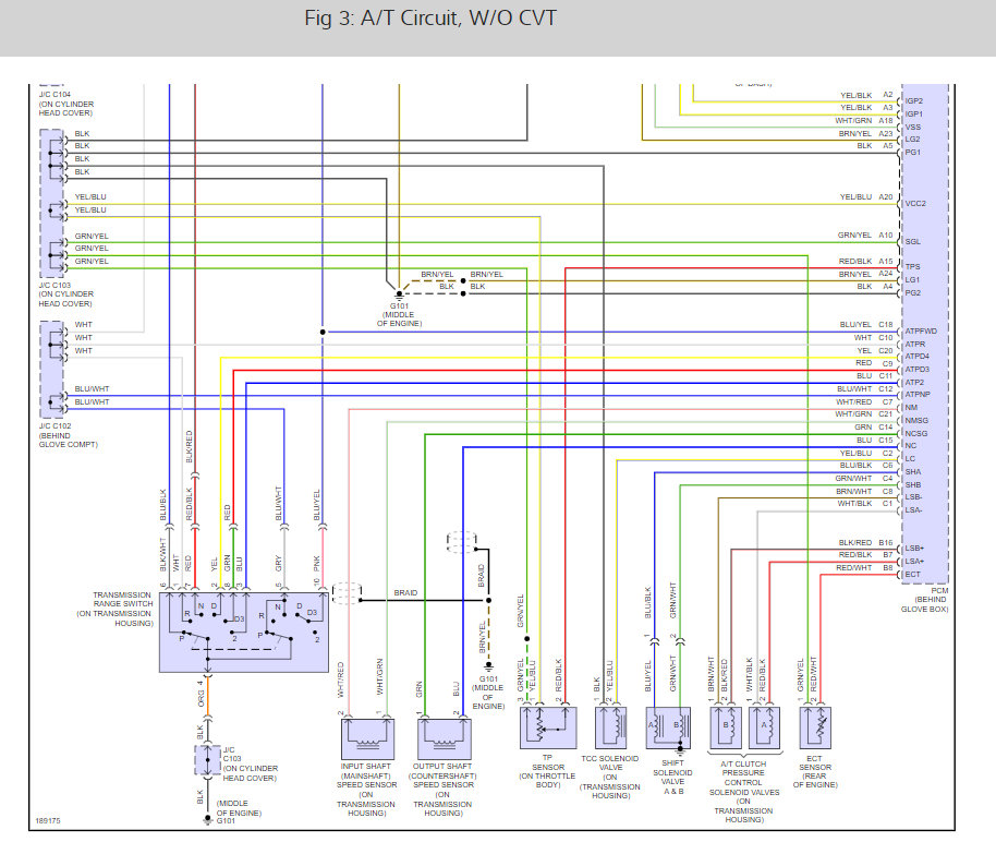

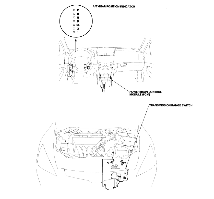

It shifts into P, N, R, D, D3, and 2 just fine. However, when in drive, it does not leave first gear. The dash does not show any changes in shifting, it just shows as park. Code read a bad shift solenoid B, replaced it, still same issue.
