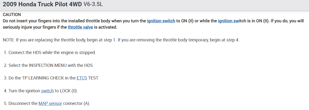

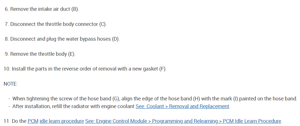

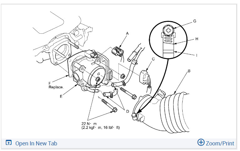

Air intake port? Do you mean throttle body? If so, did you remove the wiring connector or move the throttle bore butterfly plate? If so, the throttle bore will need to have a relearn procedure to help it run correctly again, here is a guide to help you understand what the problem is, and I have included instructions on how to fix it in the images below.

Procedure
1. Make sure all electrical items (the A/C, the audio, the lights, etc.) are off.
2. Reset the PCM with the HDS.
3. Turn the ignition switch to ON (II) and wait 2 seconds.
4. Start the engine. Hold the engine speed at 3,000 rpm without load (in P or N) until the radiator fan comes on, or until the engine coolant temperature reaches 194°F (90°C).
5. Let the engine idle for about 5 minutes with the throttle fully closed.
Note: If the radiator fan comes on, do not include its running time in the 5 minutes.
Check out the images (below). Let us know how it goes.
