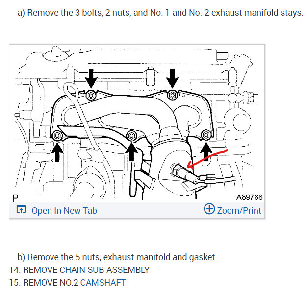

There are three main reasons this can happen, first please check the air filter. If that looks okay let's test the primary catalytic converter. You can remove the primary oxygen sensor which should help.
