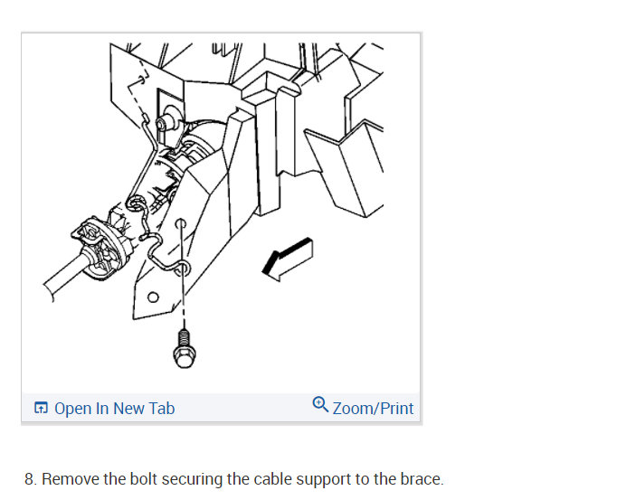

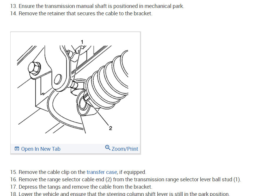

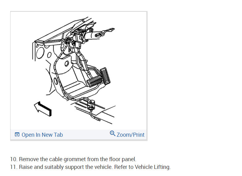

My truck won't shift into park. What could be problem?
Sep 29, 2019 at 5:51 AM

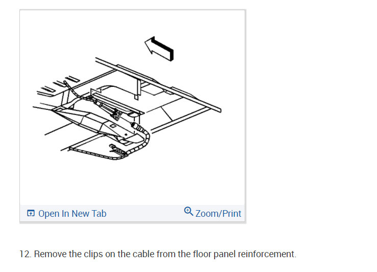

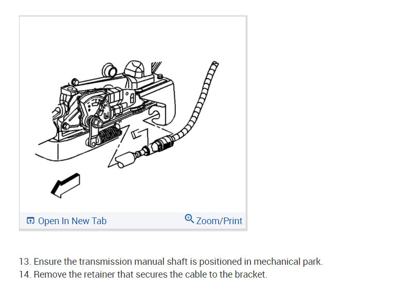

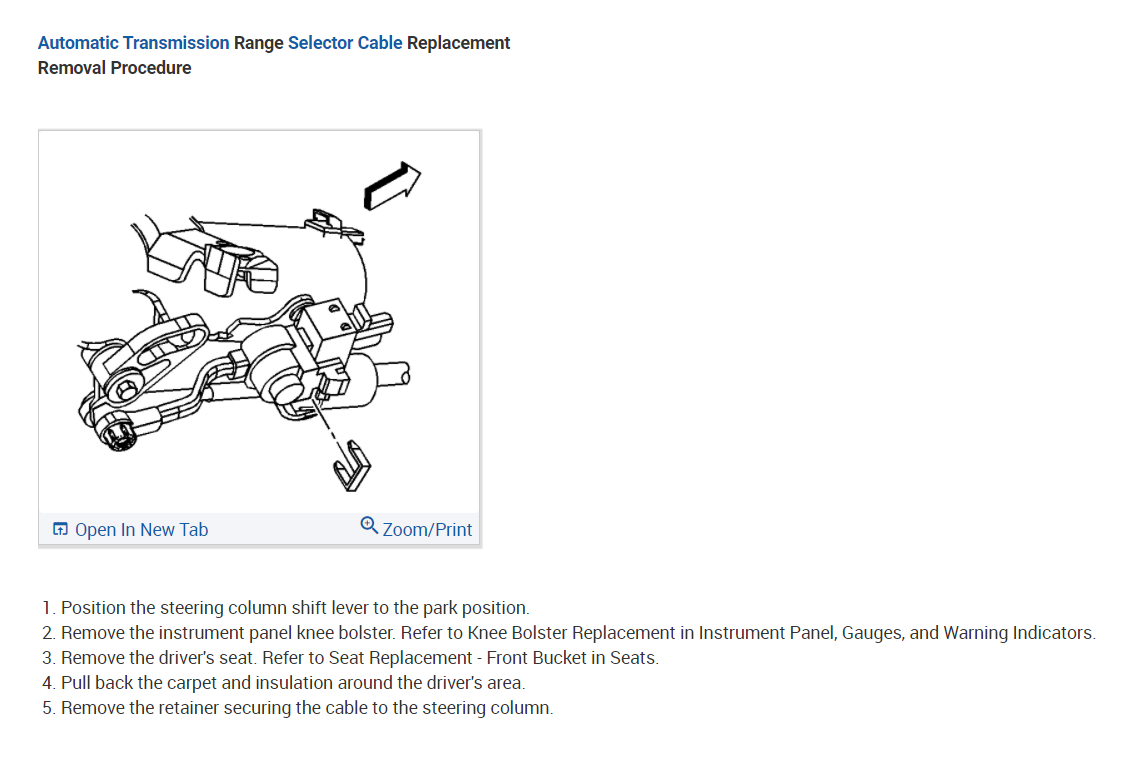

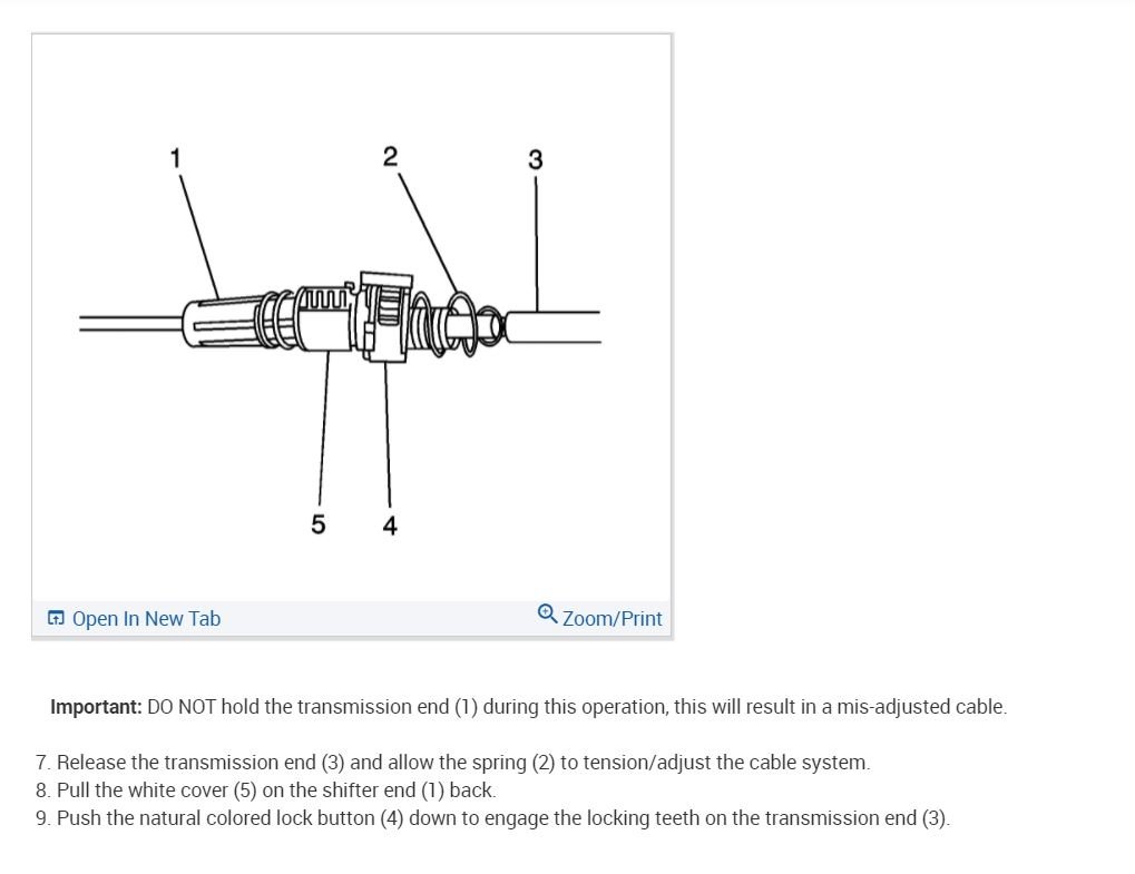

Okay, I attached the procedure for you for the shift cable. If it is locked up, it will not allow the transmission to go into park.

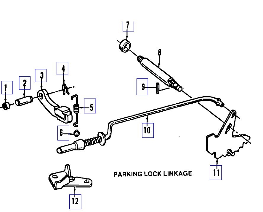

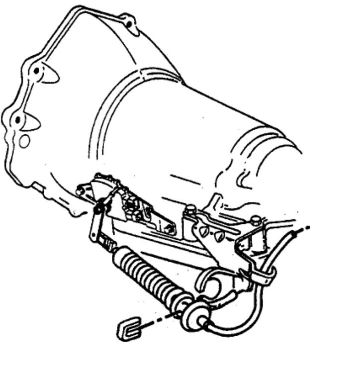

The Truck will not go into park. All the other gears work fine. I just can't get it to shift into park. I cant find how to adjust the linkage. I don't see anything blocking the ability to shift. The shifter goes all the way up in the column but the transmission or the linkage is preventing it from going into park.
May 6, 2021 at 12:18 PM (Merged)

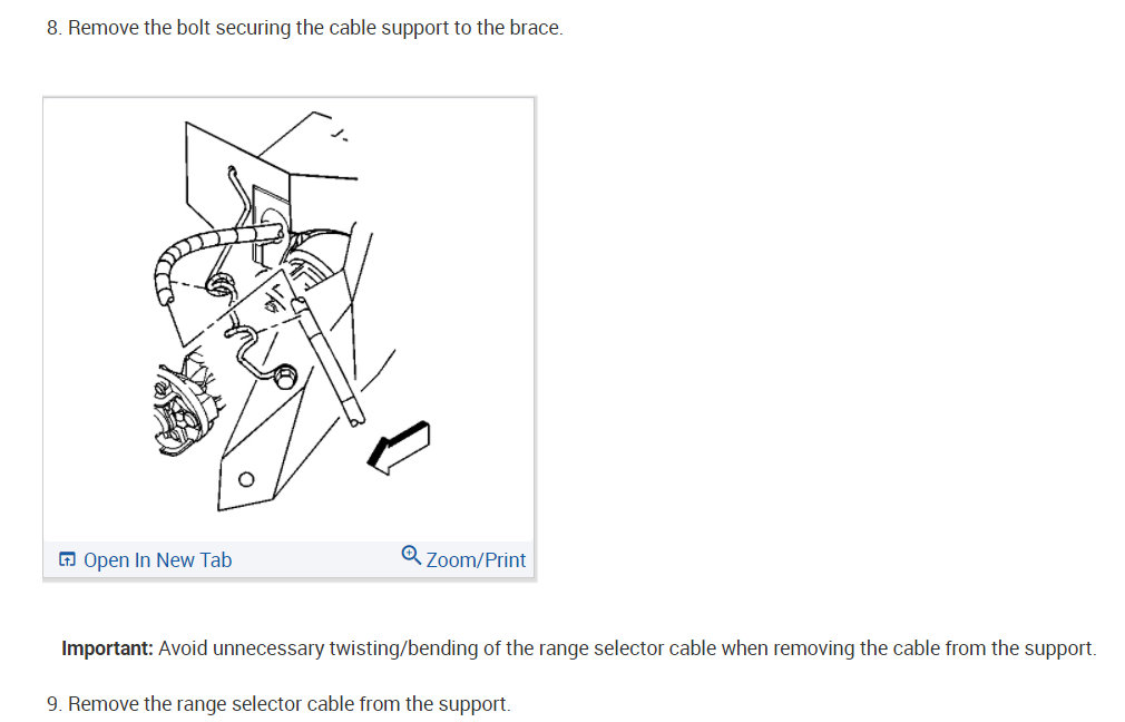

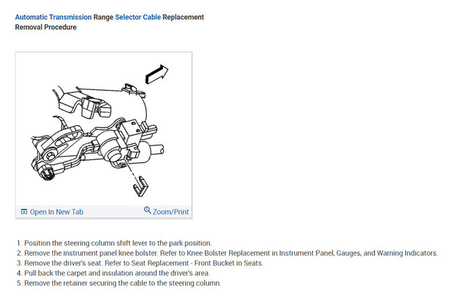

Remove the transmission shifting cable from the selector arm at the transmission and see if you can push the selector more, if you cannot then the parking mechanism (Pawl) inside the transmission is broken and needs to be replaced.
Here is a diagram for what to do

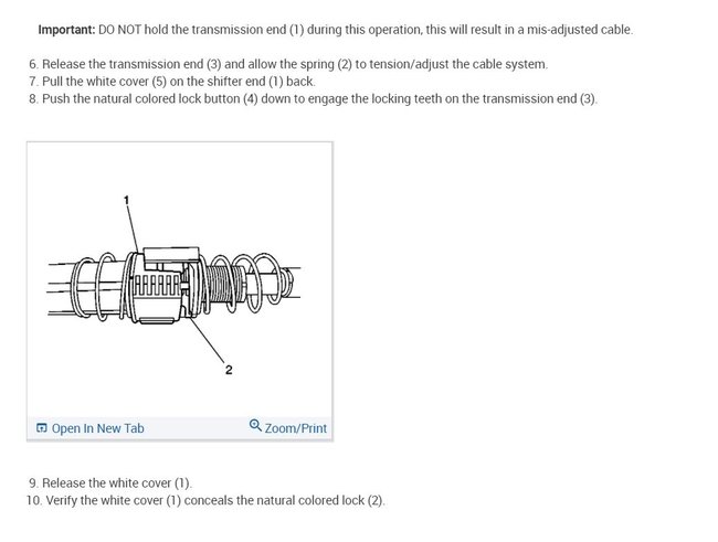

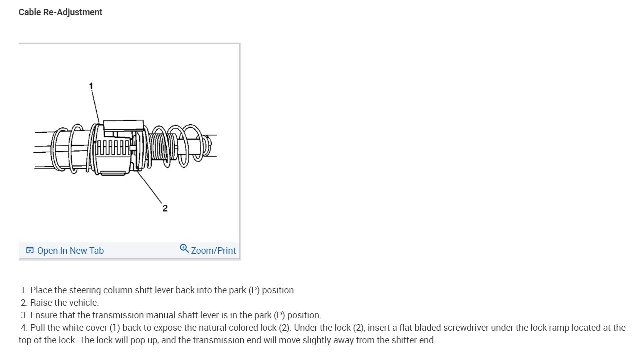

I’m having the exact same problem with my 2005 Chevrolet 2500, 6.0. I’m able to pop off the cable from the linkage and push it manually into park but then the cable can’t reach the linkage connector to put it back on until I move it back into the R position. Please help me it's drive nuts.
Jan 21, 2022 at 1:40 PM

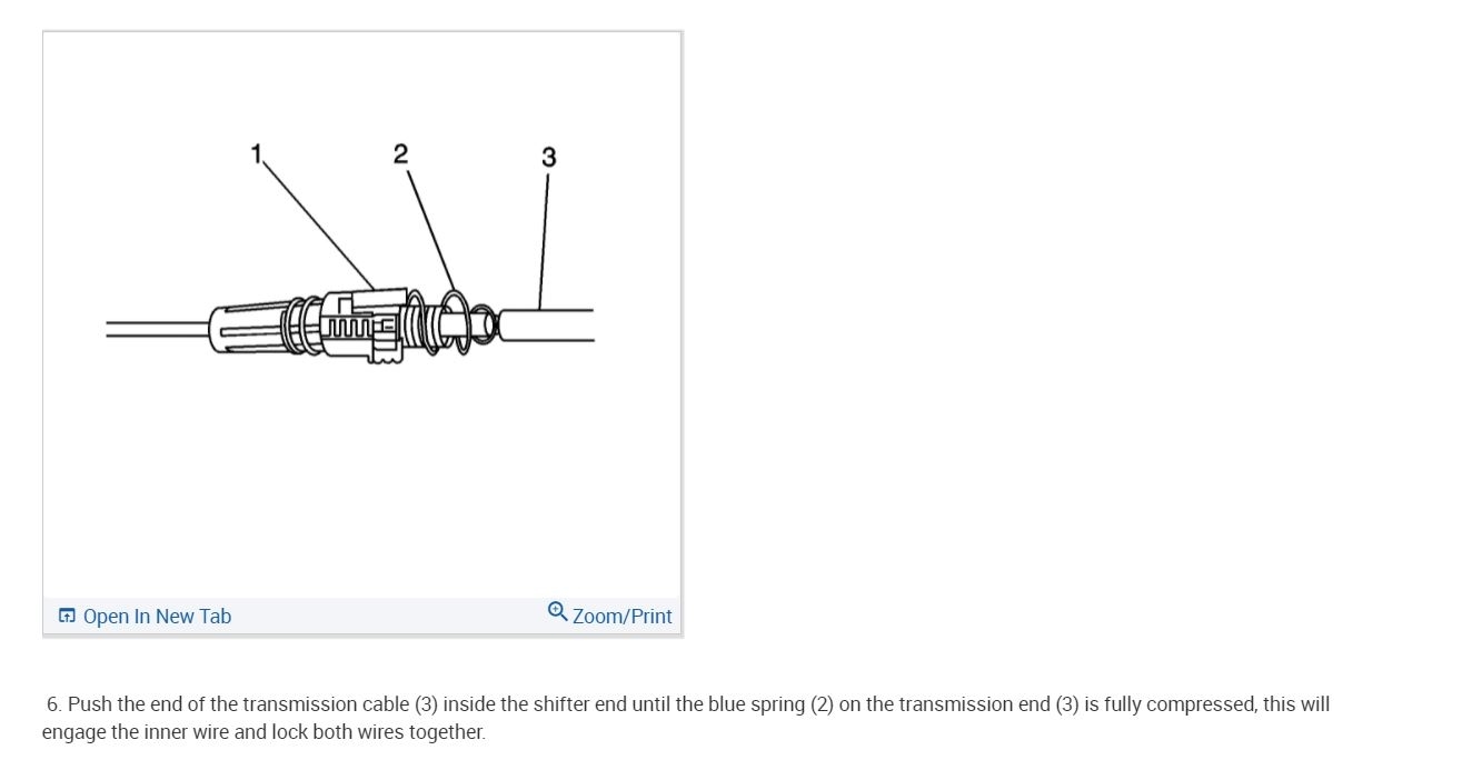

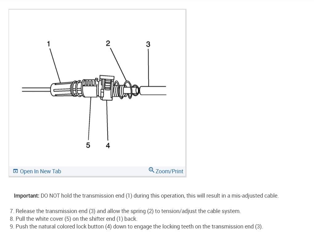

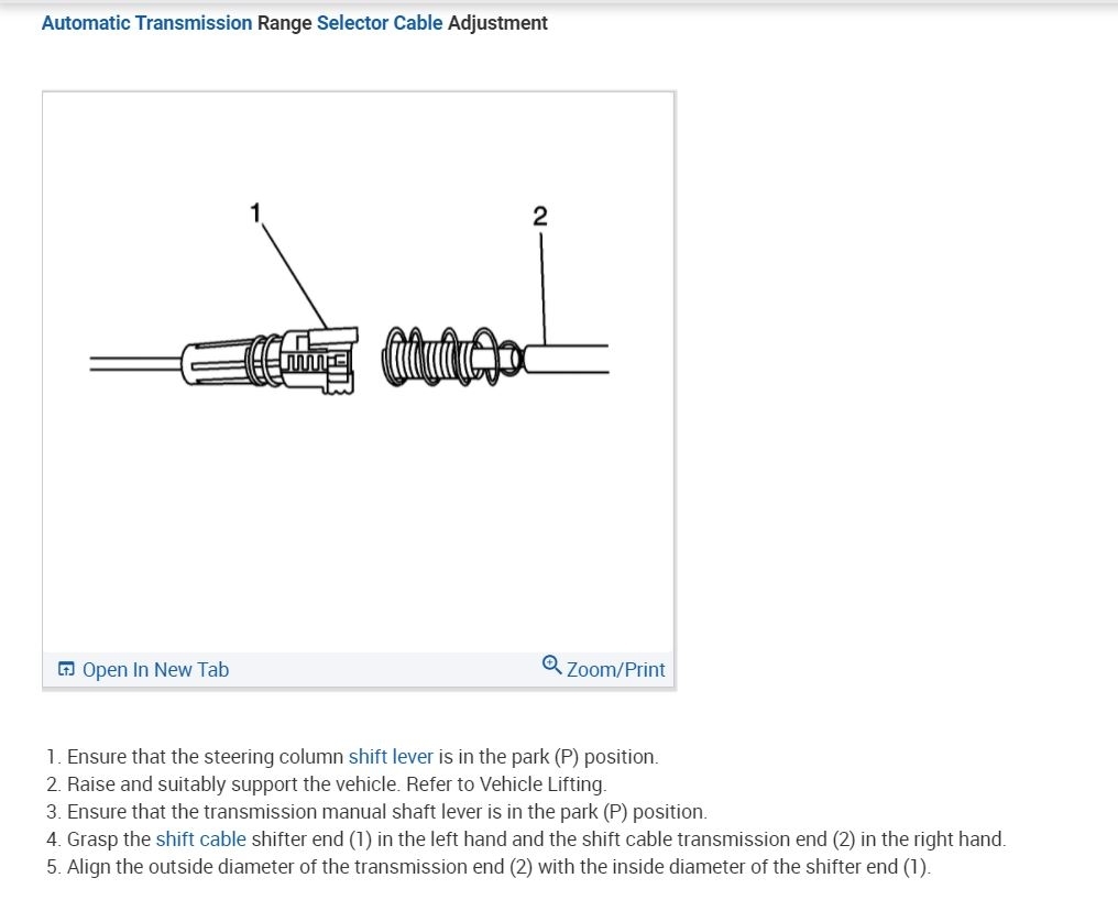

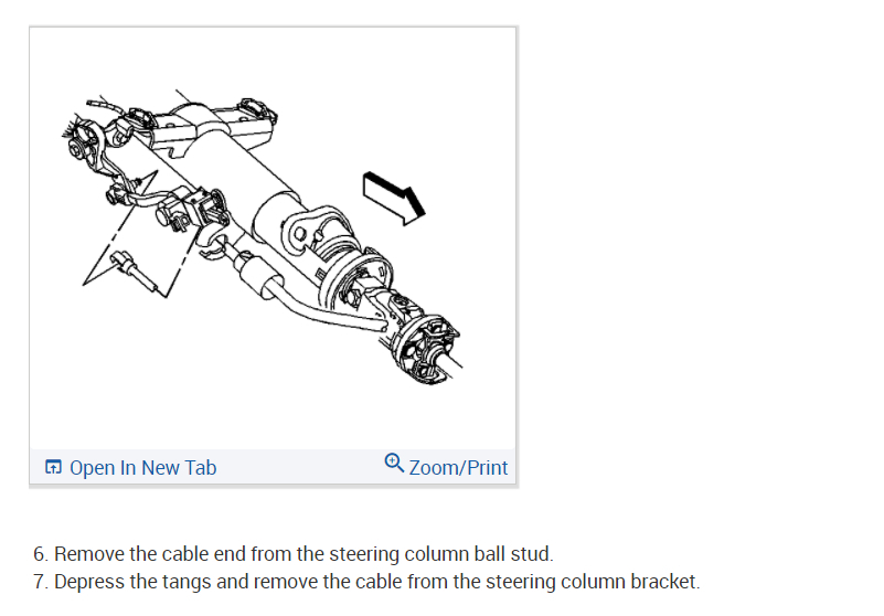

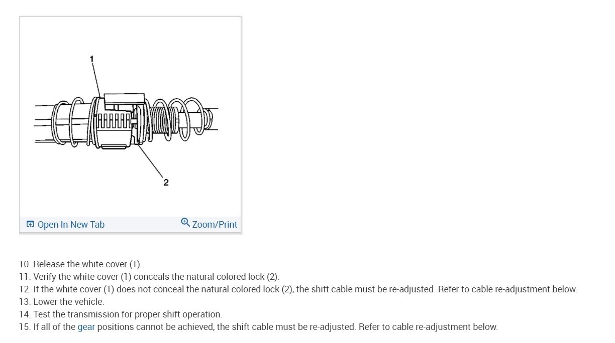

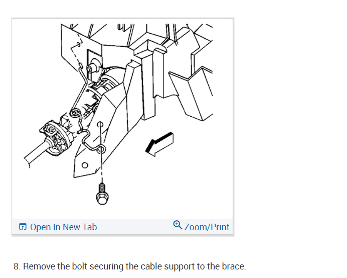

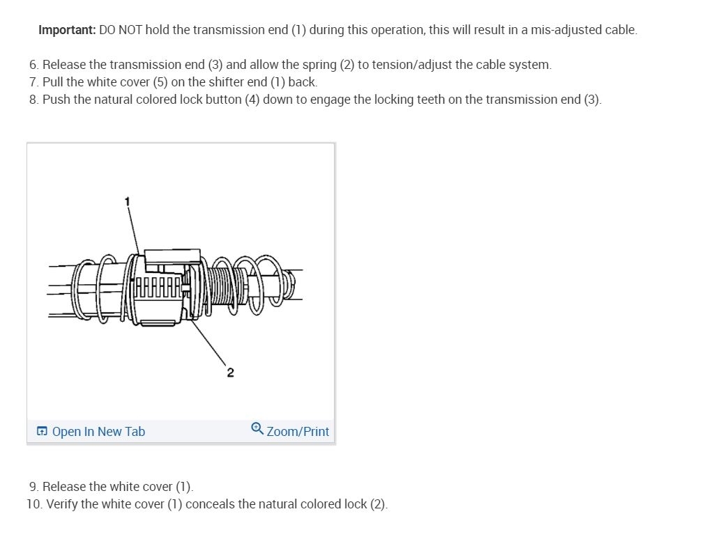

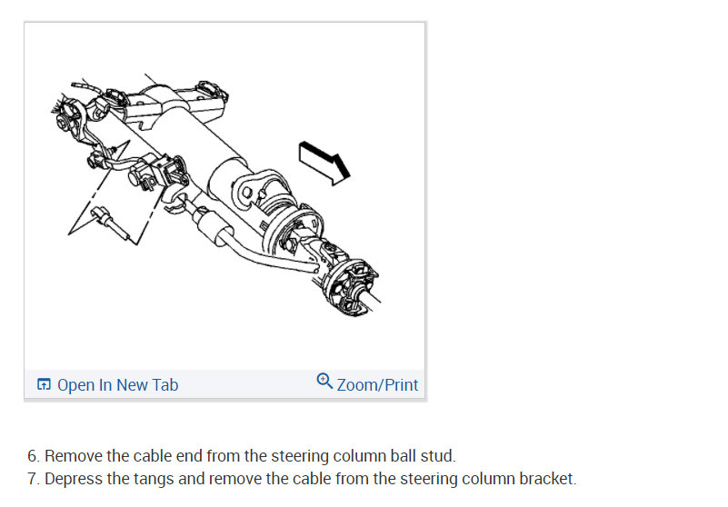

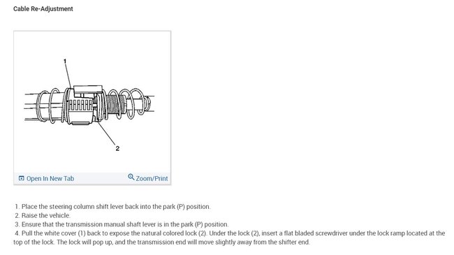

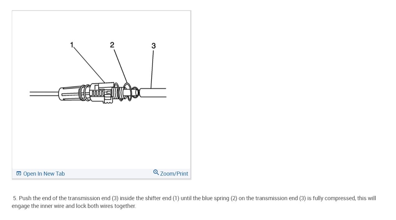

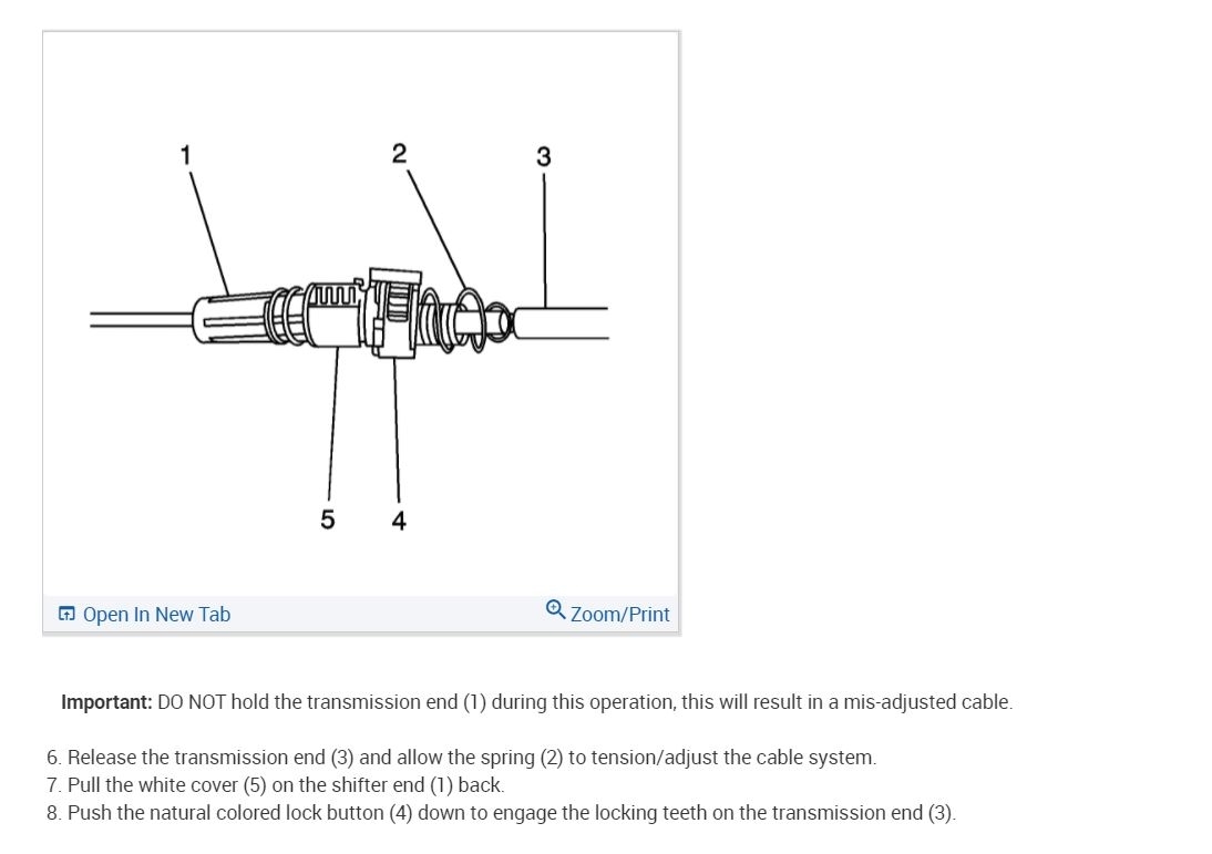

Good morning,
I attached the procedure for you for adjusting the cable.
Let me know if you have any other questions.
Jan 22, 2022 at 7:15 AM
