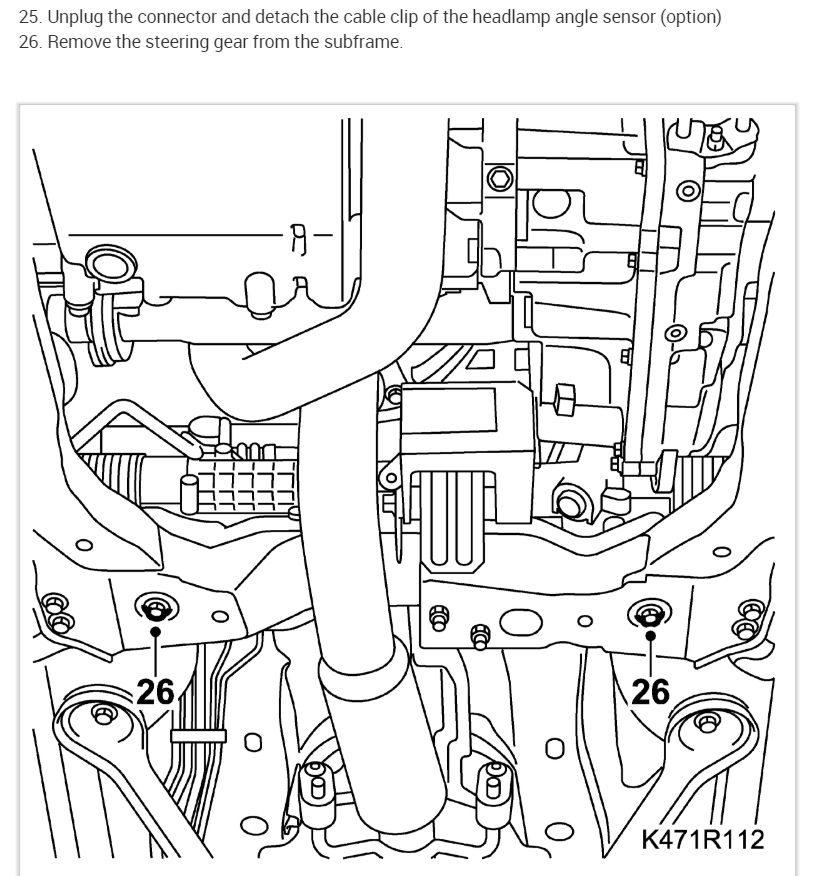

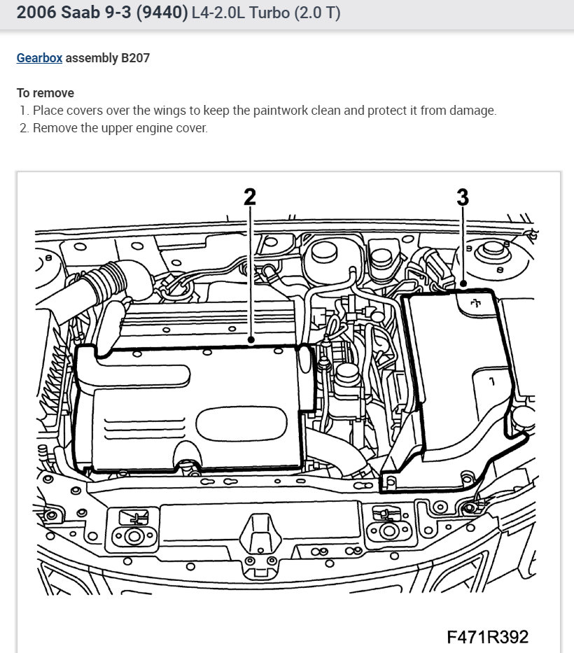

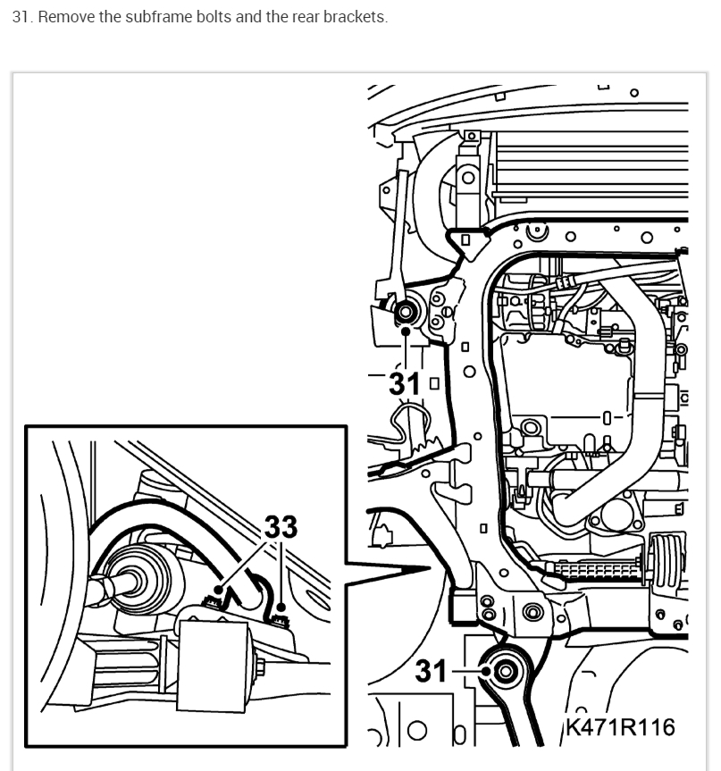

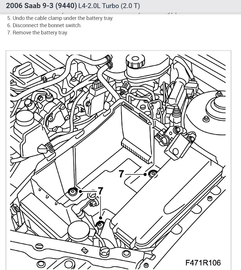

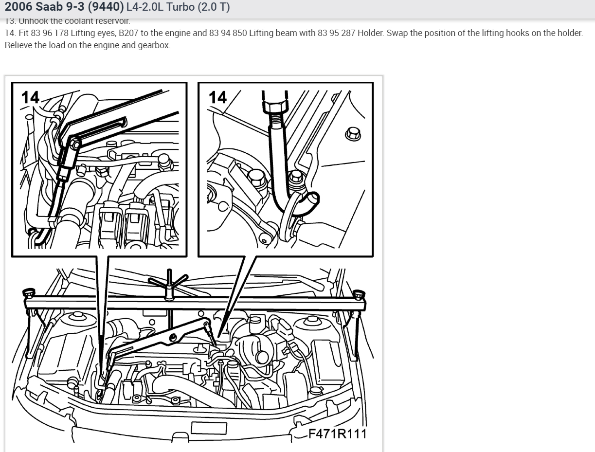

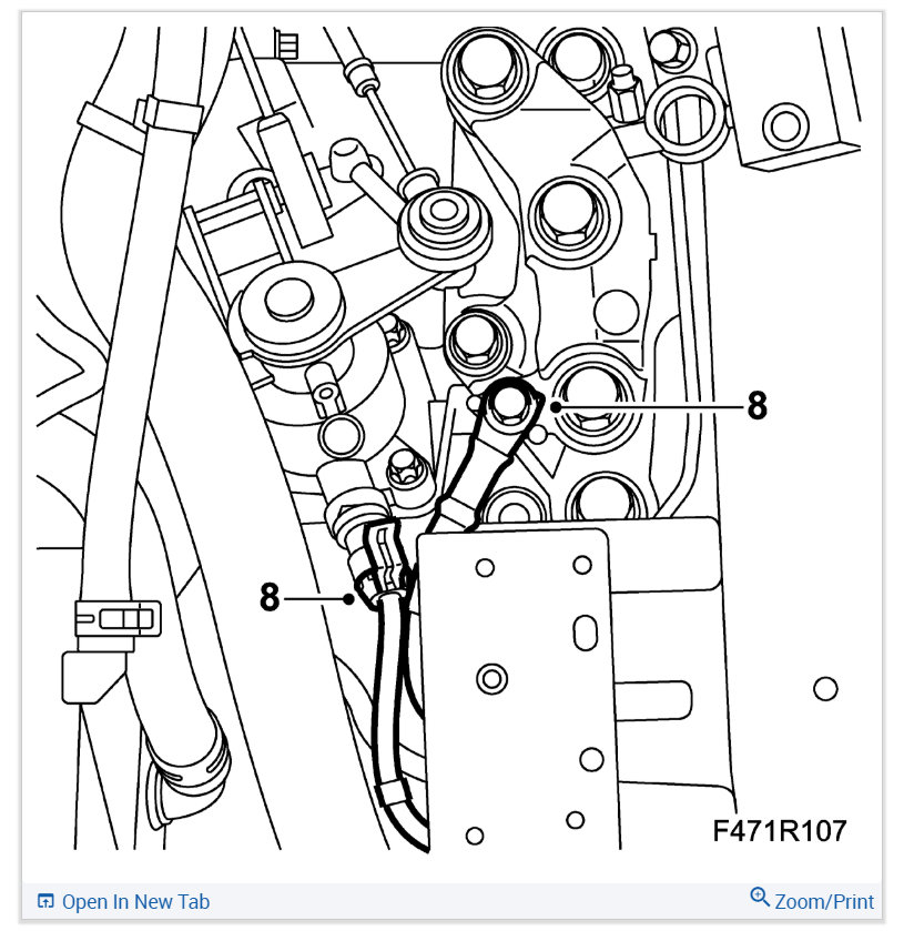

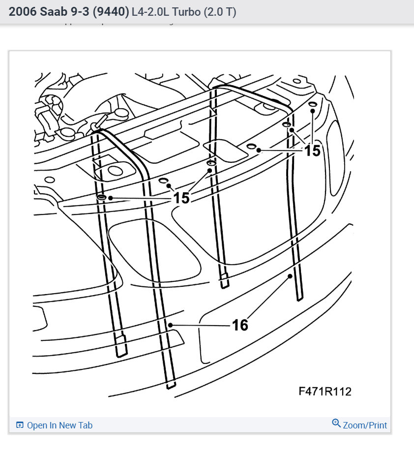

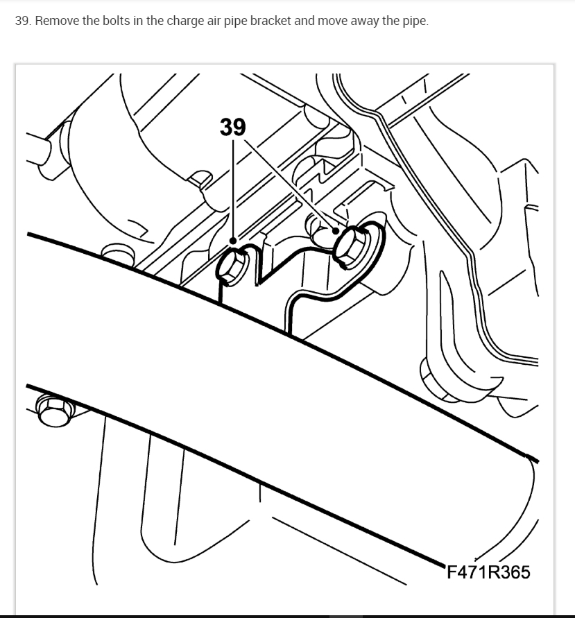

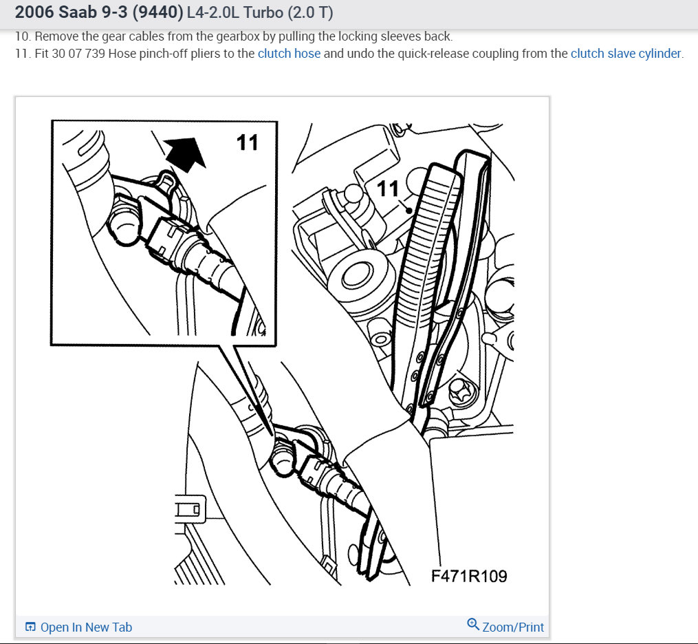

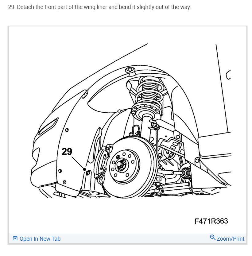

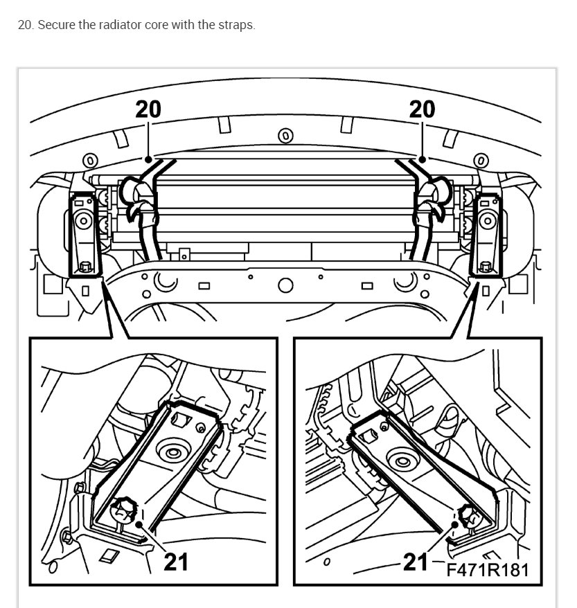

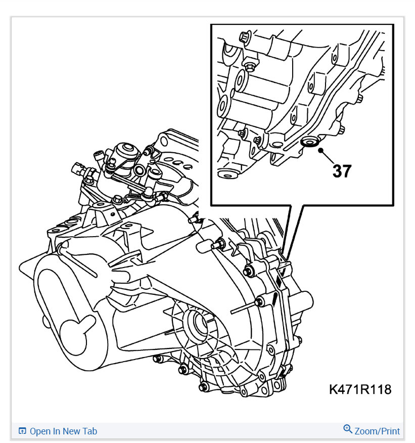

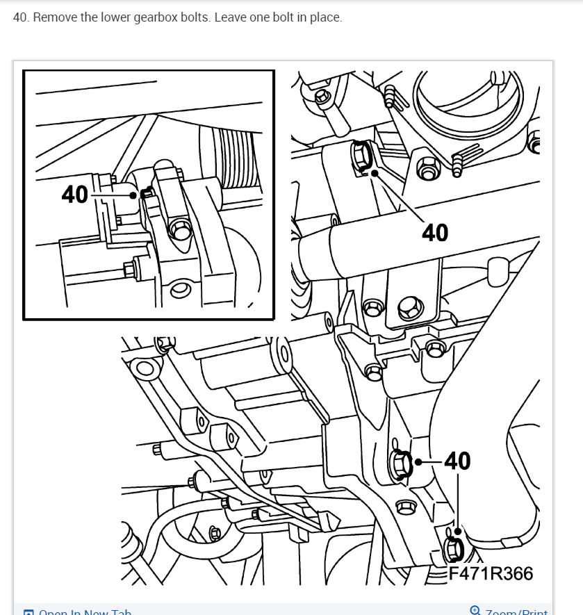

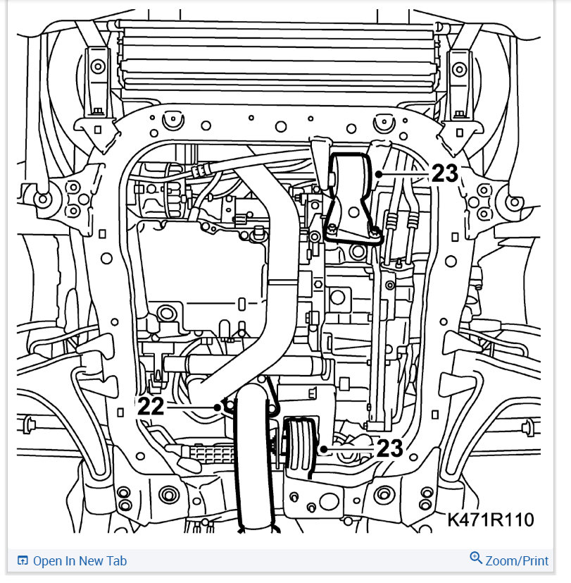

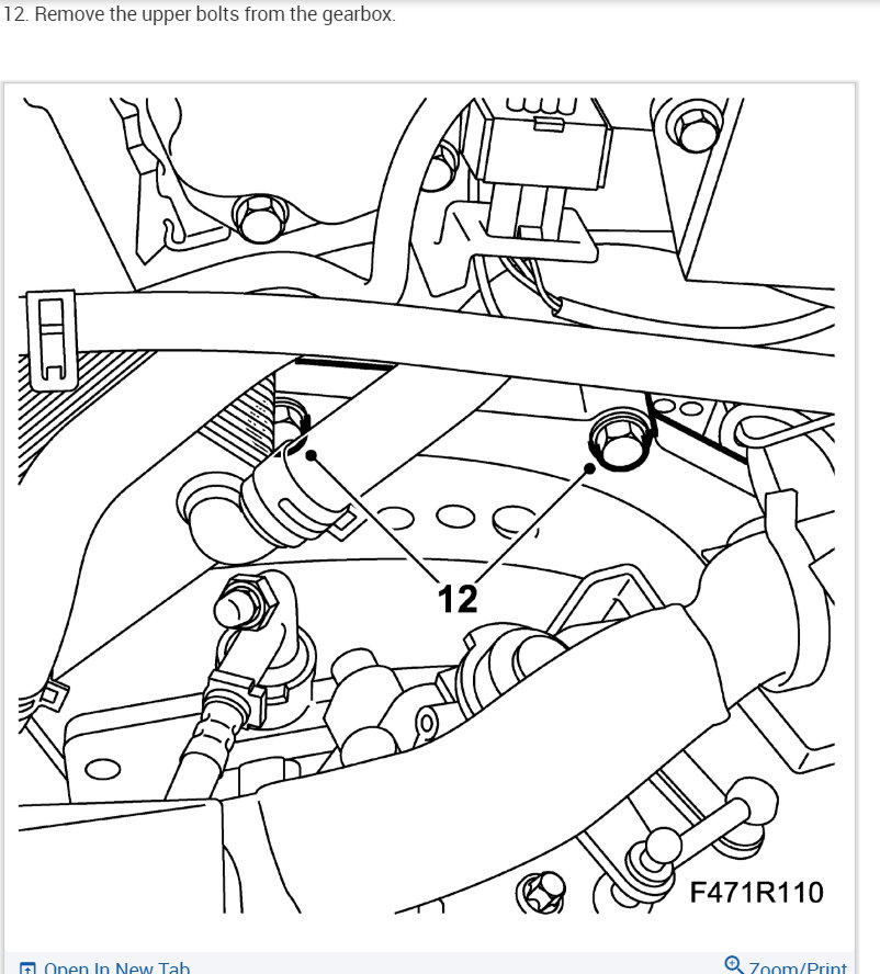

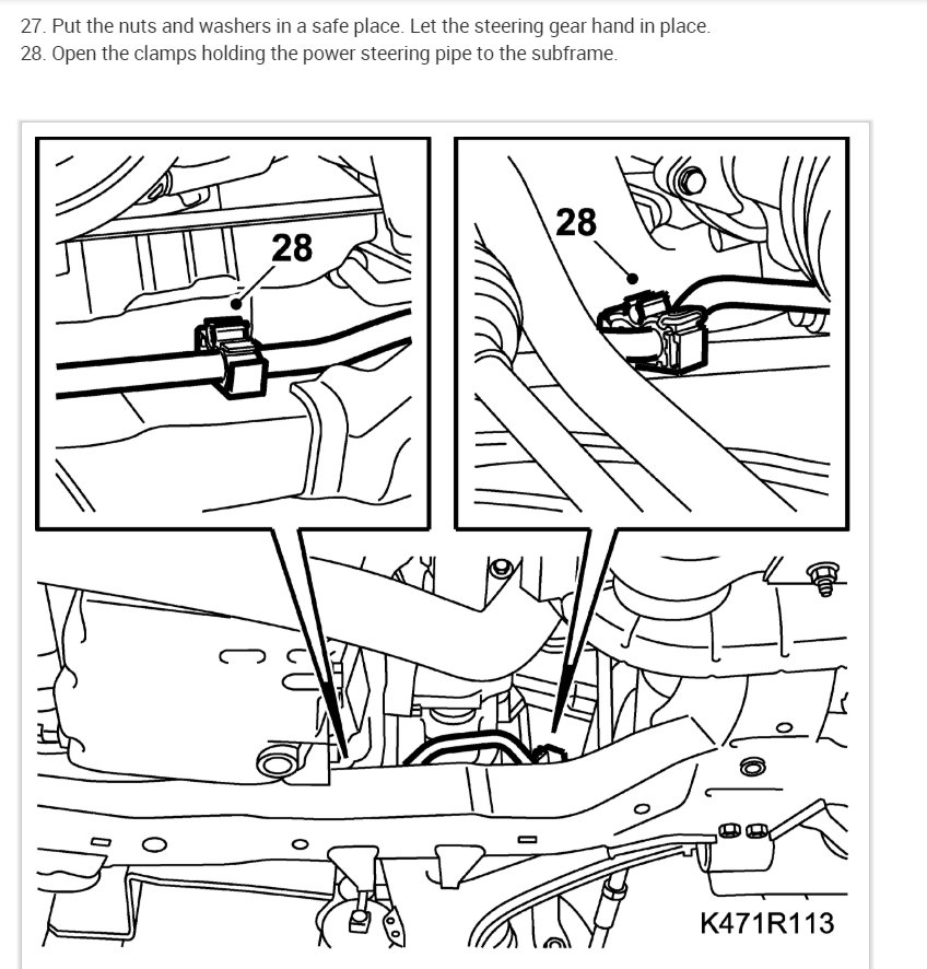

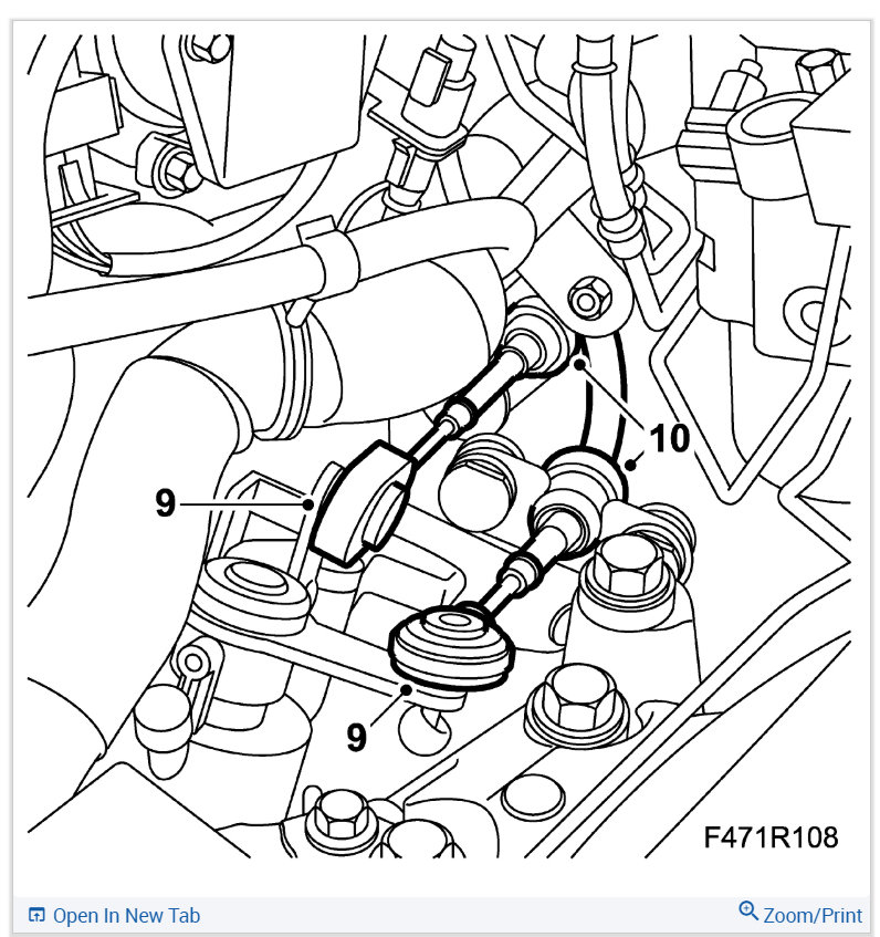

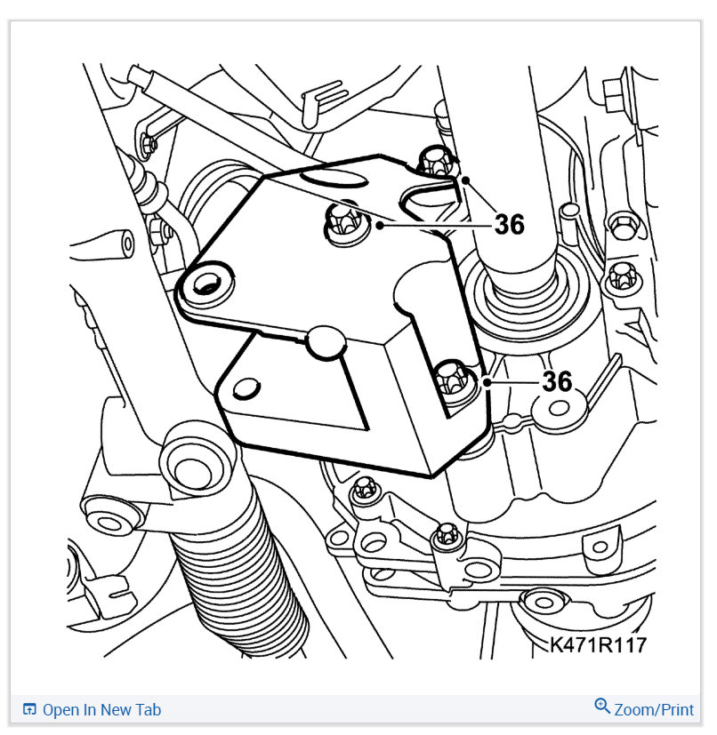

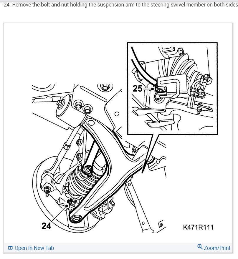

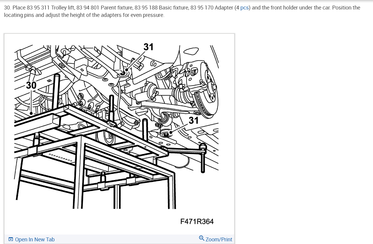

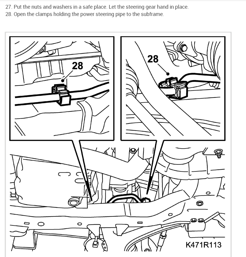

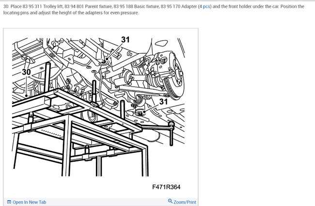

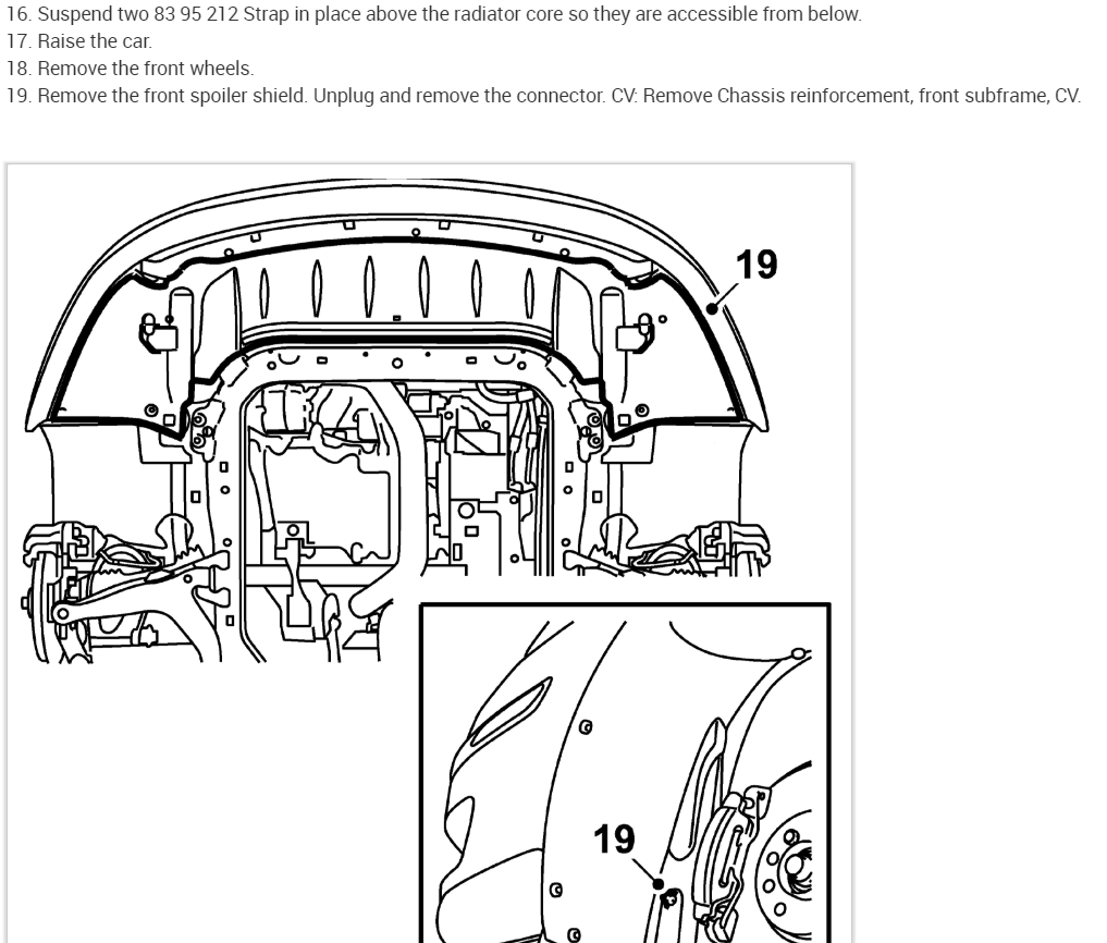

It sounds like you have a clutch disc that has fallen apart which will cause this issue. Here is a video showing what is involved in doing the job with diagrams below to show you what it will be like for your car below. The car is different but the procedure is the same.
https://youtu.be/6N6b5F2ChyE
Check out the diagrams (below). Please let us know what you find.
