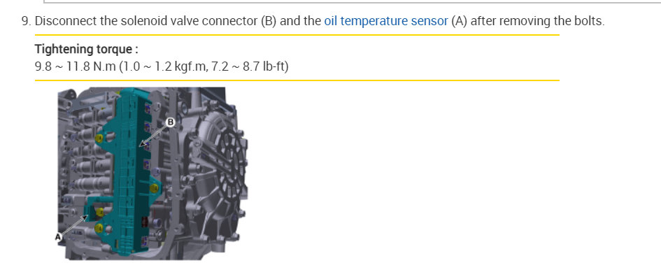

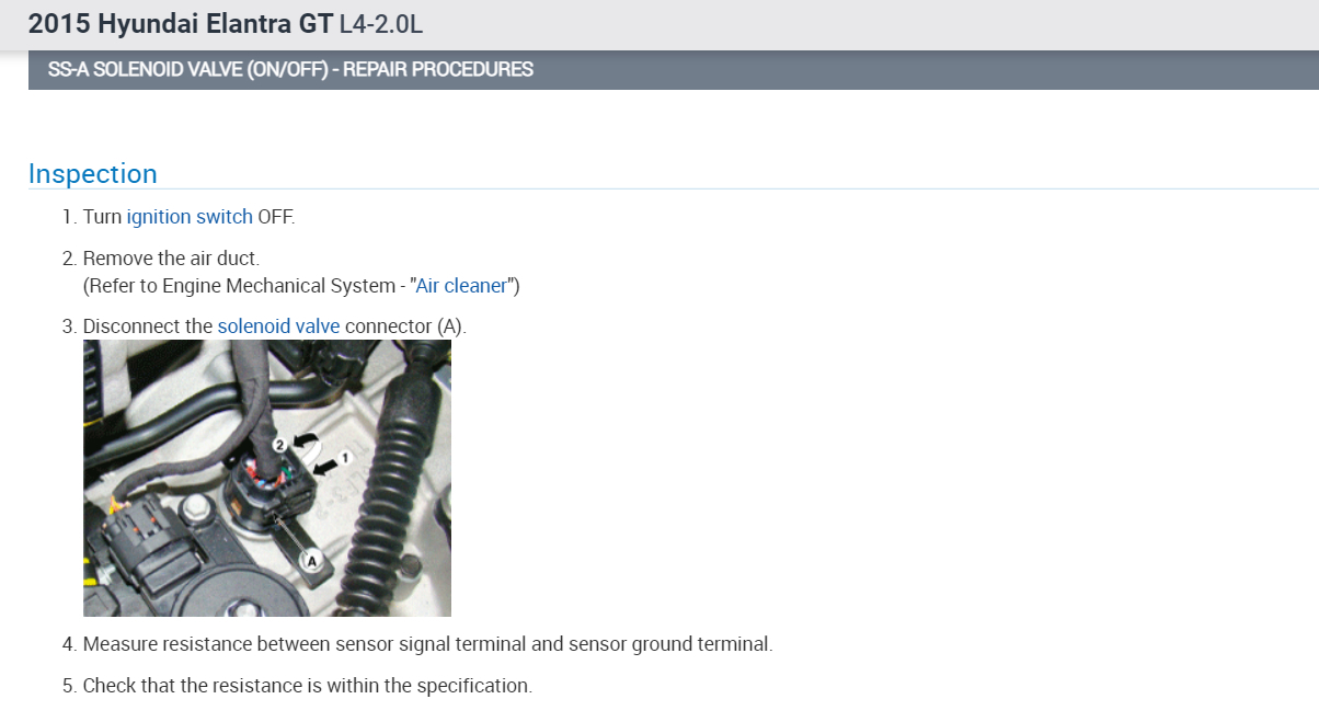

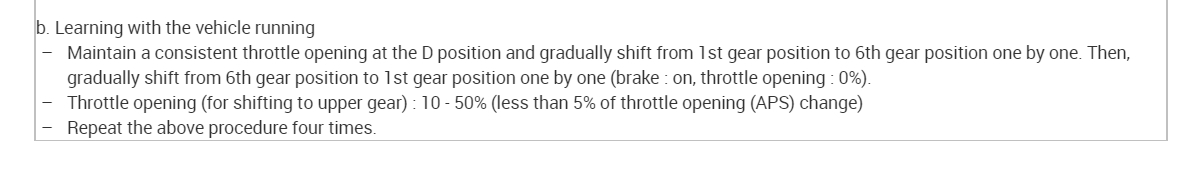

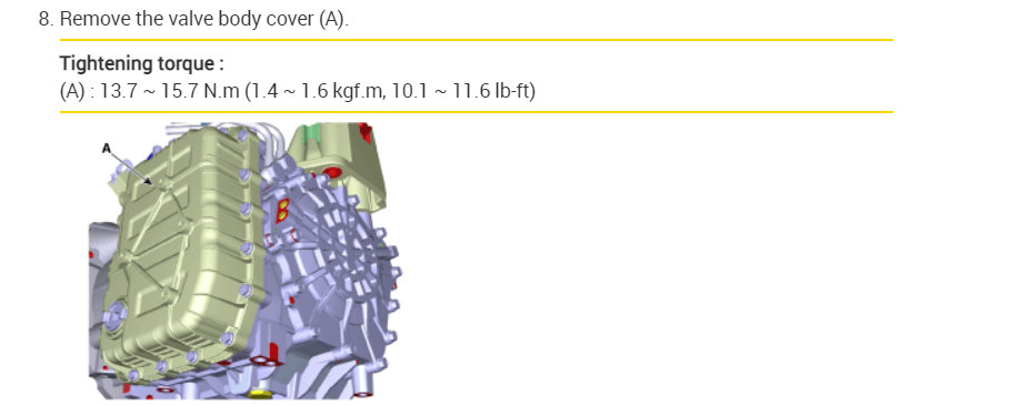

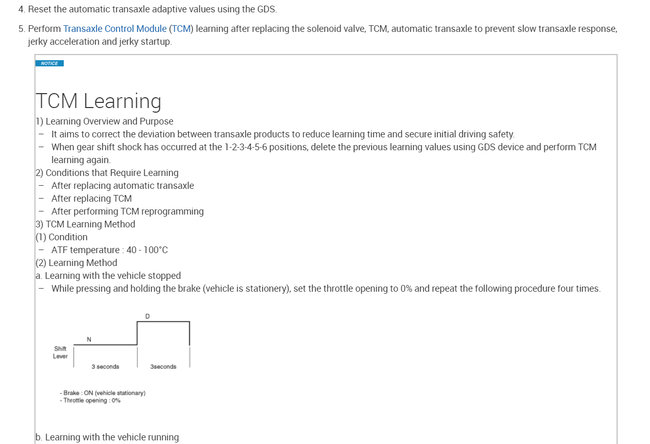

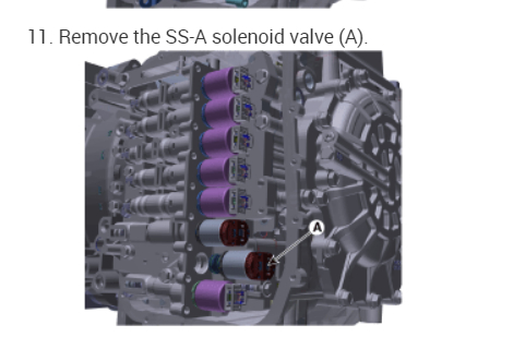

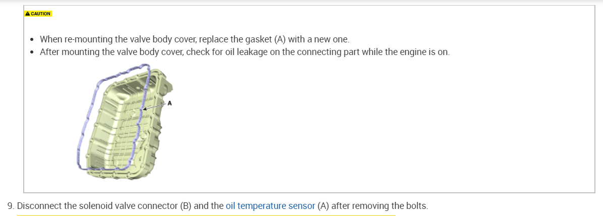

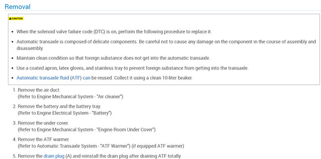

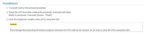

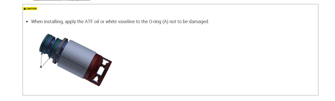

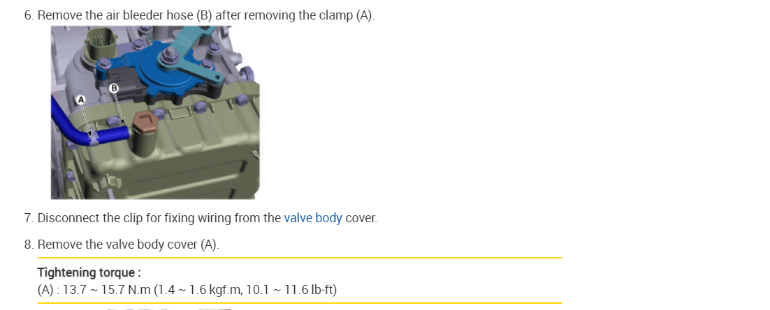

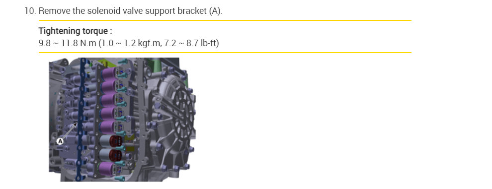

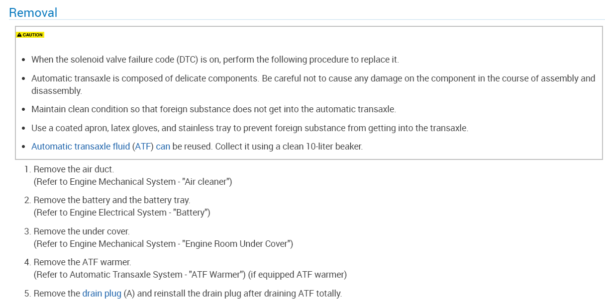

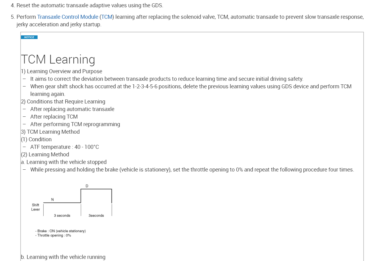

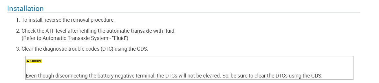

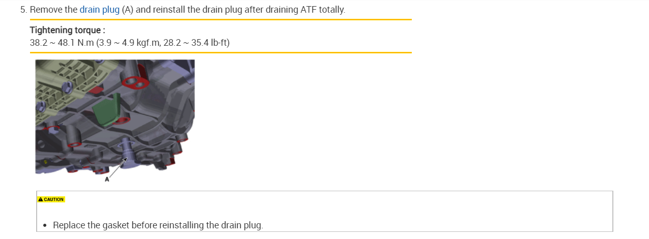

Can I ask if the speedometer is working? It sounds like you have a first gear shift solenoid that is not working. To be sure let's run the codes to see what comes up here is a guide to help and the instructions to change out the shift solenoid in the diagrams below.
