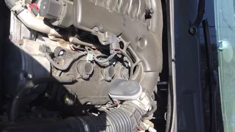

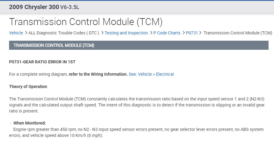

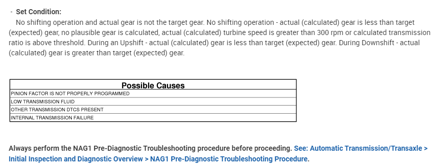

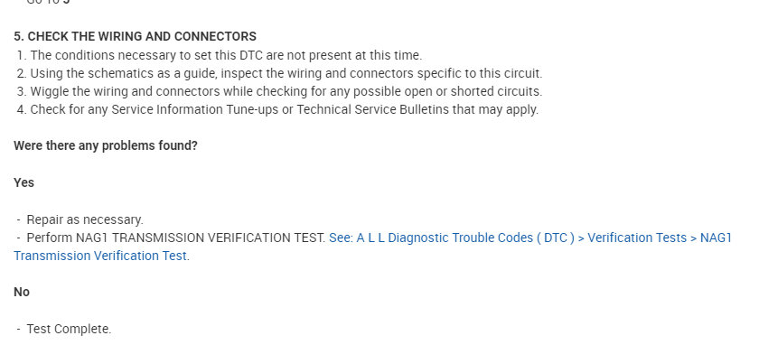

I was driving when all of a sudden, I hit the brakes because I came across a red light. The minute I hit the brakes the light went green; I kept on accelerating. When I kept accelerating a loud sound and the car stopped going forward. I immediately pulled over to turn off my car, turned it back on and it started making this weird sound, it sounds like it’s coming from the motor the serpentine belt around there. It won’t drive but my car will reverse. no overheating no nothing no check engine light to later on the check engine light came on with code p0731.
