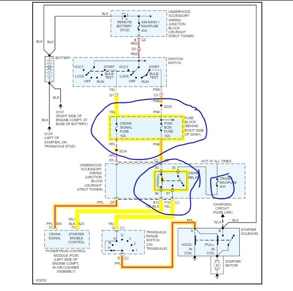

Good afternoon,
You will need a test light or voltmeter to do some checks.
I attached a diagram of the starting system and need to verify some powers.
