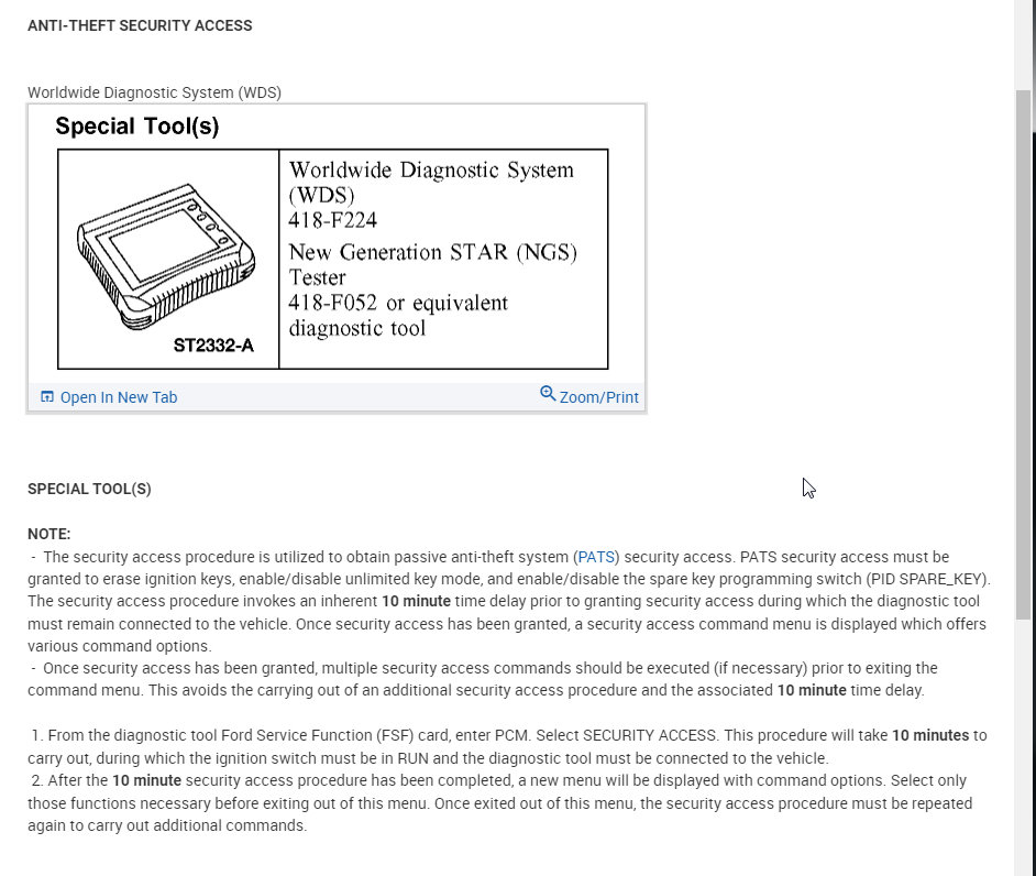

I was in the process of checking fuses and bumped into to lock button and end up shutting the door and locked the keys in the truck. so I used a slim Jim to get in and it's no longer starting as in it has no power to the ignition at all, but it did before all of this happened. I checked the starter, fuses,relays, battery, but everything tested good. the engine light is on but was also on when it was starting. I haven't put a scanner on it yet. Also the anti theft light does blink.
