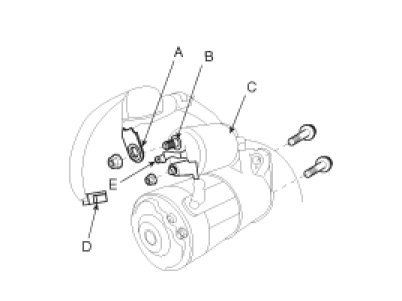

1. Disconnect the battery negative cable.
2. Disconnect the starter cable (A) from the B terminal (B) on the solenoid (C), then disconnect the connector (D) from the S terminal (E).
pic 1

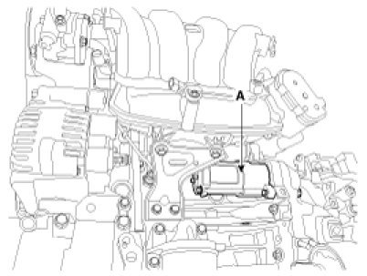

3. Remove the 2 bolts holding the starter, then remove the starter (A).
pic 2
