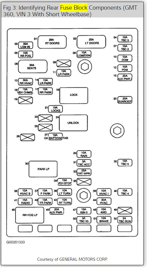

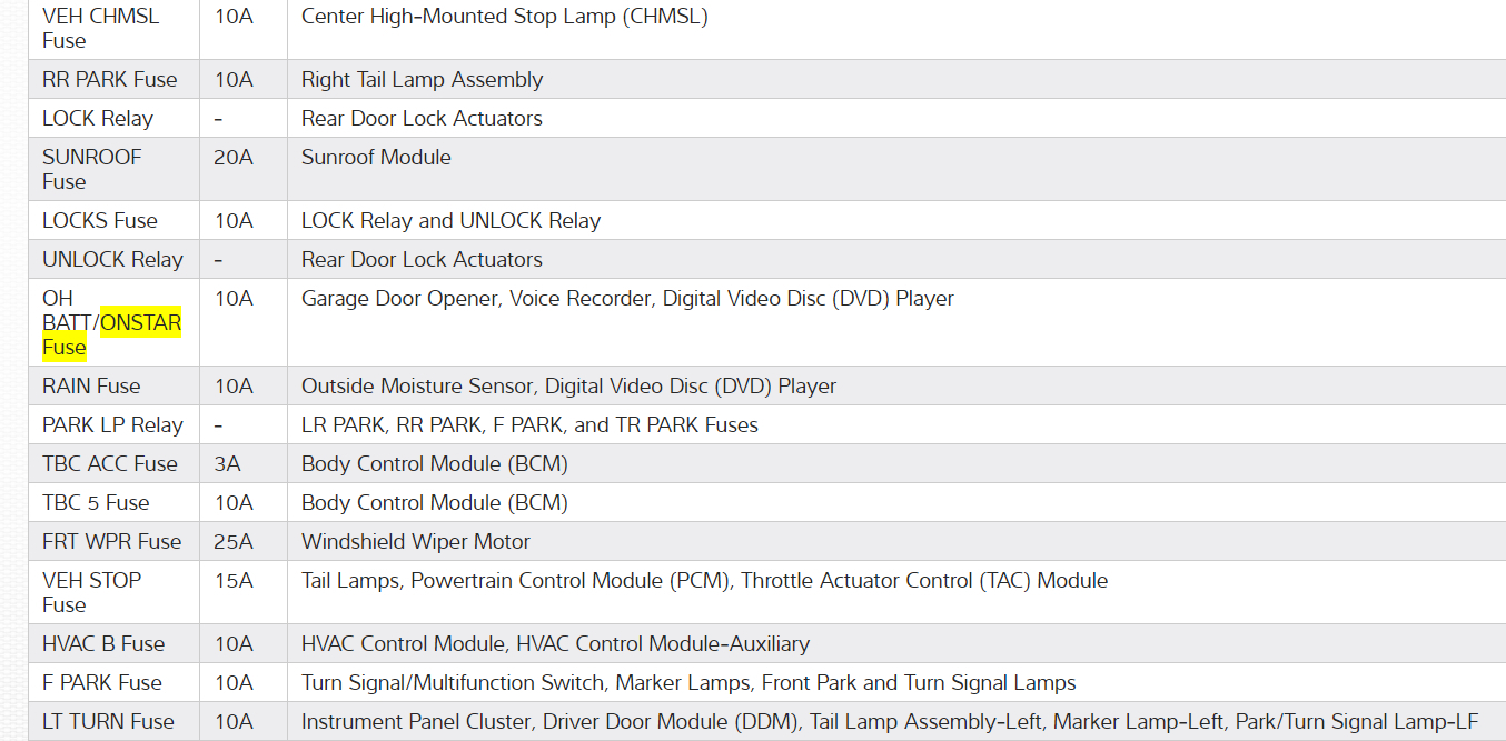

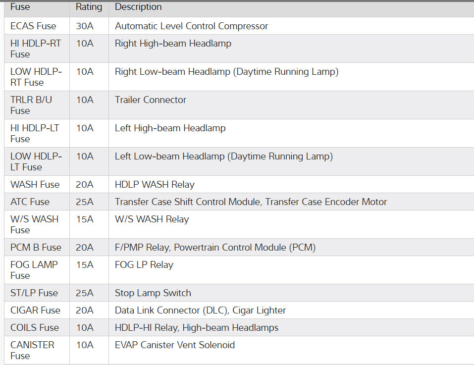

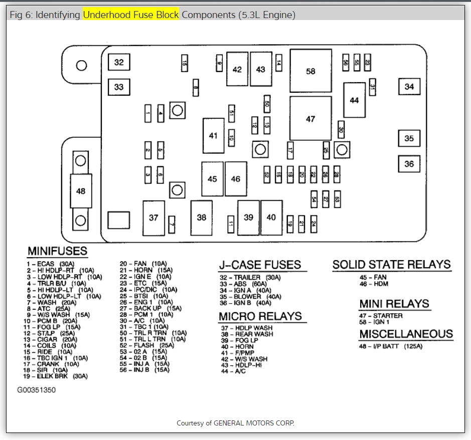

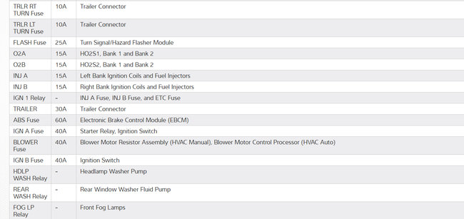

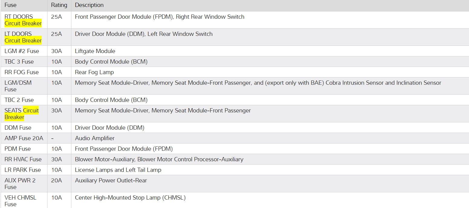

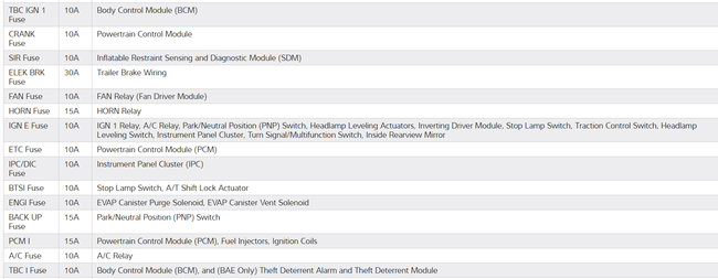

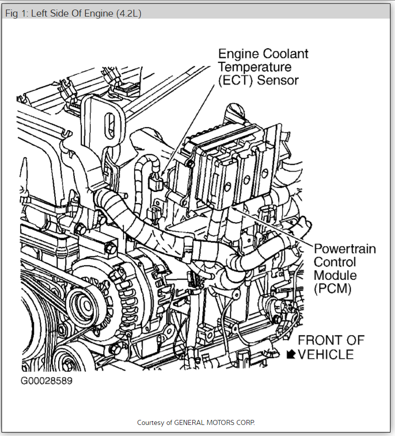

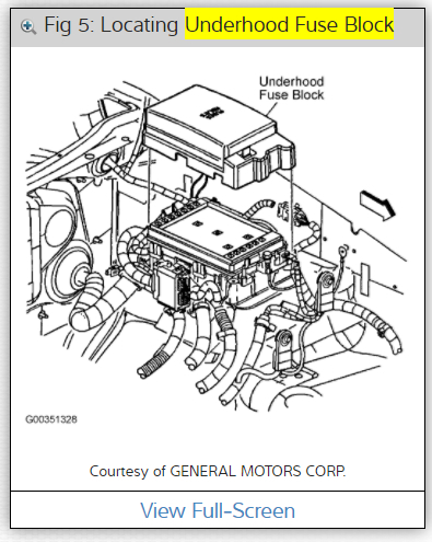

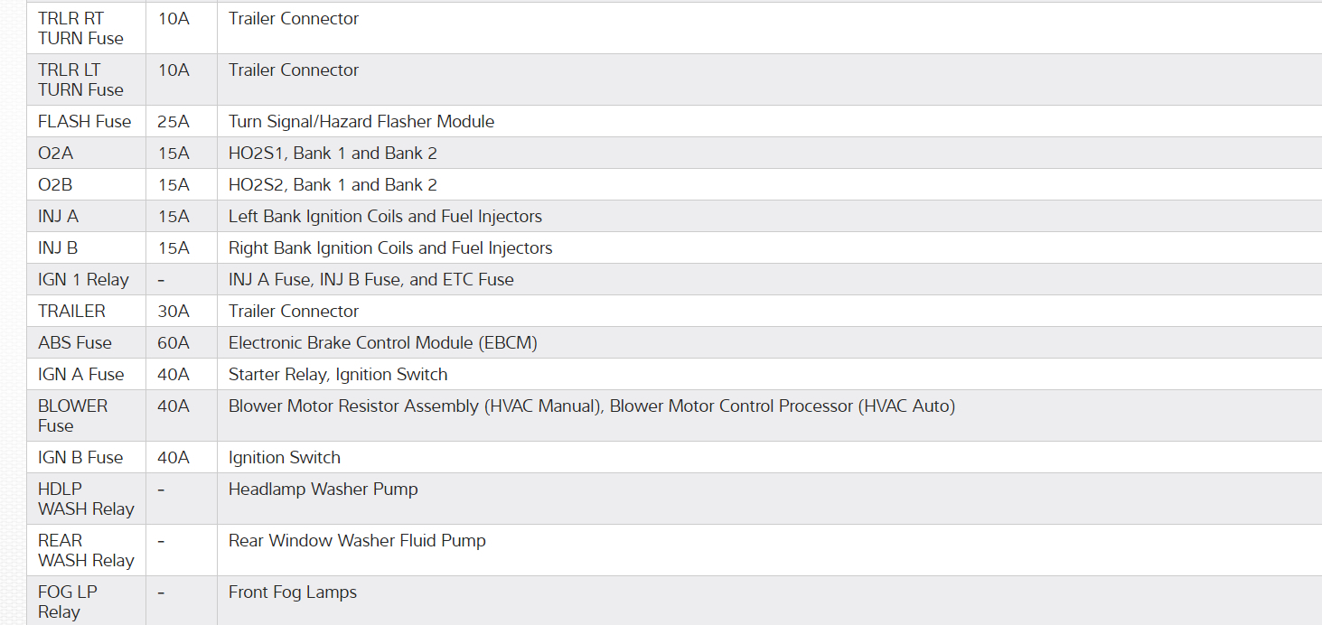

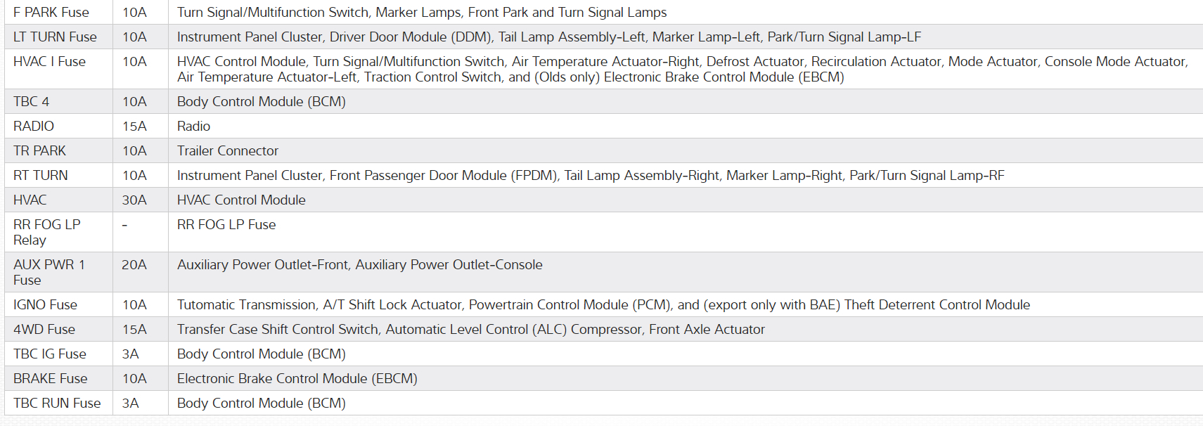

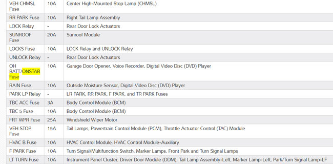

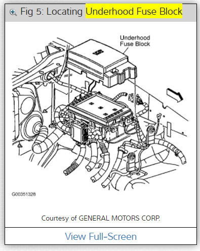

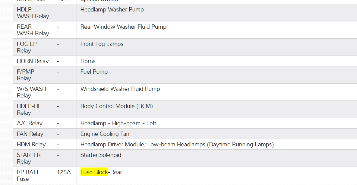

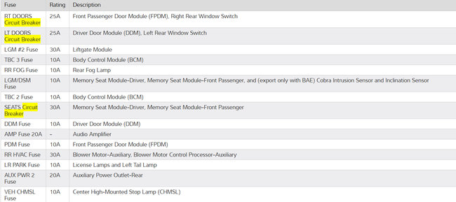

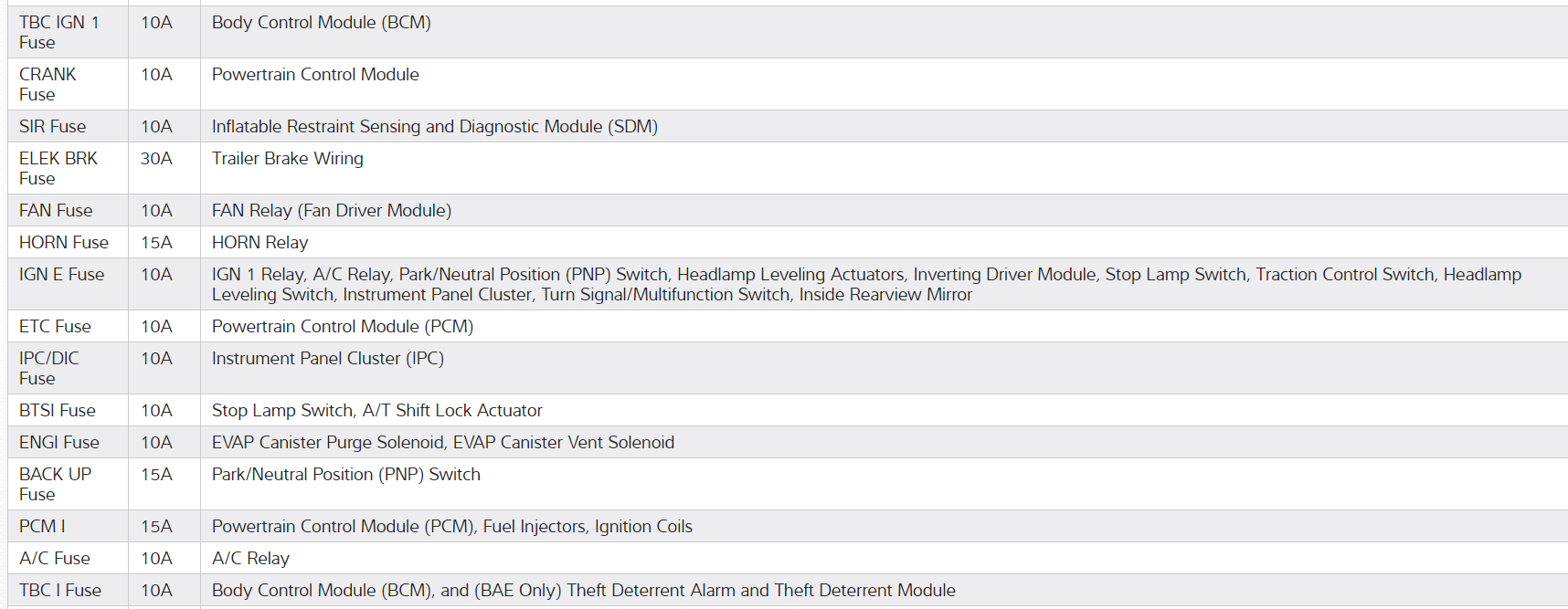

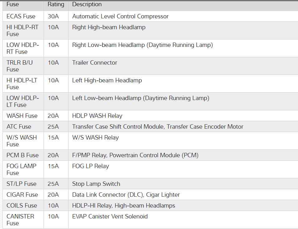

It sounds like you lost the PCM but to be sure lets check the system fuses.
Here are the fuse locations.
If everything checks out would would try a used PCM plug it in see what happens.

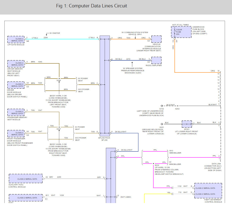

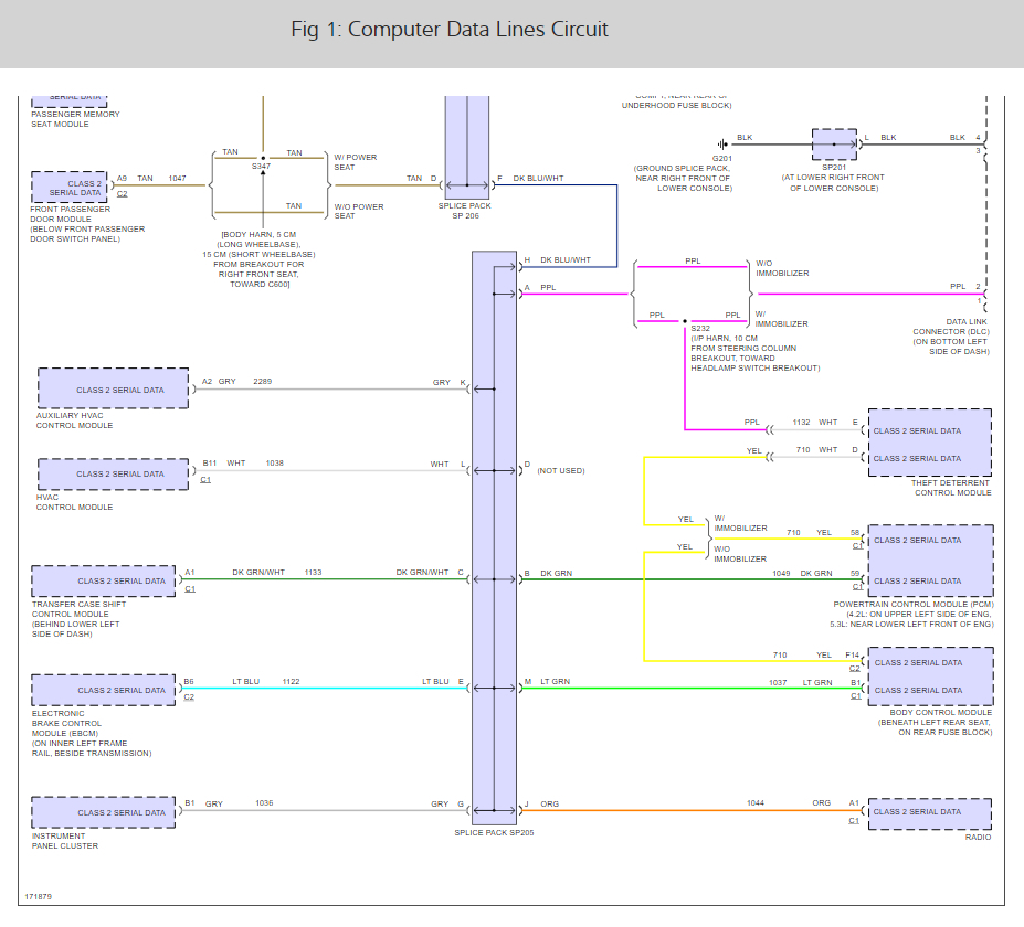

The link error seems strange. here is a wiring diagrams and power fuse for the connector please check the wiring power and ground connections:
ALDL connector wiring diagram is below.
Check out the diagrams (below)
