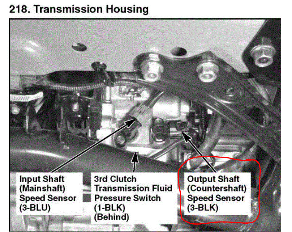

Chances are the vehicle output speed sensor has failed. The sensor is on the side of the transmission. If you look at pic 1, it shows location.
First, make sure the connector hasn't been damaged or has come loose. If it appears okay, without testing further, that is my first suspect.
By the way, what code was found because that can all tie together.

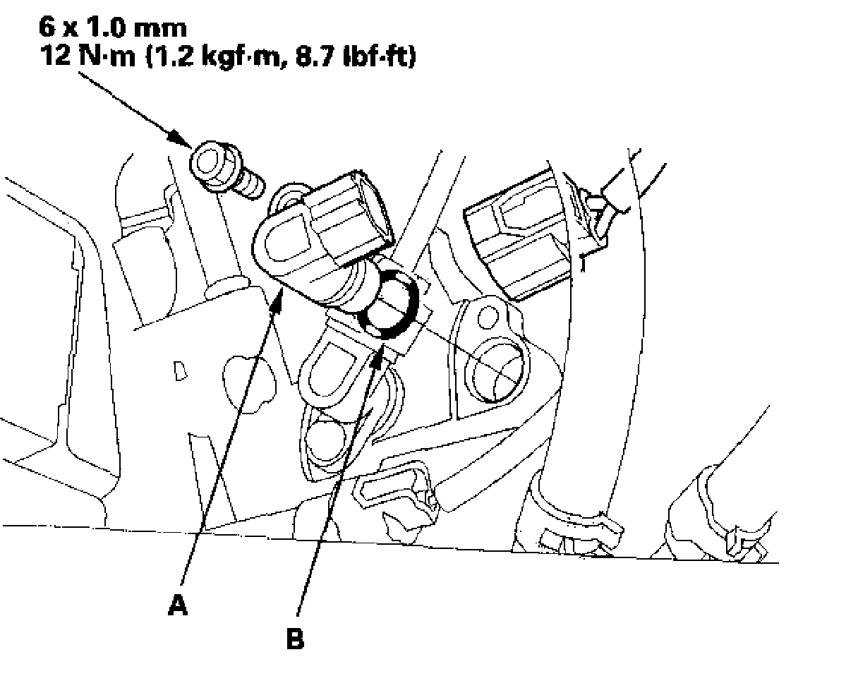

Here are directions for replacing the sensor. Pic 2 correlates with these directions. Please let me know what code was found for the ABS before you replace the sensor.

OUTPUT SHAFT (COUNTERSHAFT) SPEED SENSOR REPLACEMENT
Output Shaft (countershaft) Speed Sensor Replacement
1. Remove the splash shield.
pic 2
2. Disconnect the output shaft (countershaft) speed sensor connector, and remove the output shaft (countershaft) speed sensor (A).
3. Install the new O-ring (B) on the new output shaft (countershaft) speed sensor and apply clean ATF to the O-ring, then install the output shaft (countershaft) speed sensor in the transmission housing.
4. Check the connector for rust, dirt, or oil, then, Connect the connector securely.
5. Install the splash shield.

Move the wiring around on the sensors you replaced. Chances are there is a bad connection or a broken wire. When you installed the new sensors, it was likely making connection.

Yes, if you wiggle them around at the sensors and it starts working again, we know it is a wire near the sensor. Also, you can remove the plug on the sensors and inspect them as well. Make sure there are no pins pushed in or corrosion. Plus, make sure they are clipping together tightly.
Let me know what you find.
