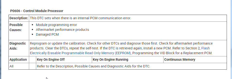

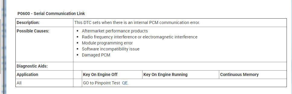

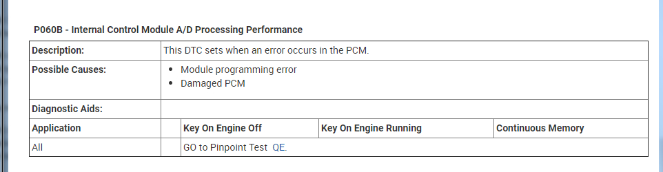

If so, that is going to be the cause of the P0606, P0600, P060B.

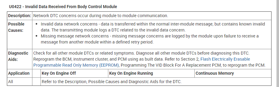

The U0422 is just saying that there is communication issues which would be the case since it appears the PCM cannot communicate or is damaged.

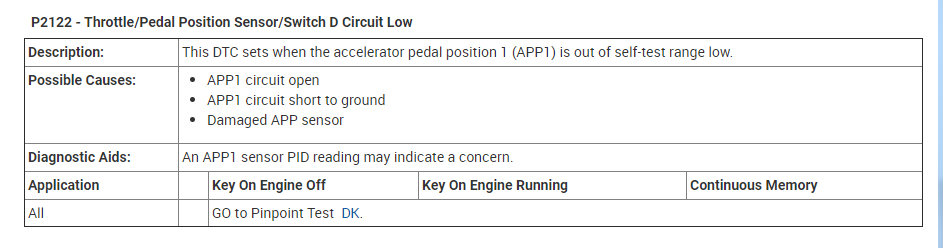

Also, the P2122 is for the accelerator pedal position sensor as I suspected.
