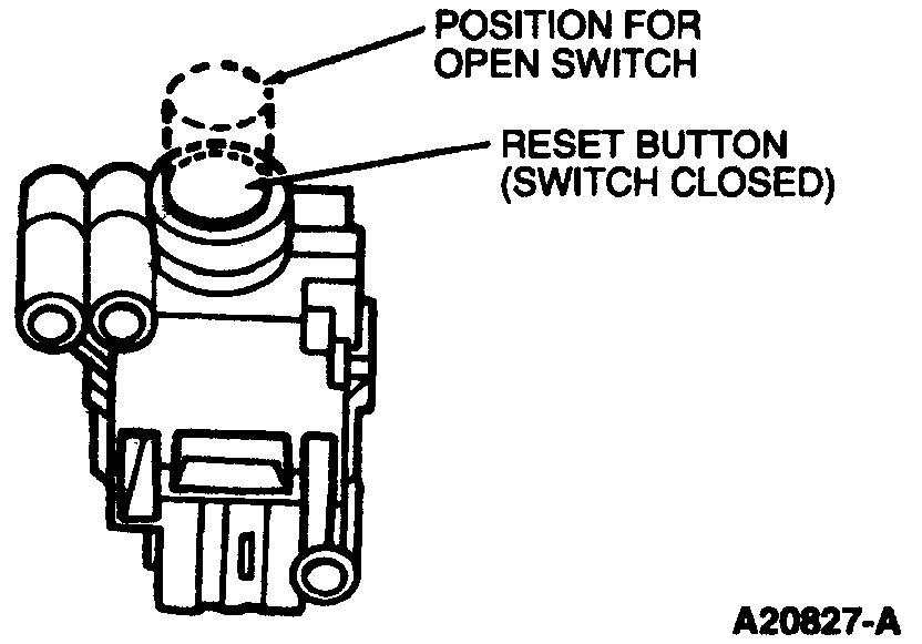

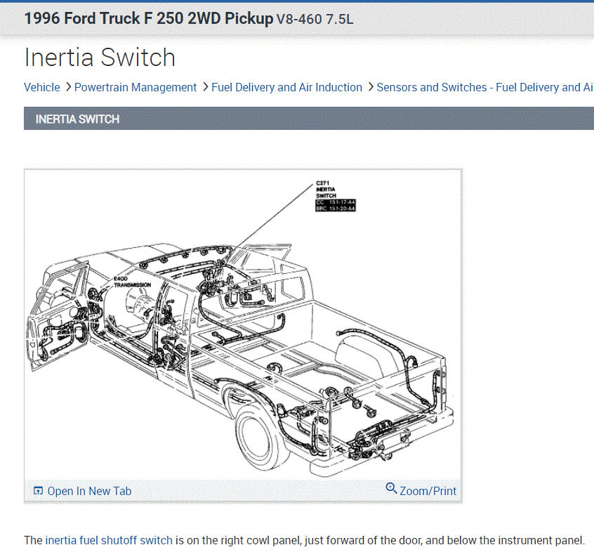

If you have spark and no fuel, there is an inertia fuel cut-off switch that may need reset. IT is on the passenger side under the kick panel. See pic 1 below. If that is what is happening, try resetting the switch to see if the fuel pump works. Pic 2 below shows what the switch looks like.

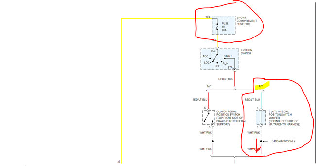

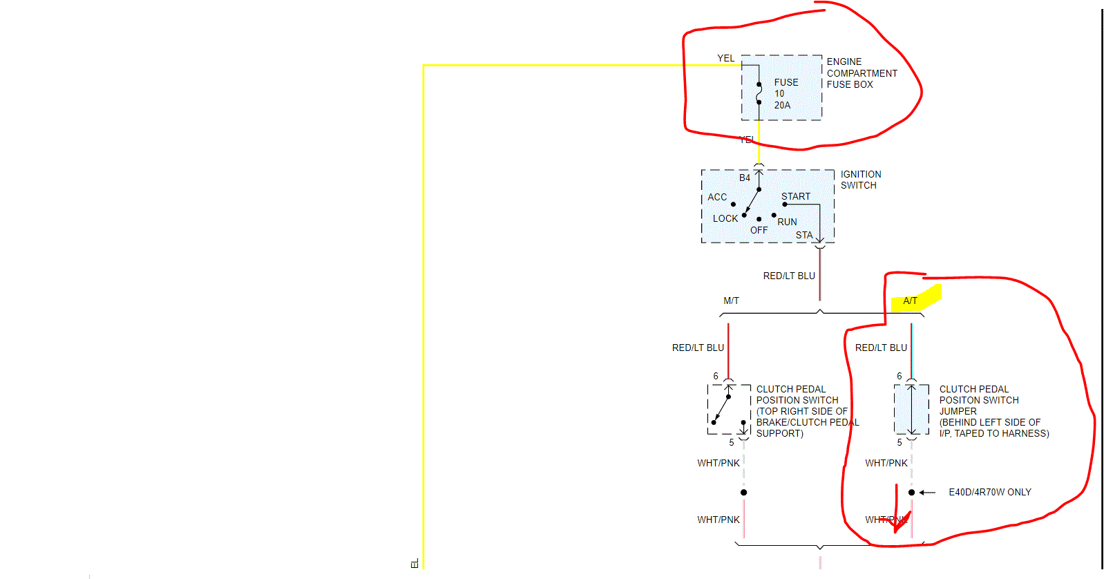

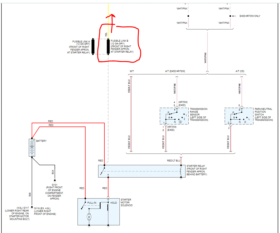

If it doesn't, we need to check where power is lost. If you look at pics 3 and 4, I included the wiring schematic for the starting system. The easiest thing to check is fuse 10 in the underhood fuse box. Check that fuse. In addition to the fuse, confirm there is power to it. It is powered by a fusible link which may be bad.
