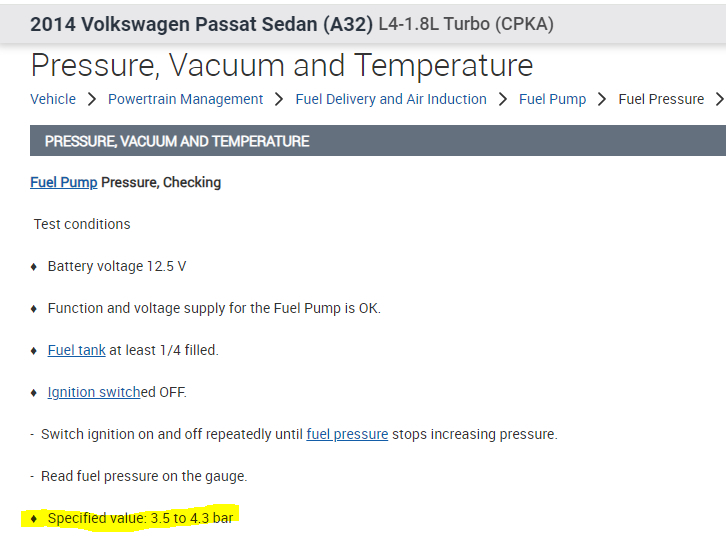

I think that is a good idea. It may be weak. As far as testing it, here is a link to help:
The specifications indicate 3.5 to 4.3 bar. That is around 60 PSI. You will need a fuel pressure gauge. If you don't have one, most parts stores will lend one to you.
Let me know what you find.
