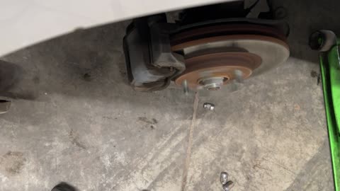

It starts even at lower speed, not in steering but i feel in the whole car then gets worse and worse. I thought maybe it was the wheel, so I jacked up the car and was about to switch front to back but noticed the wobble with wheel on then took wheel off and am seeing a wobble in the axle, do you see it? I tested the other side wheel, and it has no wobbling at all.

I'm struggling to see what you described other than a bit nearest the transmission. Is there any play in that CV joint? Also, for the wheel to wobble, I would say it has to do with the hub bearing.
With the wheel on but off the ground, can you wiggle it in any direction?

No play at all in the wheel while installed. I thought it was a suspension part but didn't see anything other than the inside wibble. No noise while driving.

The CV joint itself may be faulty. That is the only place I noticed movement. If you safely secure the vehicle, lift that wheel off the ground and install safety stands.
With the engine off, reach into the inner CV joint and see if there is play in it.
Also, when you say wobble, is it an up and down feeling or side to side?

By wobble i mean the movement of the axle in a noncircular typical motion like it should. Whatever is in the video, not sure if it's up down or what.

I saw it in the video. I was wondering while driving which direction the vehicle was moving from the wobble. Now that I'm saying it, it doesn't make sense to me either. LOL

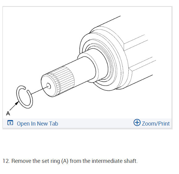

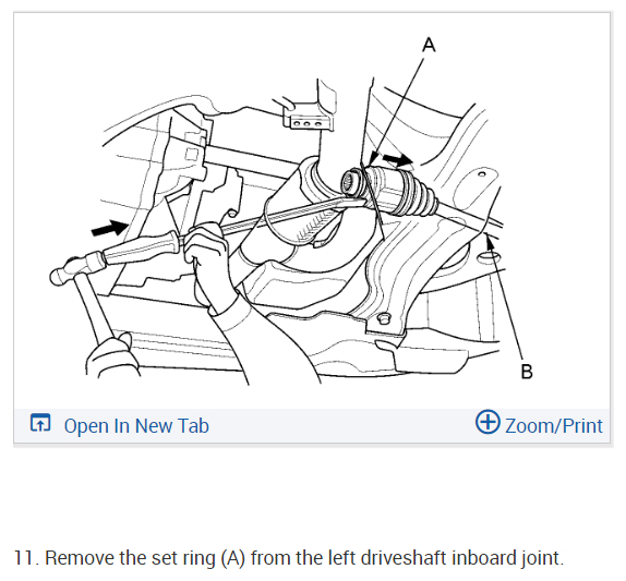

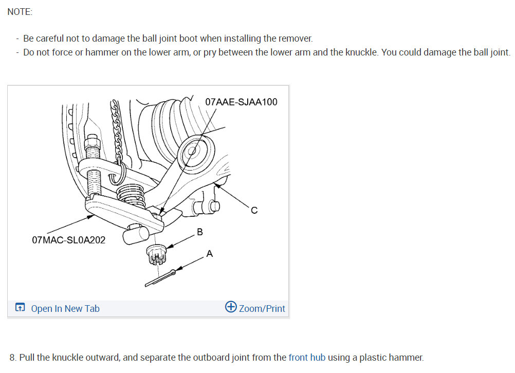

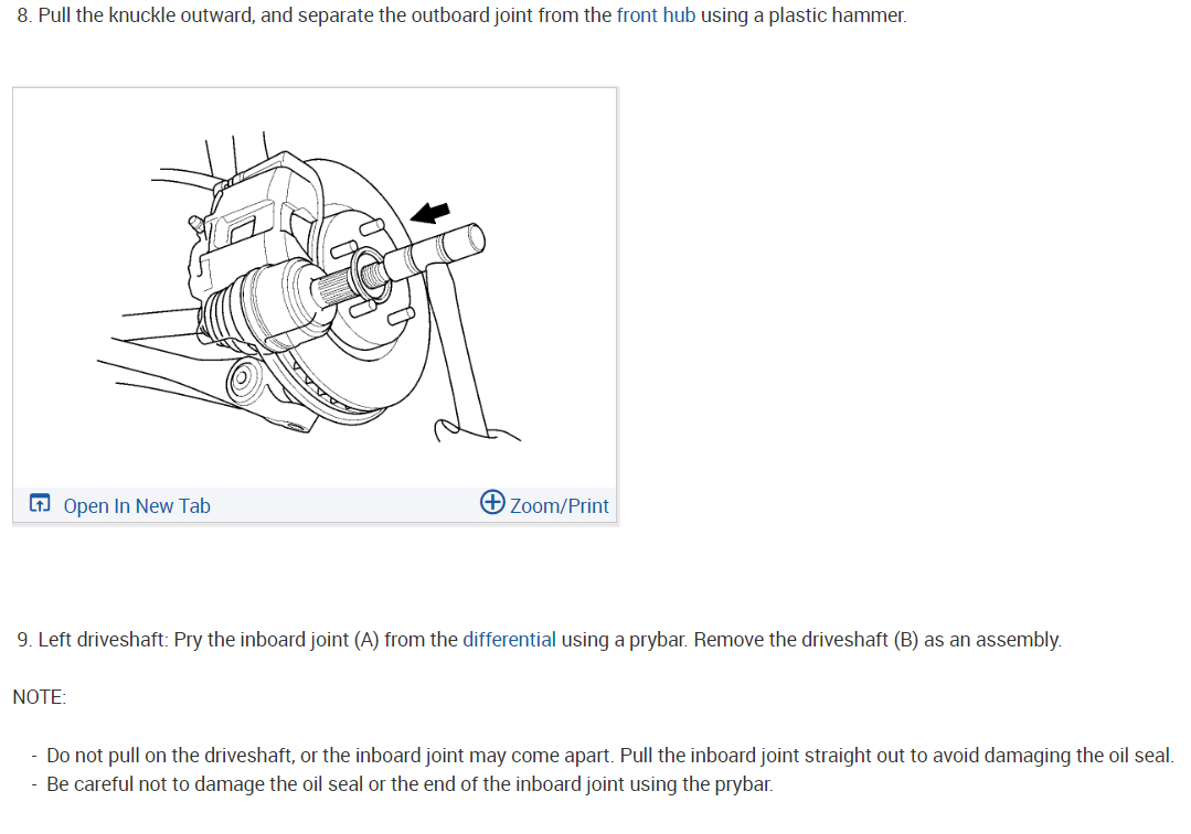

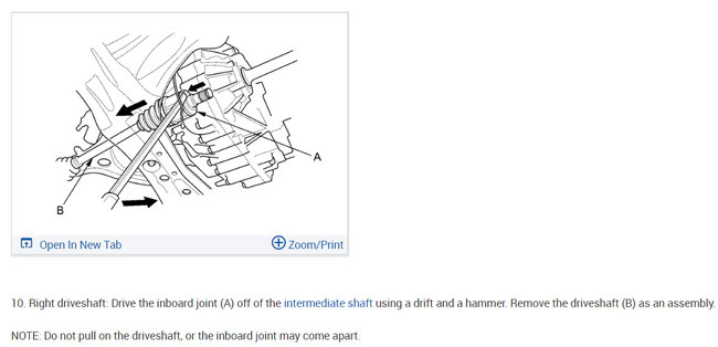

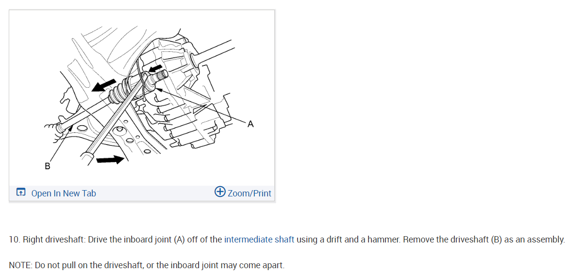

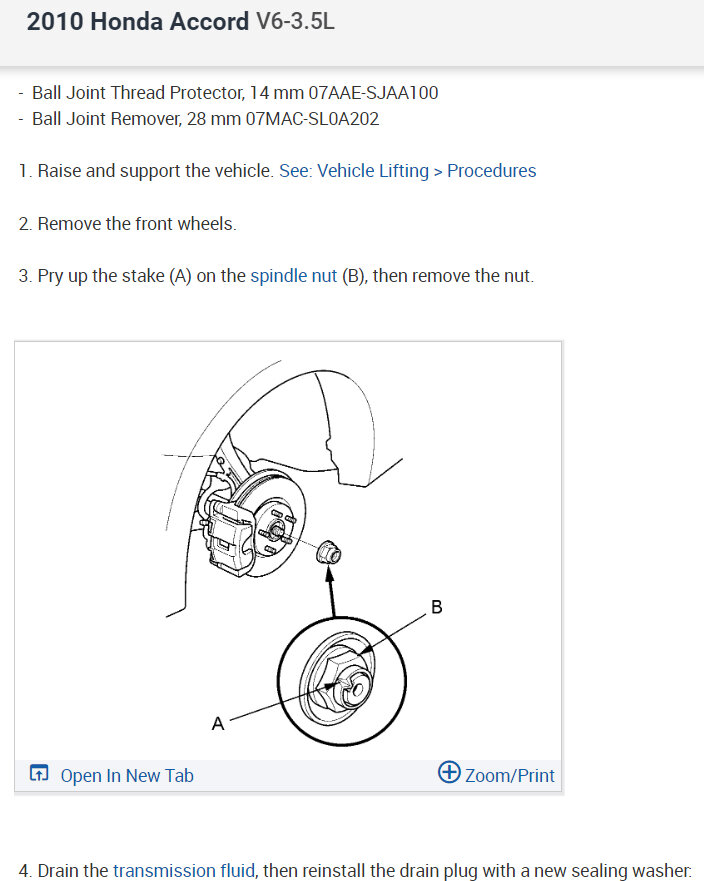

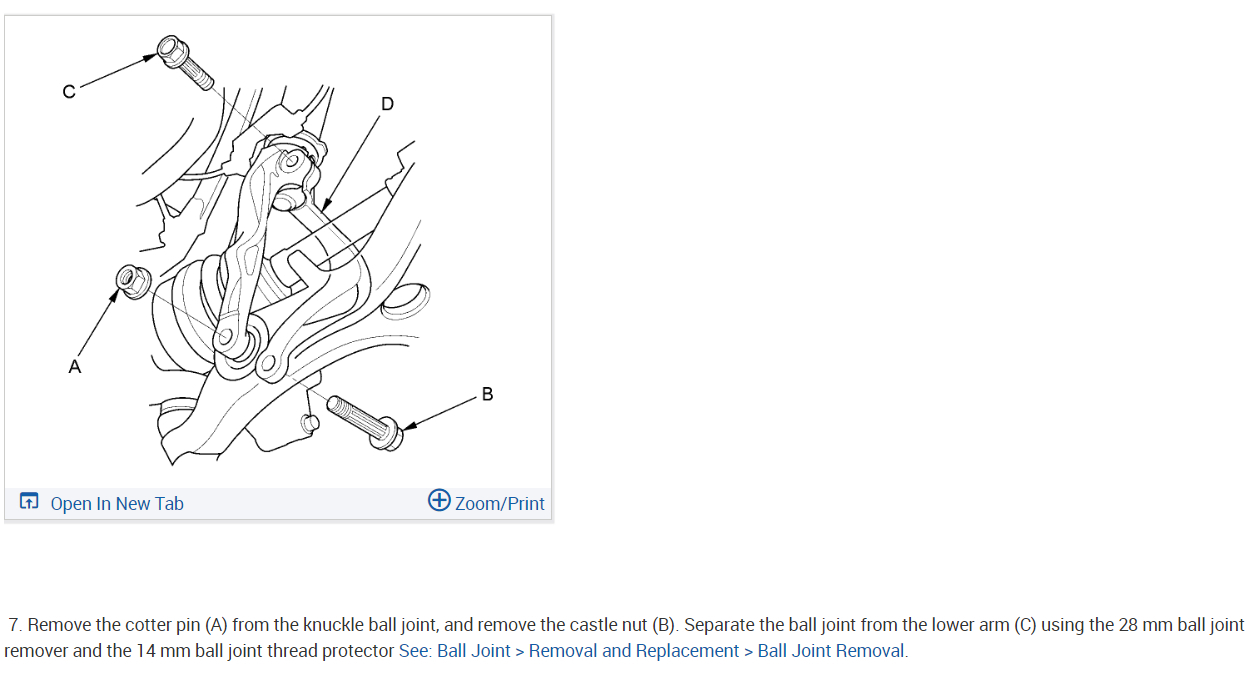

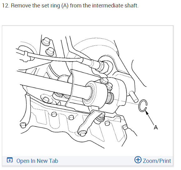

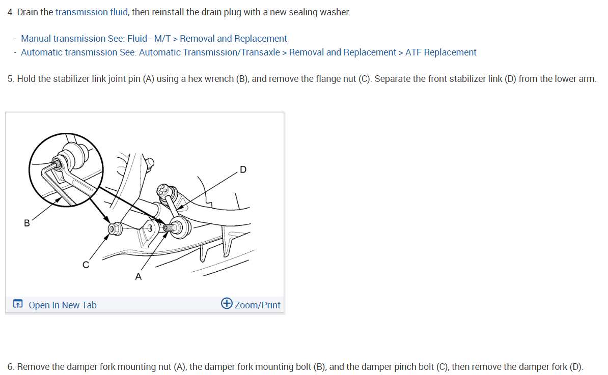

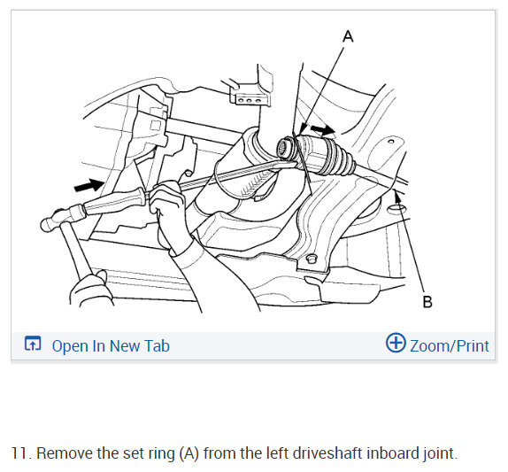

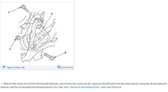

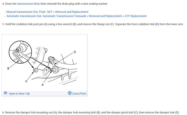

Low speed wobbles are usually the tire or CV axle. Since you say the tires are okay I would swap out the CV axle, her is how. Check out the images (below). Please let us know what happens.
