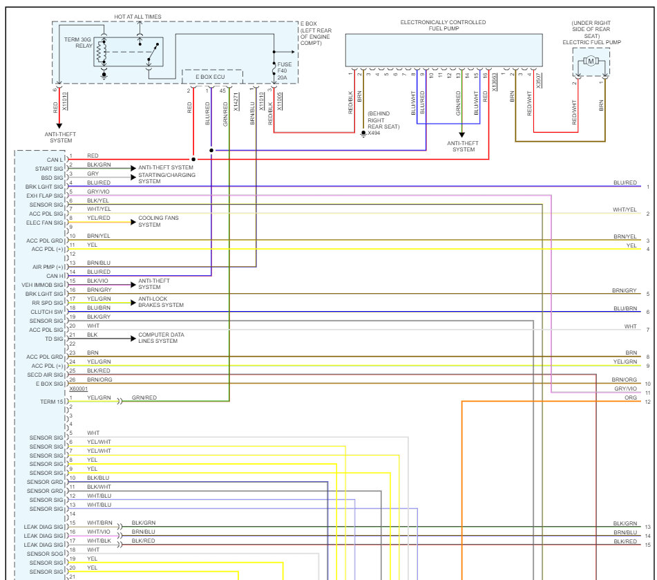

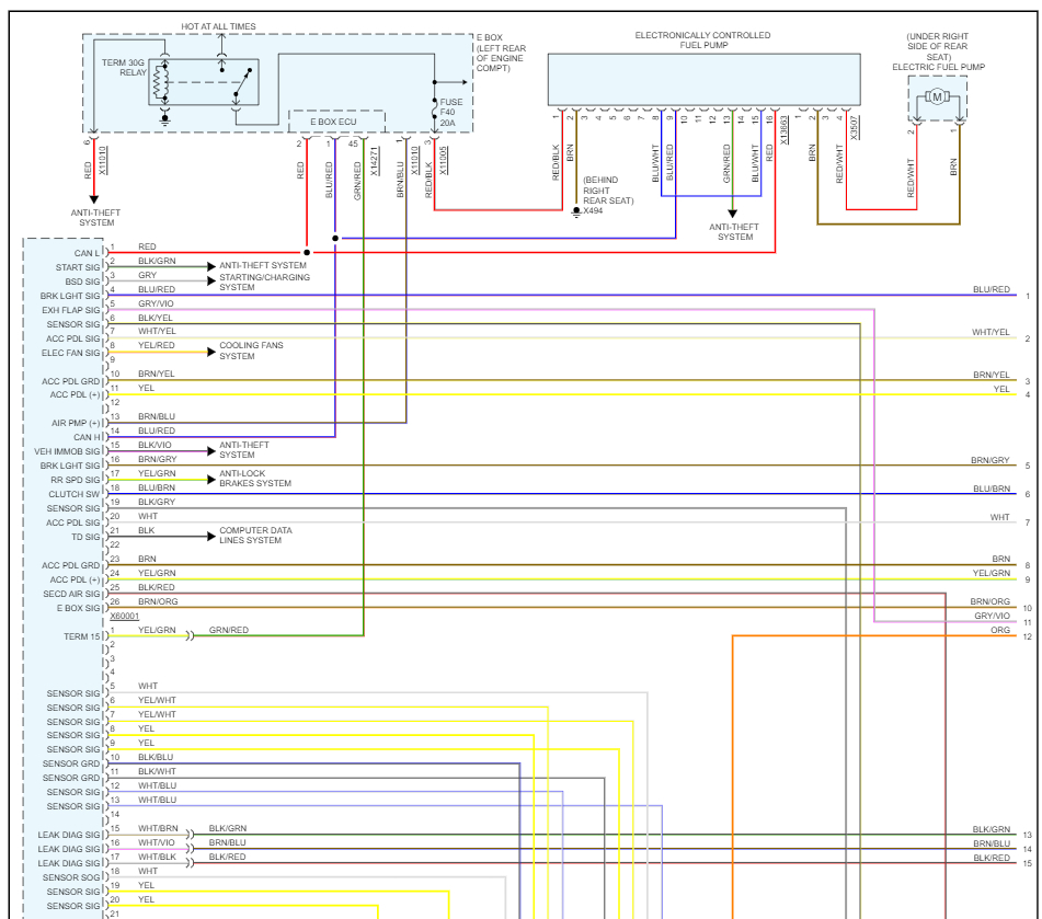

My fuel pump isn't getting power and want to test it but don't know what wires are power and what aren't
Aug 28, 2023 at 8:36 PM

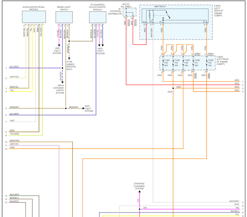

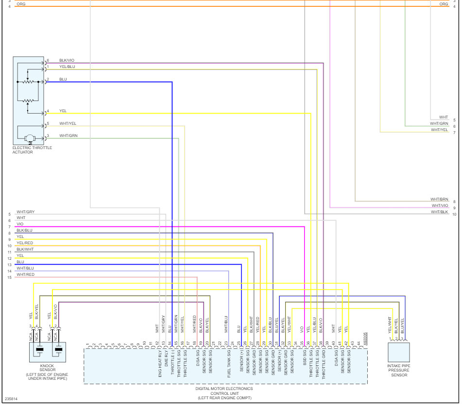

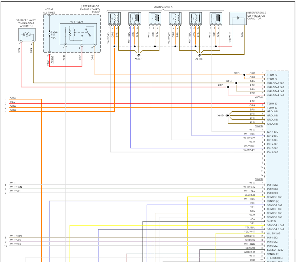

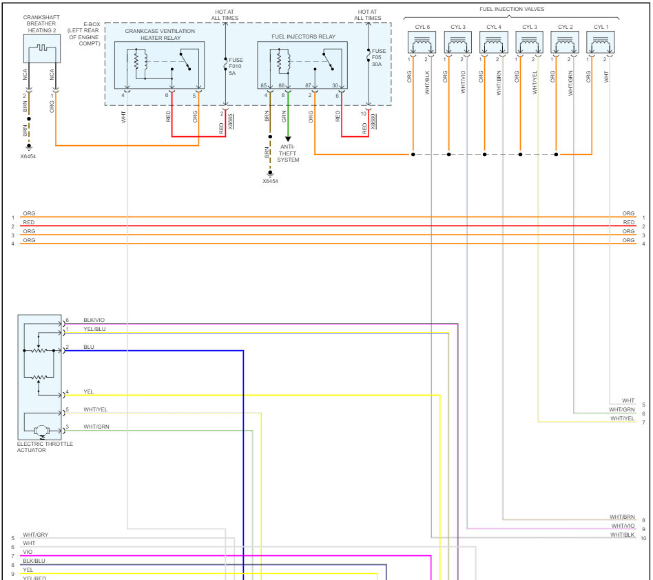

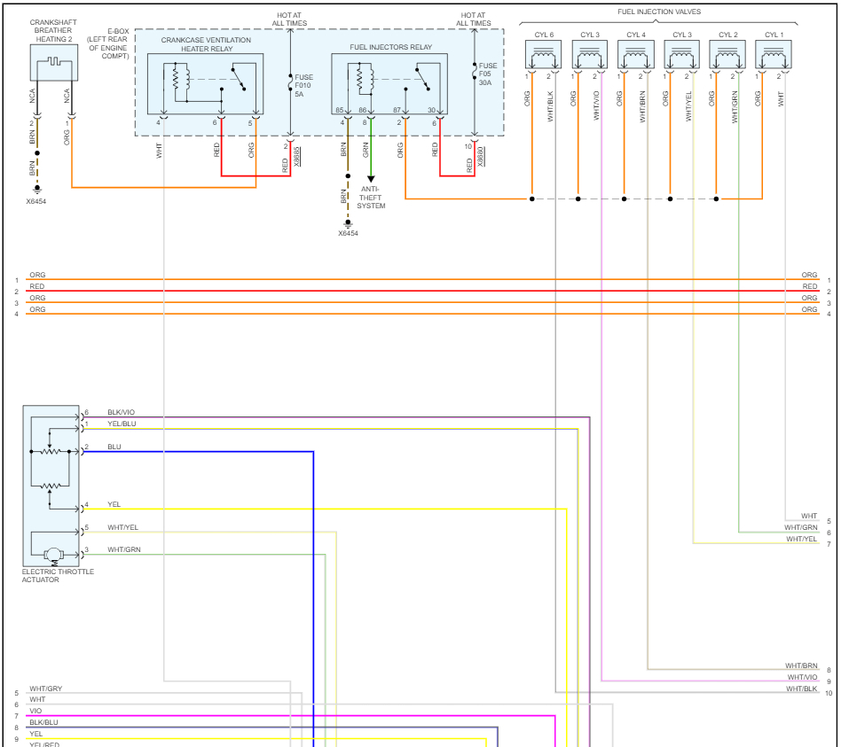

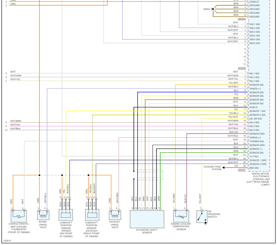

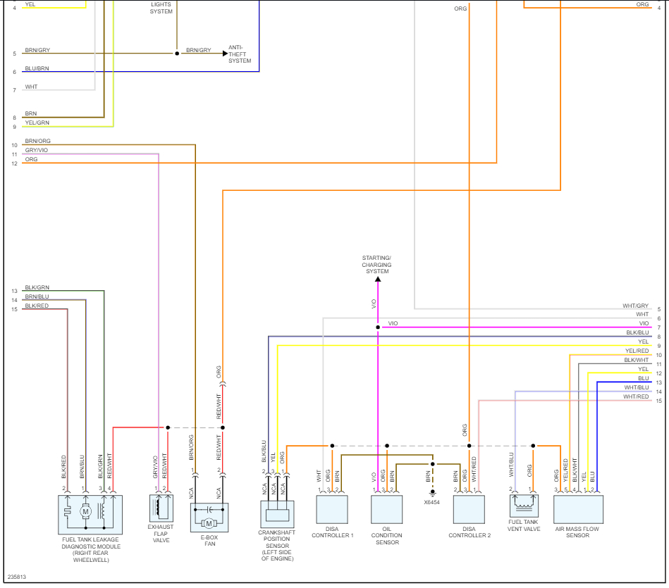

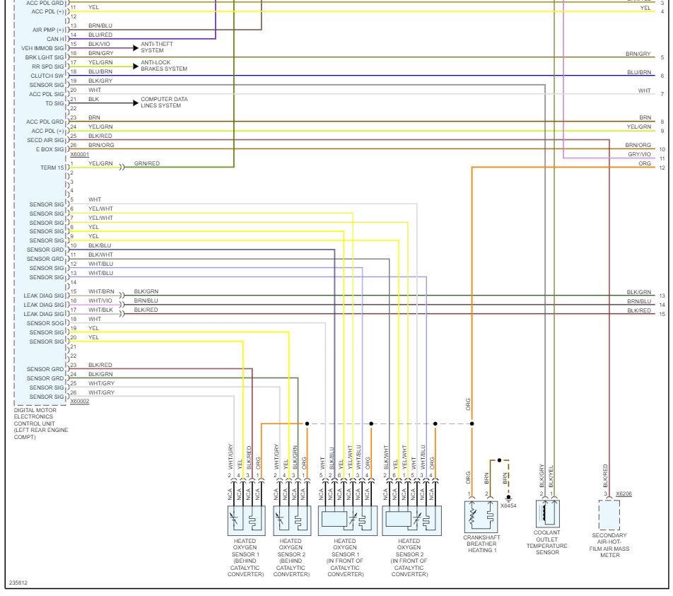

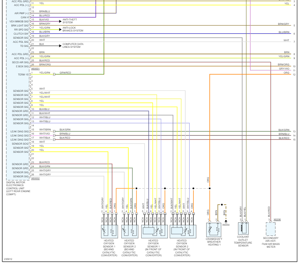

I would check fuse #40f in the engine bay fuse panel here is a guide to help and I have included the engine and fuel pump wiring diagrams so you can see how the system works.
Check out the images (below). Please let us know if you need anything else to get the problem fixed.
