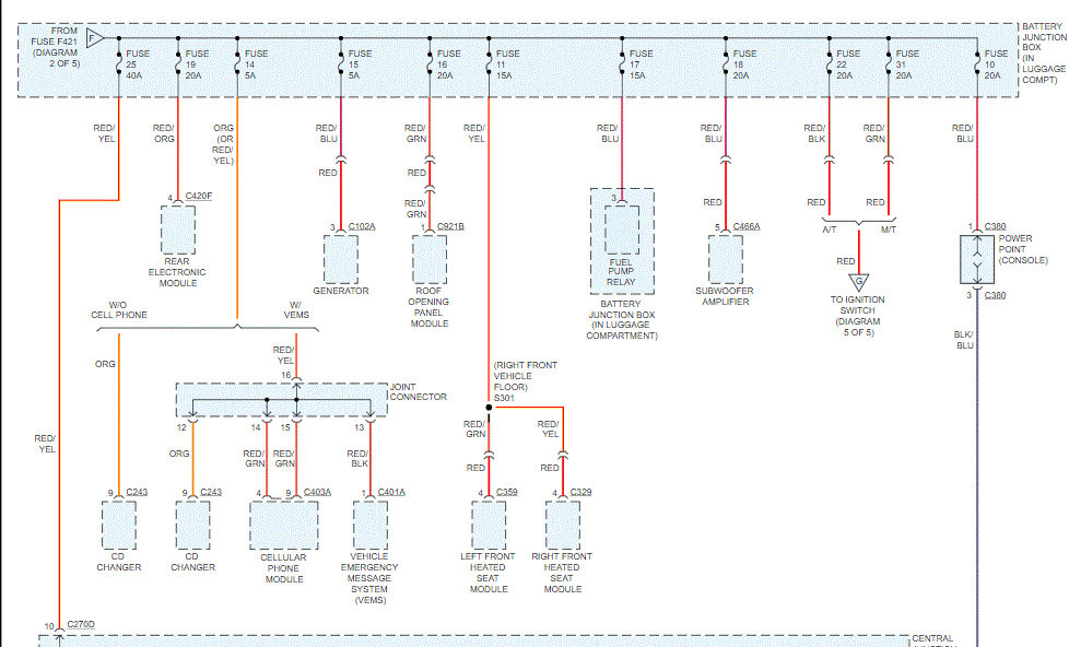

Good morning,

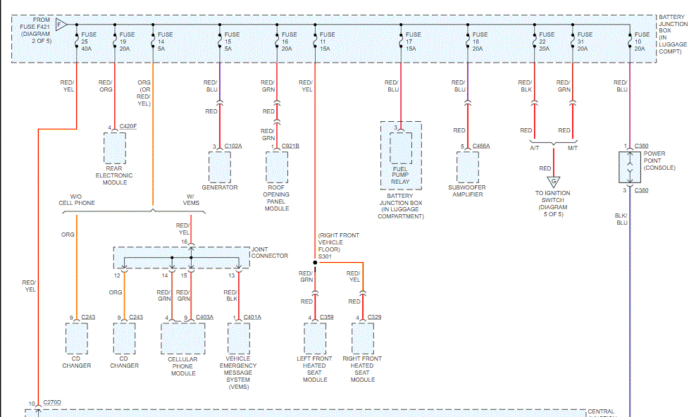

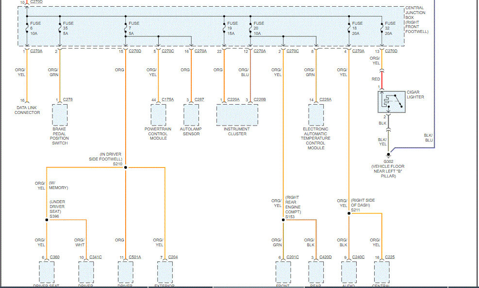

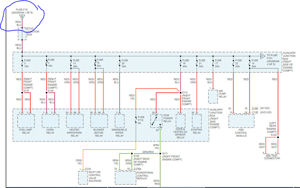

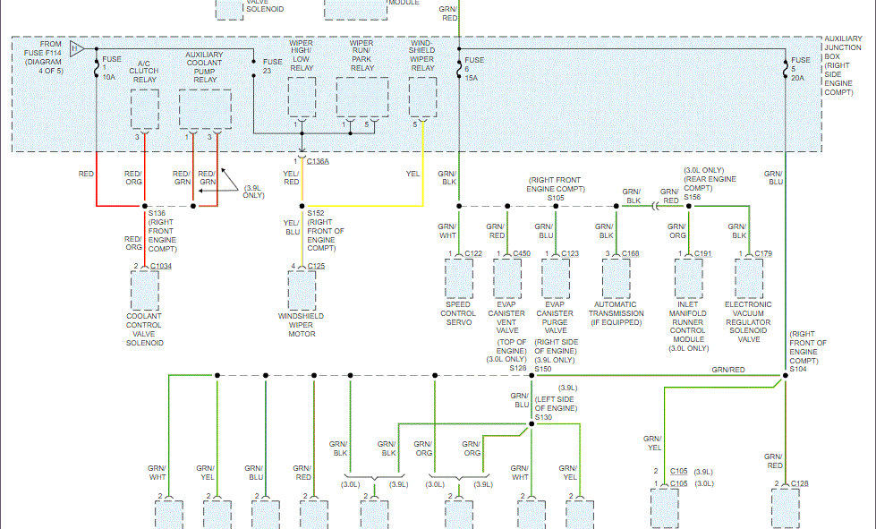

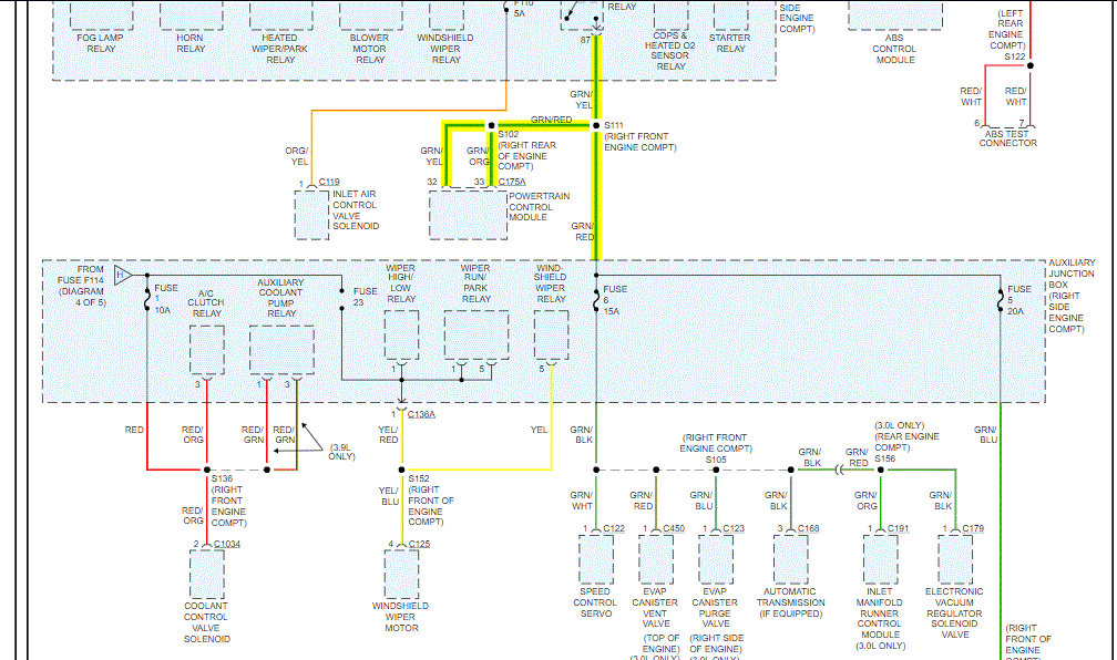

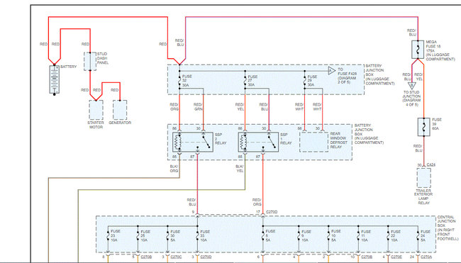

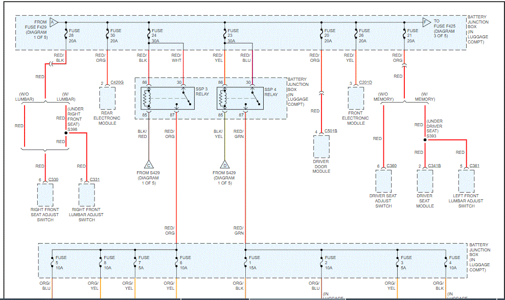

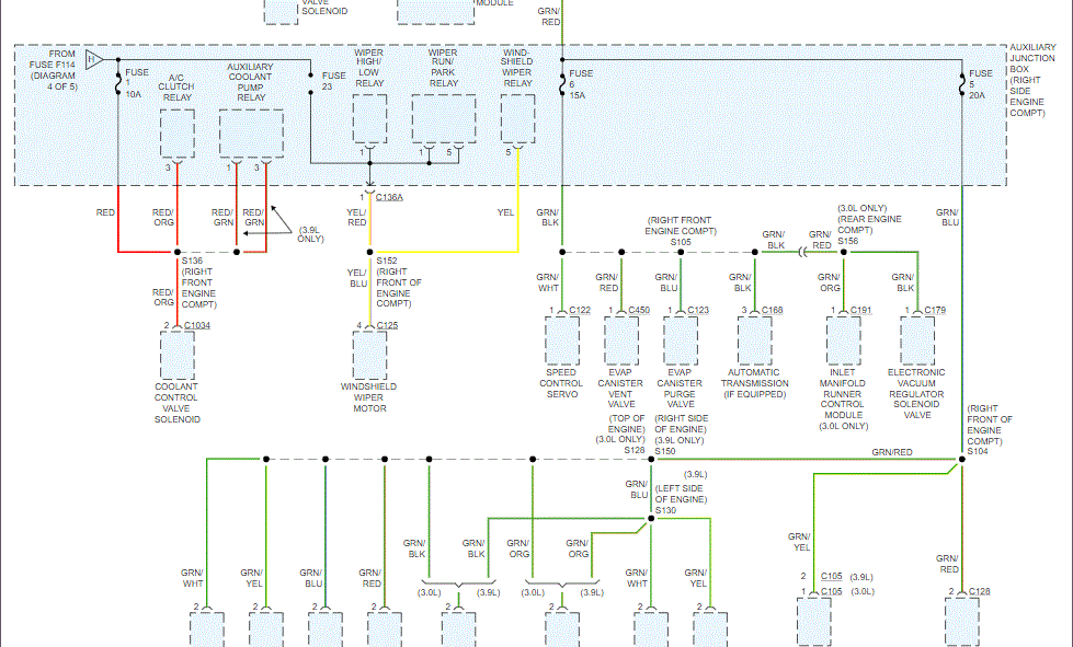

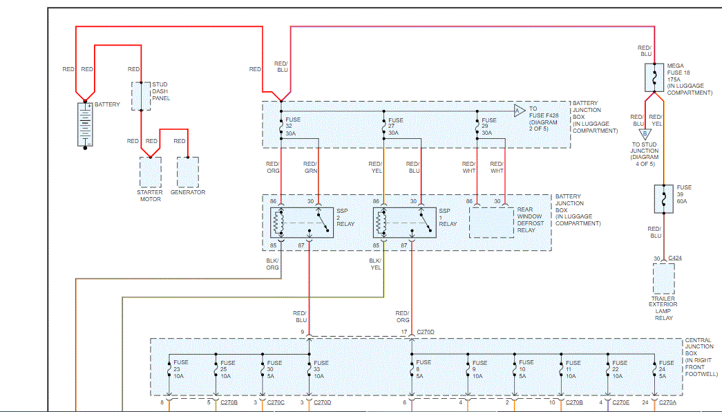

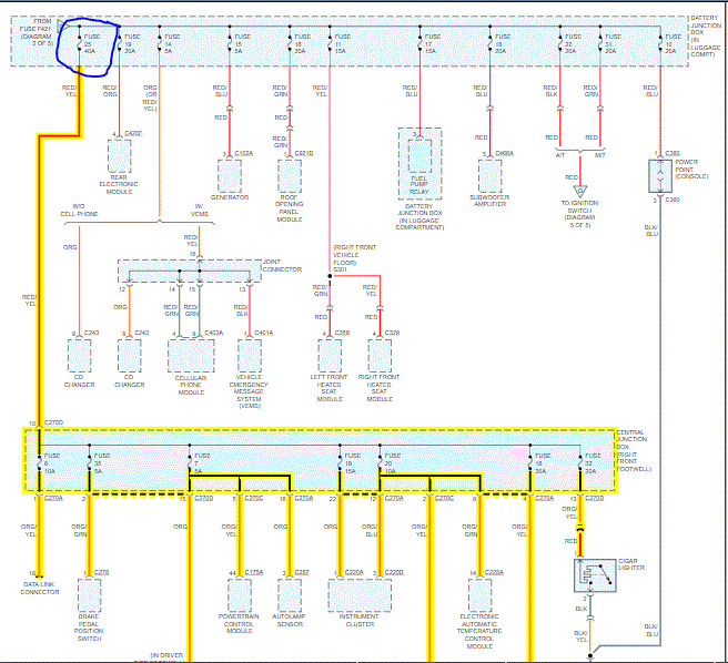

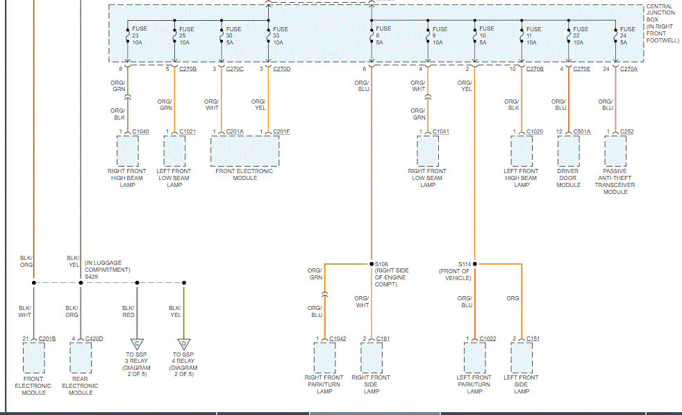

I attached the fuse block wiring diagrams for the car. The mega fuse in the trunk controls power to the various fuse boxes.
We need to do some voltage checks to find out what has failed. It all started with the fans. We will start there when you are ready.
Do you have a voltmeter for some testing?

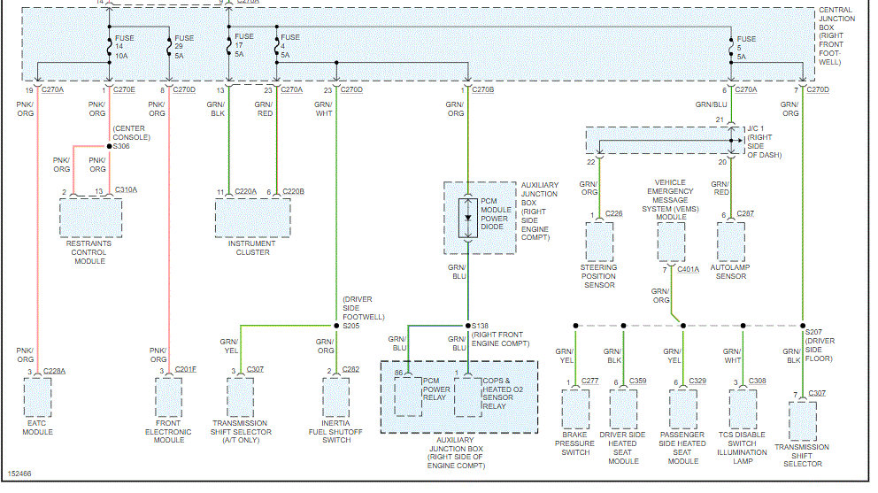

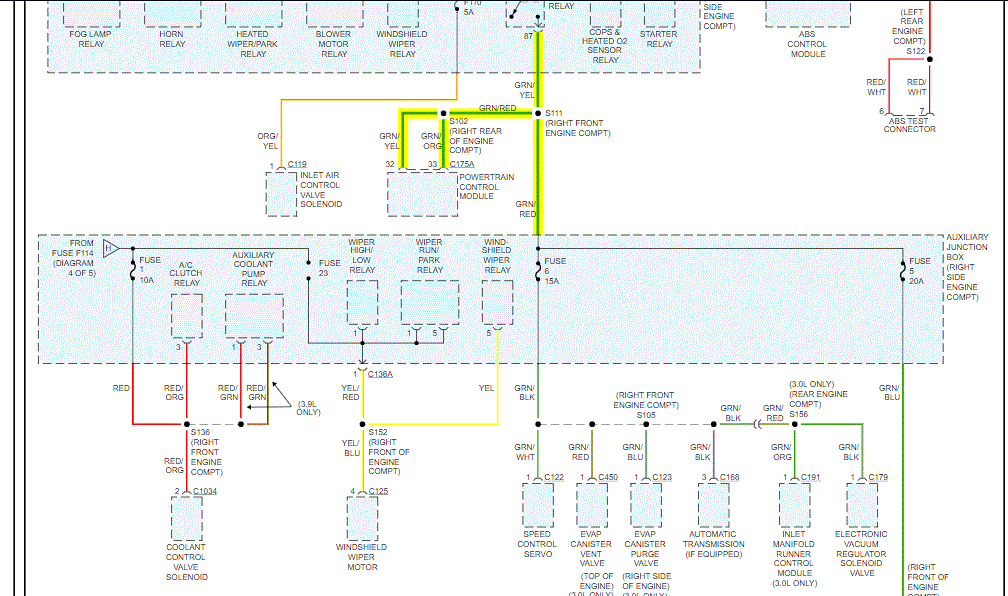

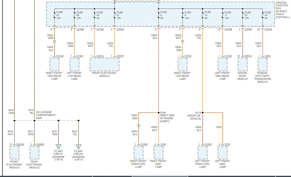

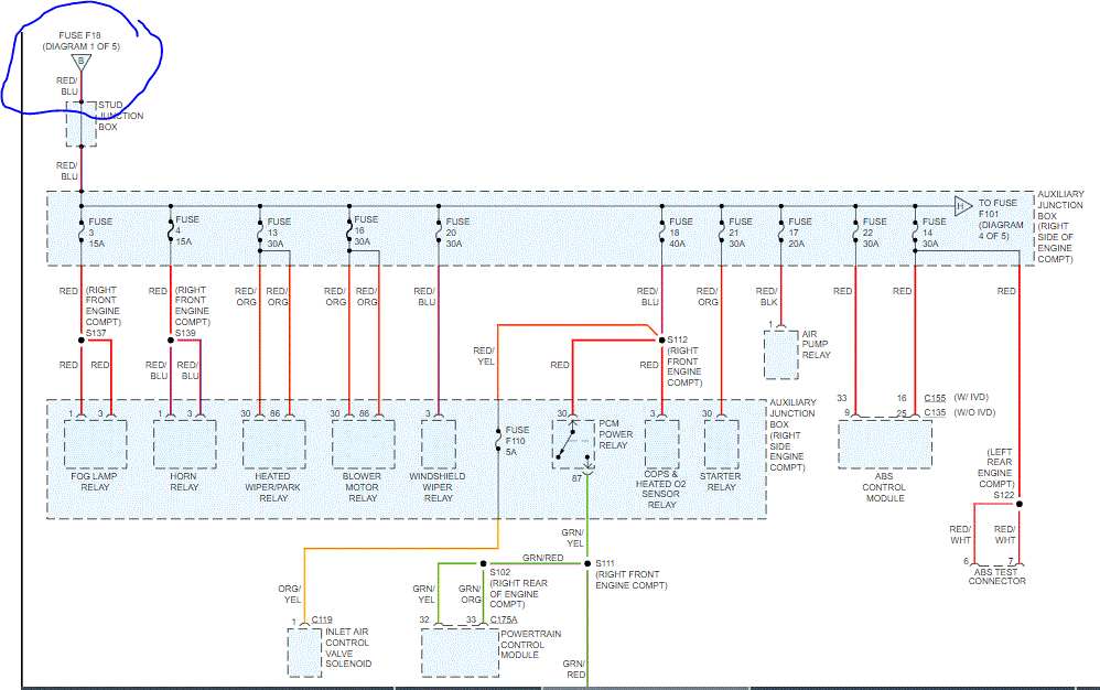

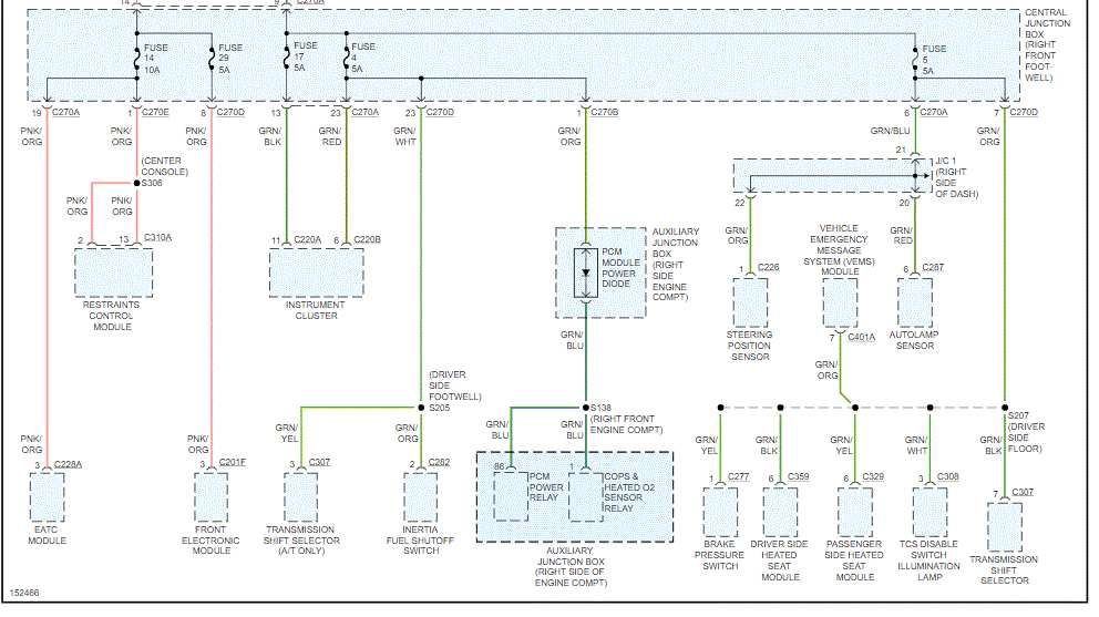

Okay, 5 and 6 are fed from the ECM power relay. That is why it will not start. Fuse 6 is the feed for the injectors.

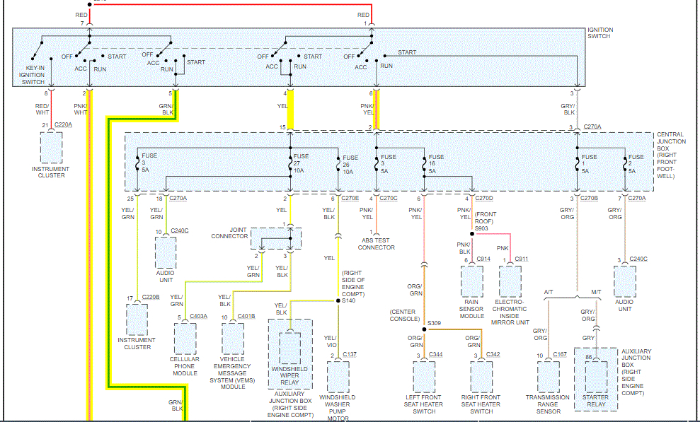

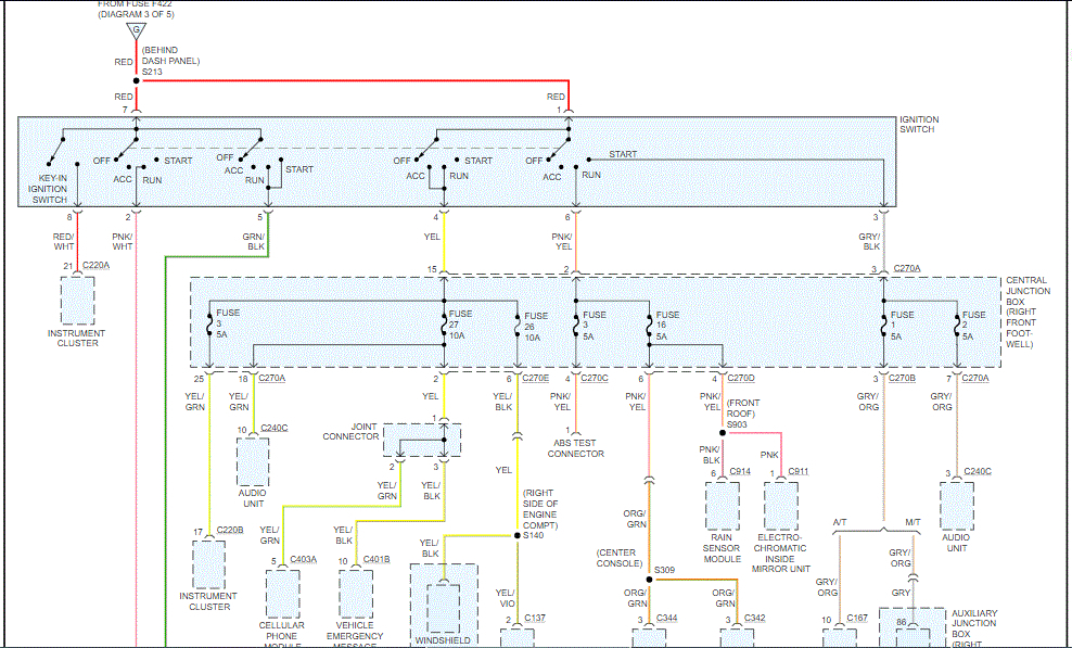

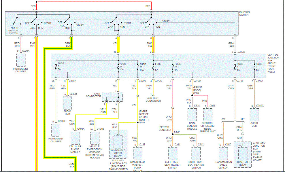

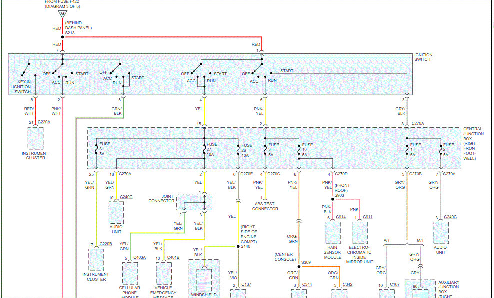

The ignition switch controls power to the fuse boxes in the car. I attached a diagram of that as well. It may have failed the ignition switch.

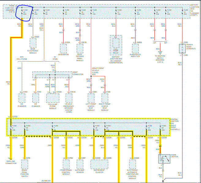

The right front foot well fuse block is fed from the back fuse box from fuse 25. There is a 40 amp fuse that feeds the fuse block. I attached that diagram as well.
