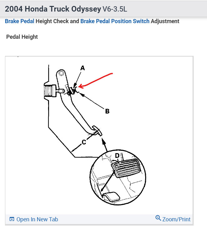

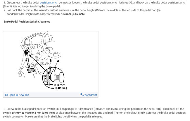

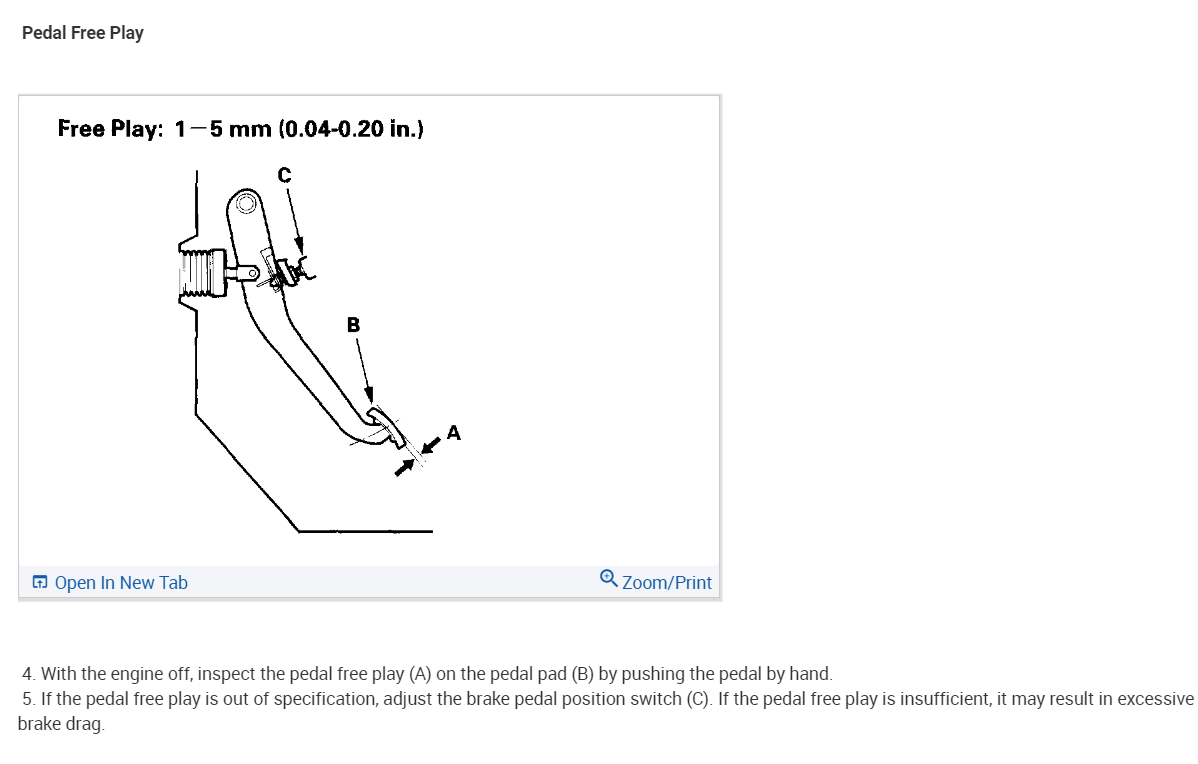

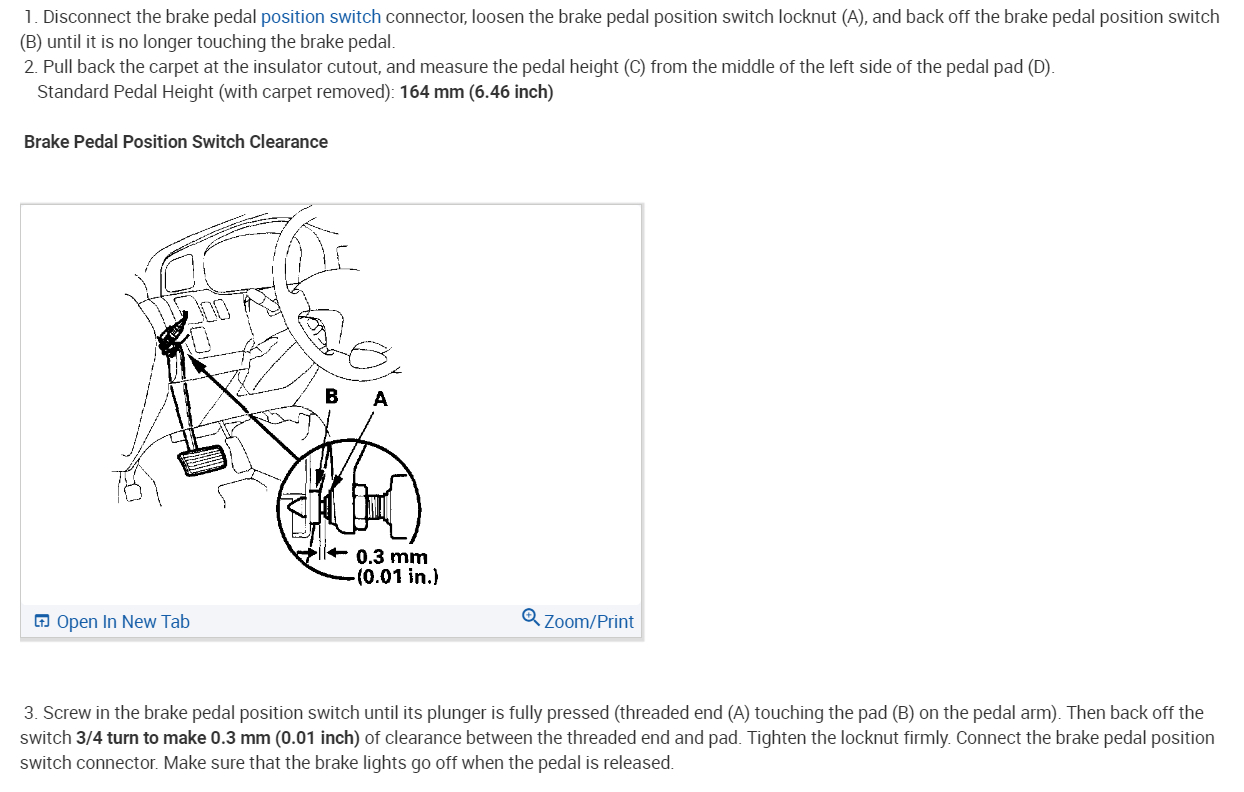

It sounds like the brake light switch has gone bad, has that been replaced? If not here is the location and how the switch is replaced. Also, here is a video of the job being done on a similar car, the step and the same:
https://youtu.be/RBCDVfzNQGk?si=-_BBee1m0iThGQ97
Check out the images (below). Let us know what happens and please upload pictures or videos of the problem so we can see what's going on.
