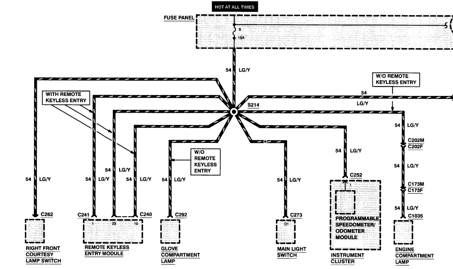

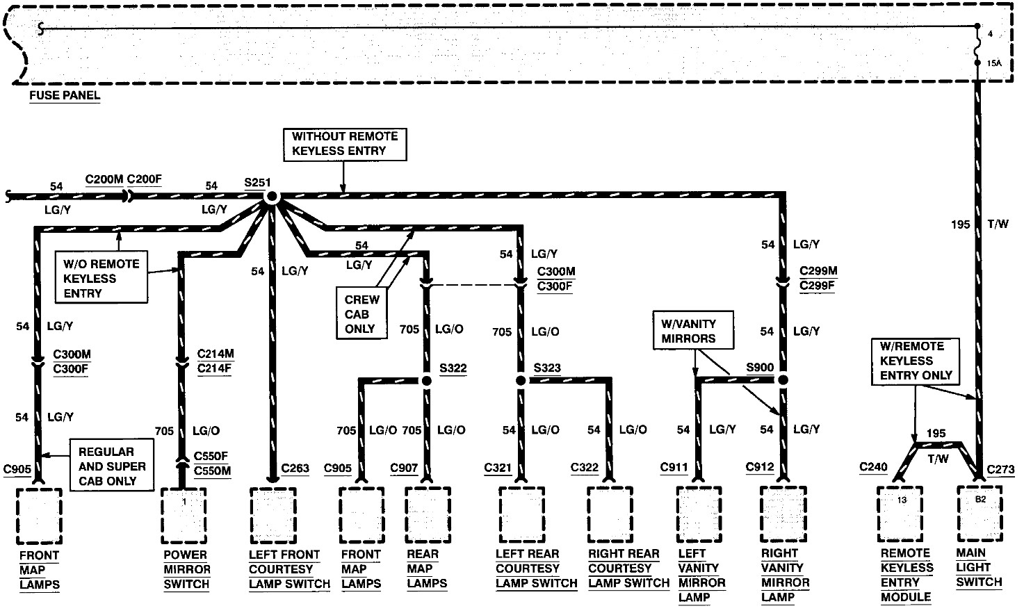

The truck starts and moves but the following don’t work:
Interior dome lights.
Lights on the doors.
Odometer is blank.
Door locks don’t work.
Headlights, and door windows do work.

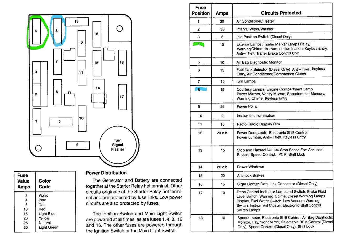

What wires should I be looking for to fix these, or what fuses also?
Odometer is blank.
