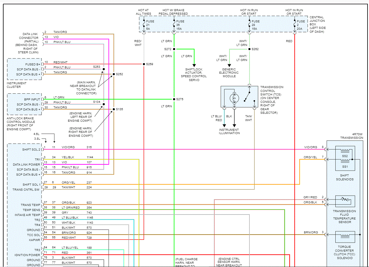

I am looking for wiring diagram of 15 pin connector going to back of engine towards transmission.

It is part of engine controls so transmission wiring harness.

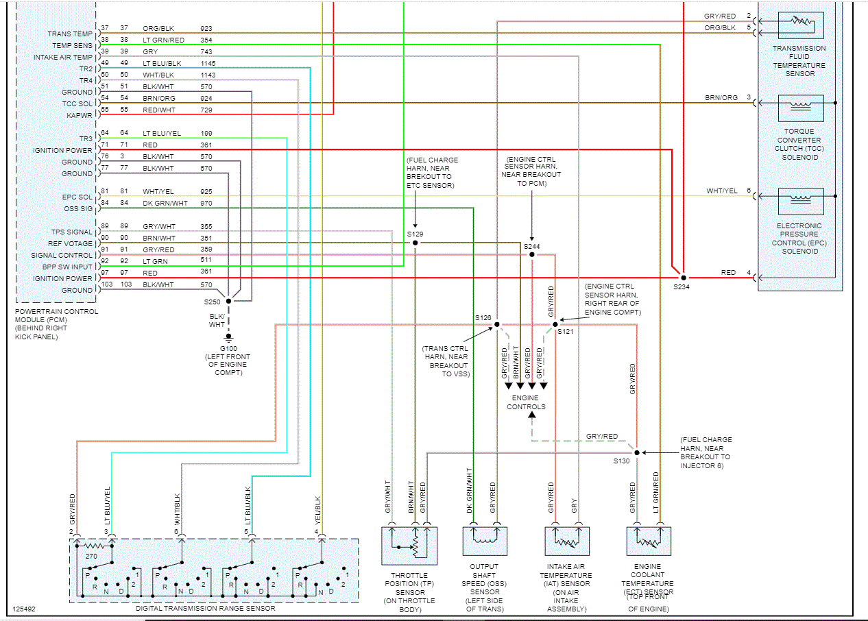

I attached the wiring schematic related to the transmission circuits. Take a look through them and let me know if that is what you needed. If it is something different, let me know and I'll try to get what you need.
See pics below. Note: The schematic was one page. I had to cut it in two, so it was readable for you. I did overlap the two so you can follow from one to the next.
