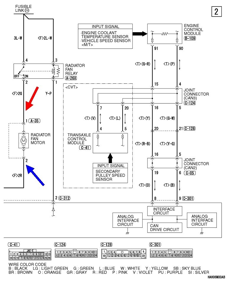

This is kind of a hard circuit to work on as far as reaching test points, but if you can get the fan to go dead and stay that way, that's the perfect time to take some voltage readings. With those we can figure out exactly where the problem is. This is the diagram for the fan and relay. If you can get to the connector terminals to take the readings, you should find 12 volts at the red arrow when the fan should be running, and 0 volts at the blue arrow all the time. Any voltage at the blue arrow indicates too much resistance in that wire or terminals.
As for the direction, the fan should blow air toward the engine, same as the natural air flow when you're driving. If it's blowing forward, the two wires have to be switched in one half of the connector. Every connector is purposely made confusing to take apart. Look for a little "pimento", or lock that can be pried out in the middle, between the terminals. Once removed, that will give you access to a little plastic finger that must be lifted in some way to let the terminal slide out. These can be frustrating to figure out. The connector views are at the bottom to show which wires are involved. Let me know if you can't read them. I can cut them apart, then expand them in sections.
