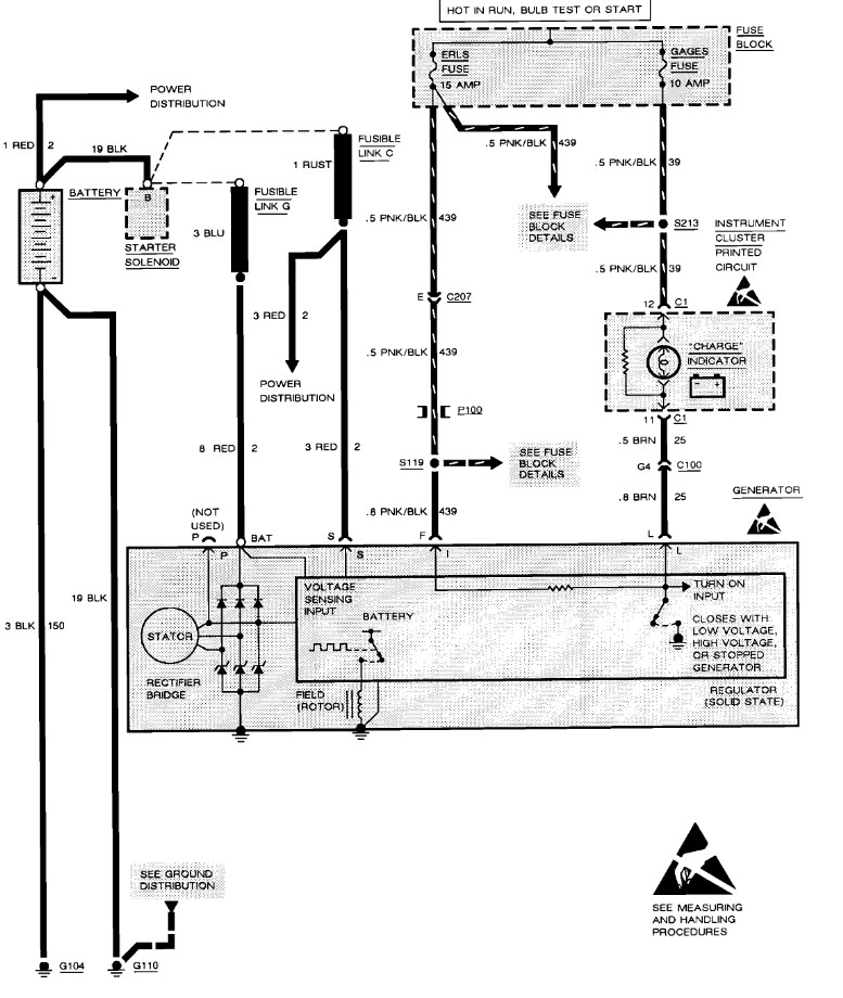

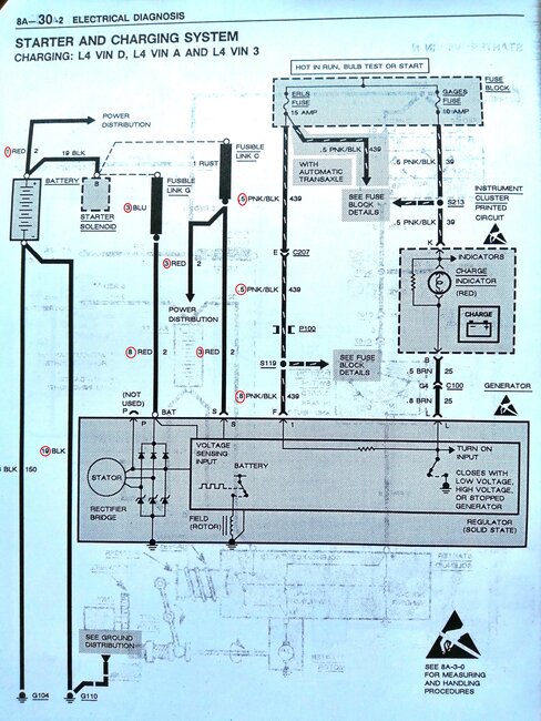

There are numbers on the wiring diagram. I have circled them. What do these numbers mean on a wiring diagram? Is it the cross-sectional area of the wires? Is it the diameter? What are the units of measurement? And how do you convert it to mm²?

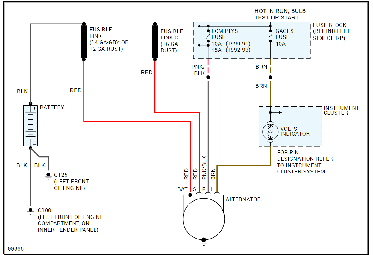

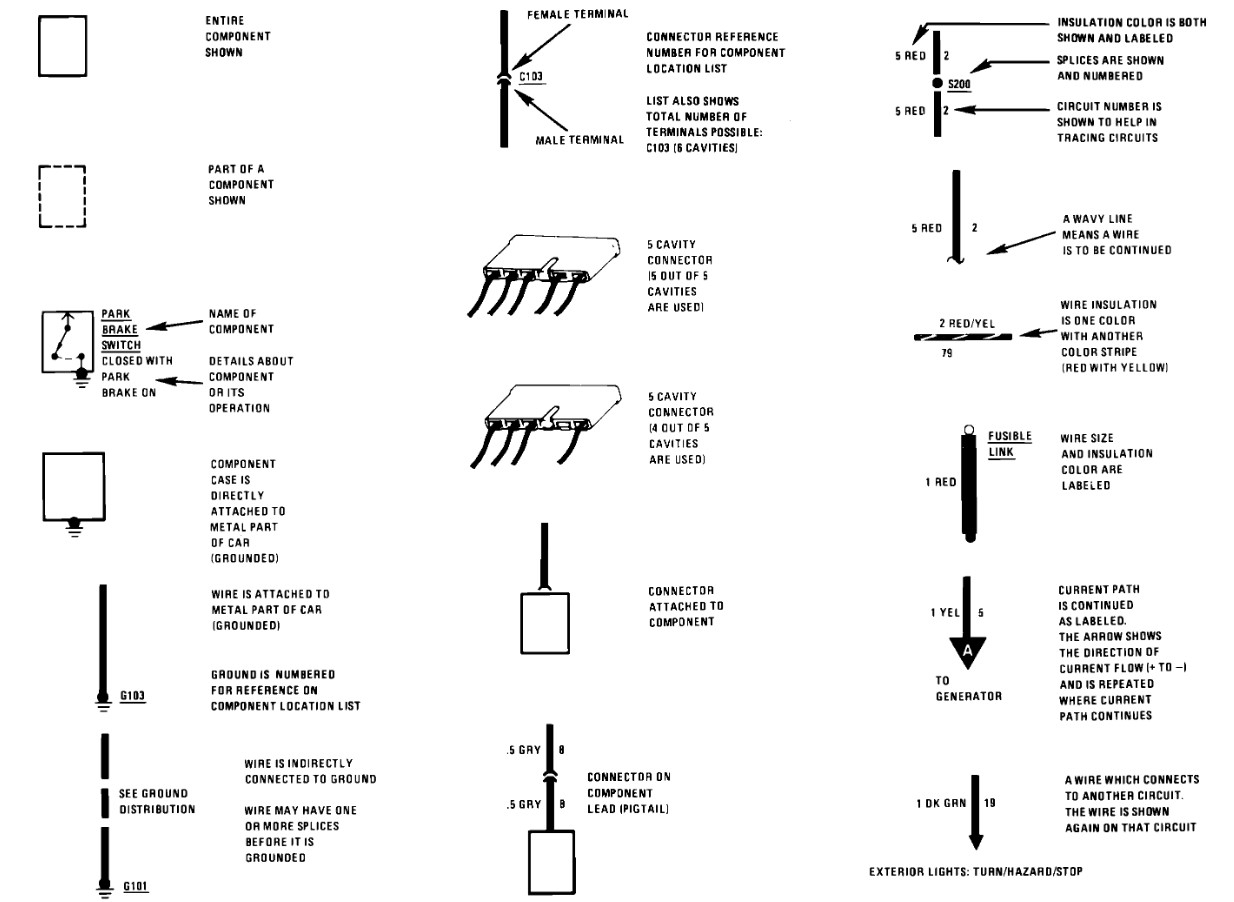

I can't read it, here are the wiring diagrams from Alldata. They don't tell us the gauge of the wires; can I ask what you are trying to do? Here is what they show us. Check out the images (below).

The numbers on that diagram are the metric diameter of the conductor inside the insulation. so a .6 would be .6mm or 22awg.

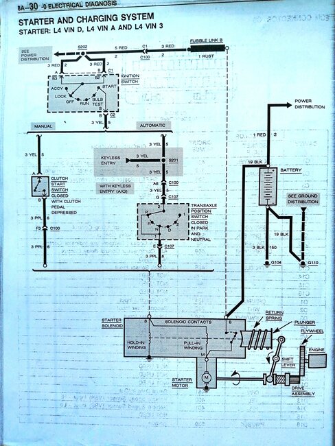

The wires from the battery to the starter are labeled as 19 BLK. Of course, these wires must have a large cross-section. Maybe the number 19 means the cross-sectional area? Maybe it means 19 mm? (The diagrams are taken from a 1993 US car repair manual).
Apr 23, 2024 at 8:18 PM
ALEXBEL
  • 65 POSTS
19 mm2.
Apr 23, 2024 at 8:20 PM
STEVE W.
  • 15,113 POSTS

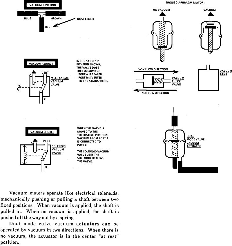

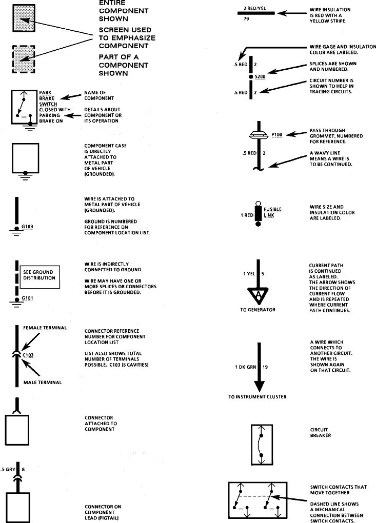

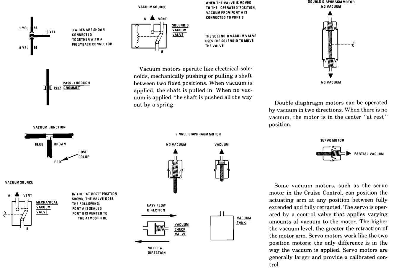

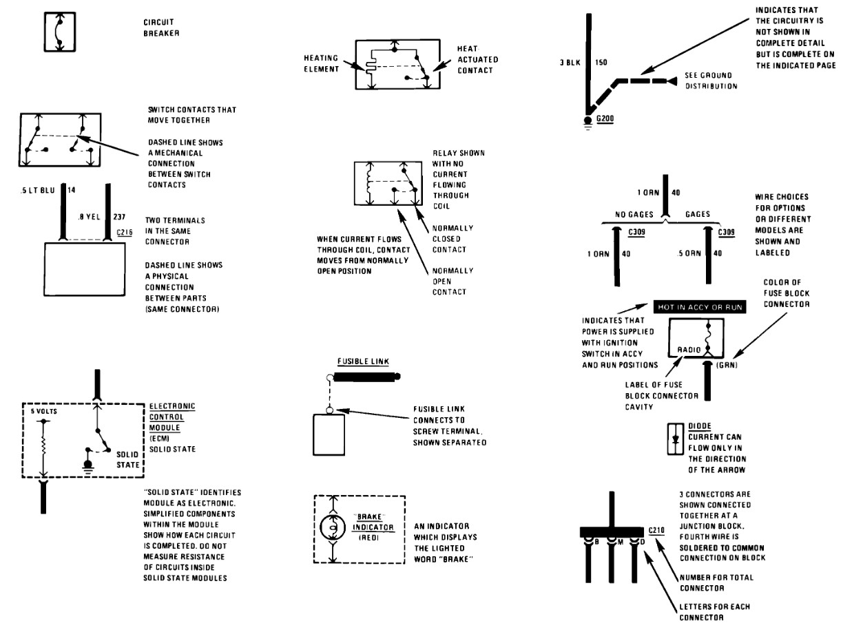

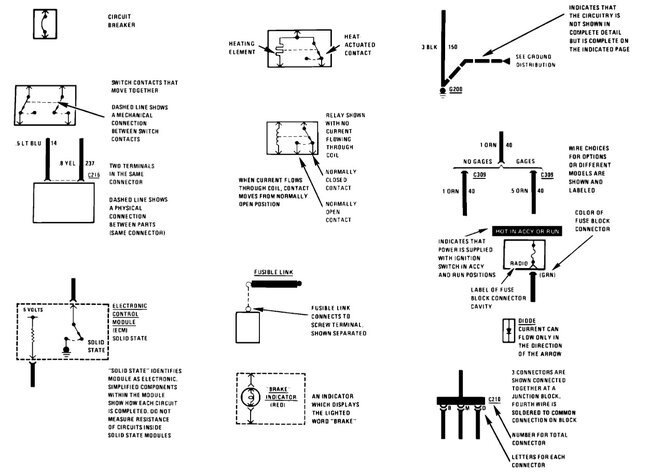

It is 19mm if you were to cut the wire and measure across the diameter of the exposed copper. The insulation isn't included in the measurement. The images I posted are from the same GM manual. The first three are the definitions for the items in that manual. However, that is not a universal guide as other makes and even other models in the GM line use some different symbols. Others just show the wire color in the diagrams and then use a call out list to give the sizes and others only show the colors. Then there are the various layouts as well, Imports for example use what are known as track diagrams like the attached.
If you want to really learn about how to read them there are multiple videos out there showing the various types and how to read them and what all the symbols are. Also, the diagram for one year may not be the same as another year.
One hugh thing to keep in mind about all wiring diagrams, there may be mistakes on them, that one can catch you really quick.

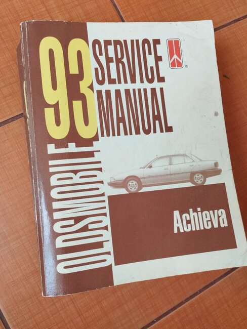

The diagrams are taken from the book (photo). There are a lot of wiring diagrams in this book. It is unlikely that there are any errors. The diameter of starter wires 19 mm for this car is too much. This cannot be. If we assume that the number 19 means the cross-sectional area, then the diameter will be about 5 mm without insulation. It seems to be realistic. Just in case, let's take one more designation. For example, wire 3Yel5 (or 3PPL6). Assuming that the number 3 is the cross-sectional area in mm2, the diameter is about 2 mm without insulation. Also, realistic. Similarly, you can take other wires, there is the same dependence. What do you think?

Believe what you want, I have seen errors in multiple diagrams over the years, both in the OE and redrawn diagrams. 19mm are the main battery cables, which was the design specification and on that vintage would be a heavy cable. It is not any measurement but the diameter. Nothing else.

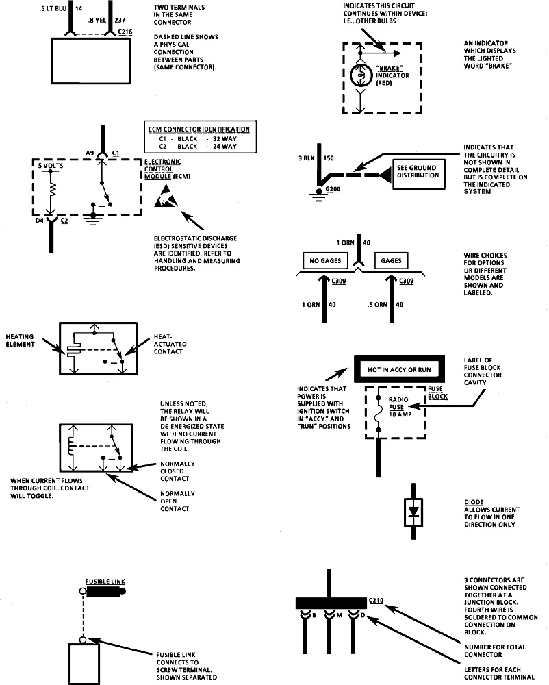

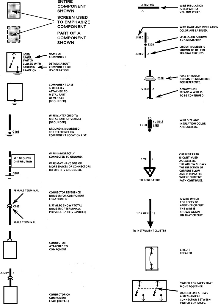

It occurred to me to look for this information for you. I found there's three choices for the 2.3L engine to select the right service manual. You have to use one letter from the VIN. Then, under general electrical repair, there's 15 articles, and within one of them, I finally found a subsection with the three pages I posted below. These would be the same in all GM manuals, regardless of engine size and options. I'm sorry that they show up too small to read. What I do is copy and paste them into a typing program, like MS Word, where they can be expanded. If you don't know how to do that, I can describe the steps, or I can try to cut them up, then expand each part for you.

I merely asked what these numbers (.5, .8, 1, 3, 5, 8, 19) mean on the 90's automotive wiring diagrams published by General Motors Corporation for all GM vehicles in millions of copies. A person with a minimal knowledge of electrical engineering will easily realize that these designations cannot be diameters. I am not in the US and to repair my car I sometimes have to figure out some of the faults myself. I don't know American standards, but through arithmetic I have determined that these numbers mean the cross-sectional area of the wire in mm2. I was looking for cables from the battery to the starter (19mm2). And I found them. I won't be able to buy them, but I will find similar ones. You can look up what the cross section of these cables are to check. Here are the links:
