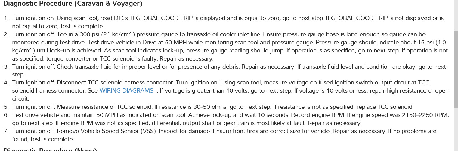

PO740 code keeps setting. I ohmed the wires from ecm to tranny, all good. The solenoid pack has 5v reference at all but one, solid red wire reads 5.7v. Is that correct or should it be 12v? I dont have a wiring diagram so I cannot confirm correct voltages.
