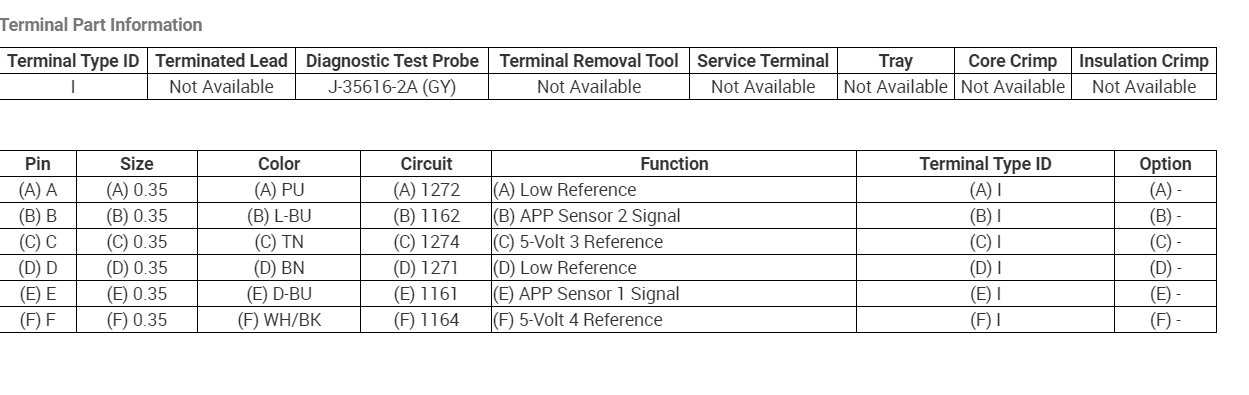

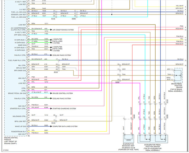

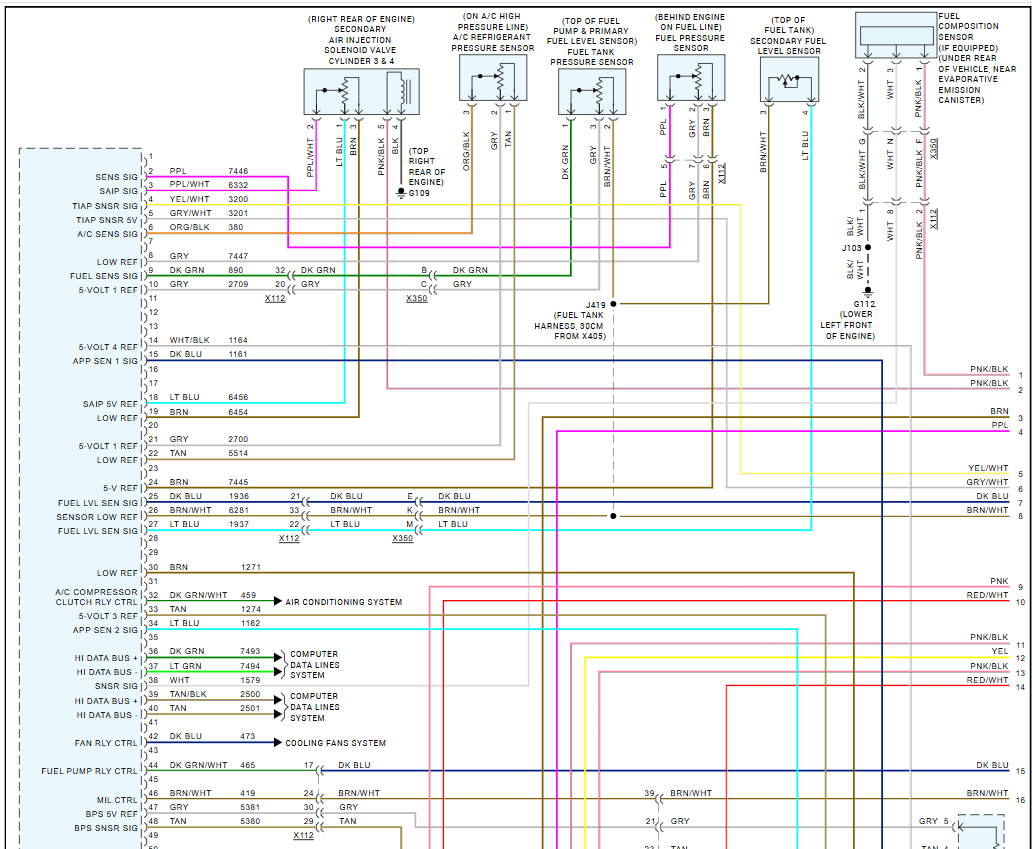

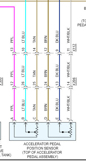

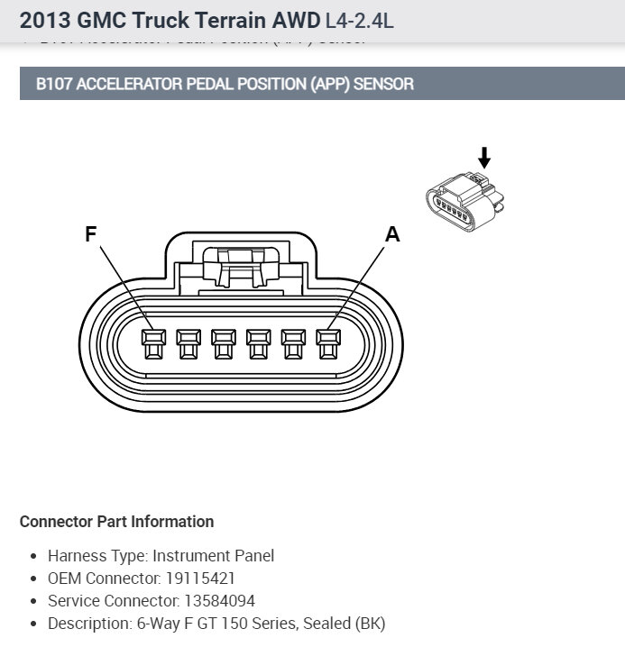

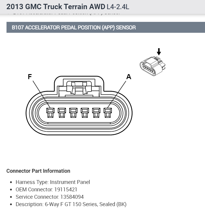

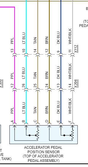

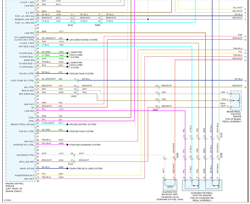

Wires on my car have been cut to the accelerator pedal position sensor and had to get a new connector. I don't know what the 5 wires actually are so how can I connect the connector without knowing the 6-pin wiring diagram.
