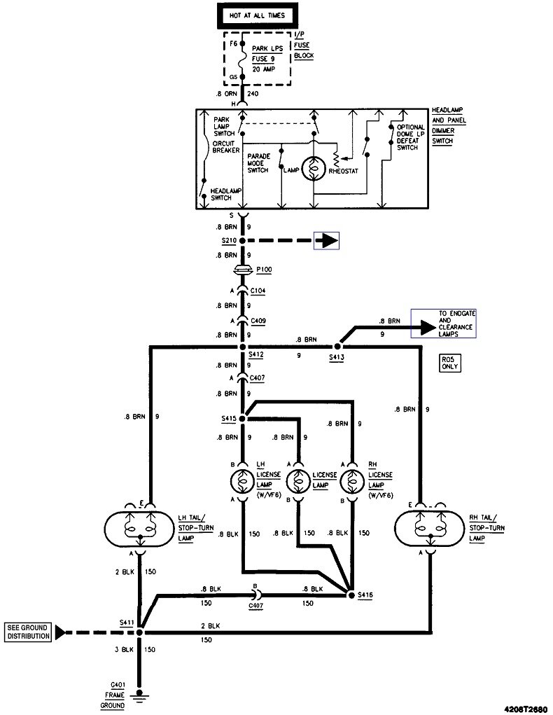

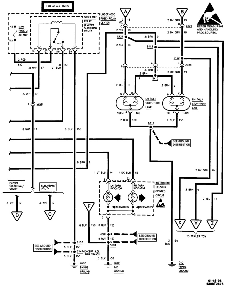

I bought this truck as a project truck and the taillights were torn out. So just looking for a diagram to get new set wired up right. Any help is greatly appreciated.

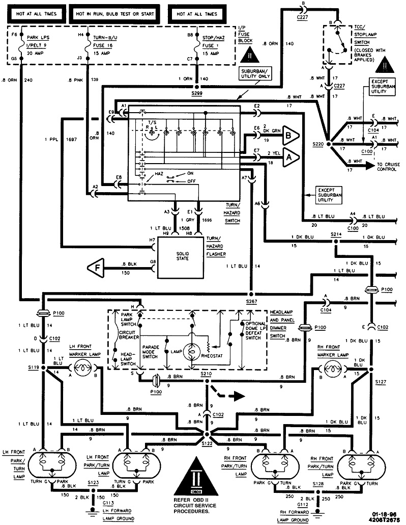

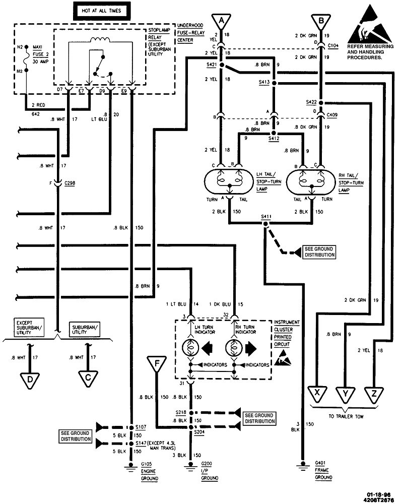

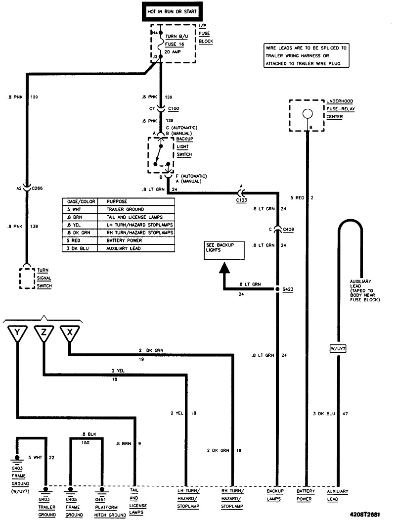

I guessed at a C1500. The diagrams are the same for the "K" series 4-wheel-drive model. These first two are for the signals. Next is the taillights, and the last is for the trailer tow package. If these are too small to read, first try to copy them into a typing program such as MS Word where they can be expanded. I can also cut them into pieces that can be expanded and posted separately if that will help. Let me know if this helps.
