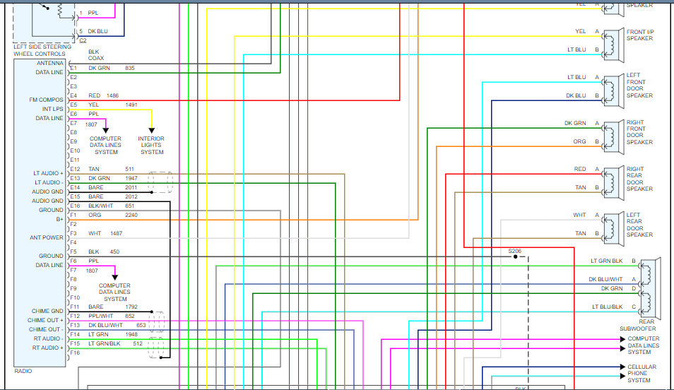

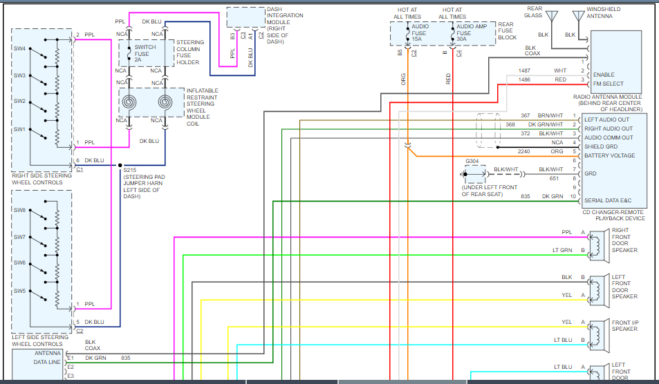

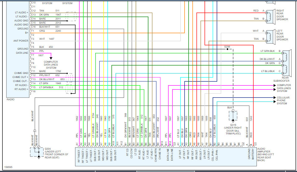

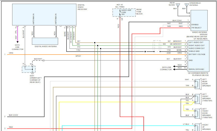

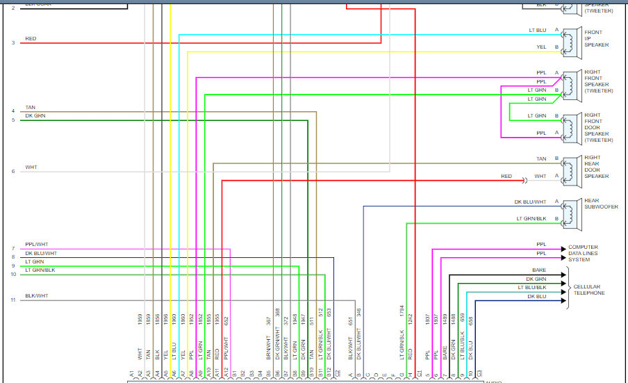

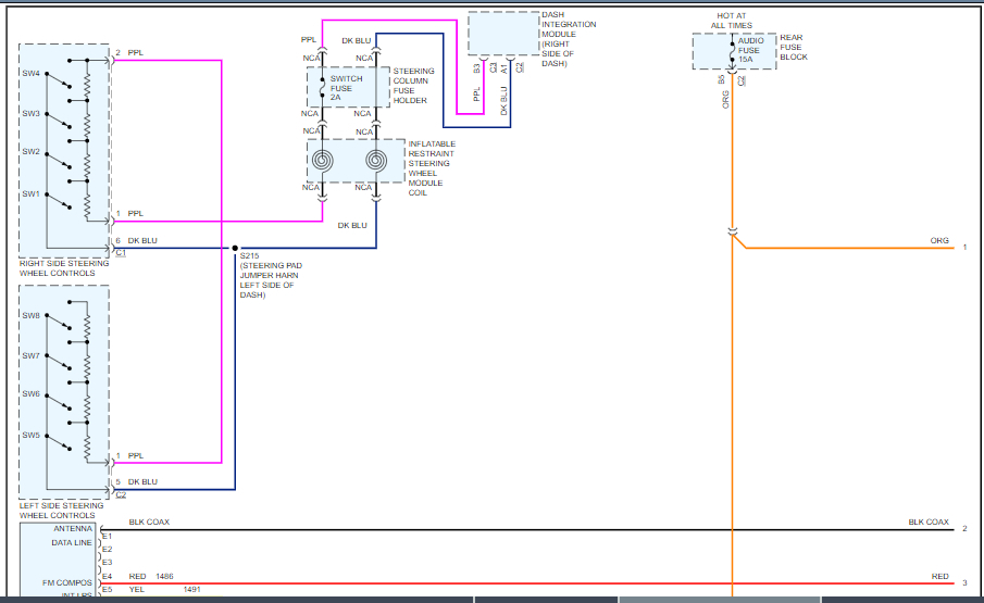

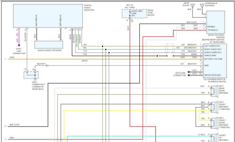

Here is the information you requested. This is an electrical wiring test tutorial for you to view:

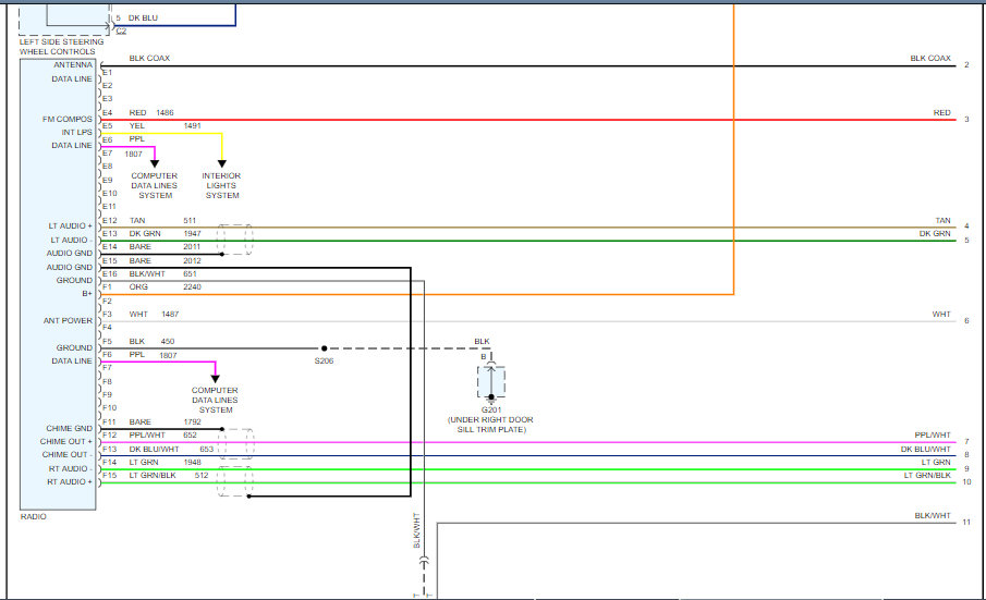

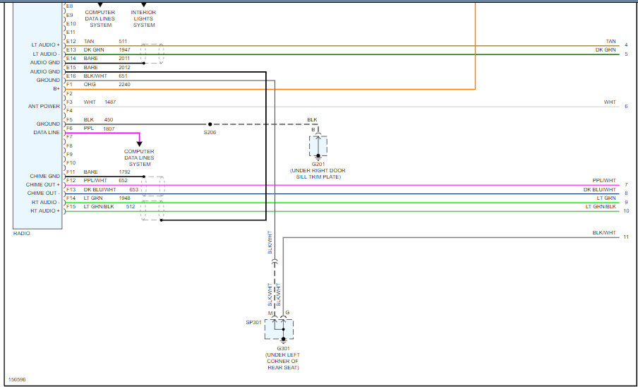

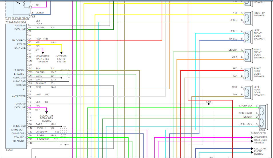

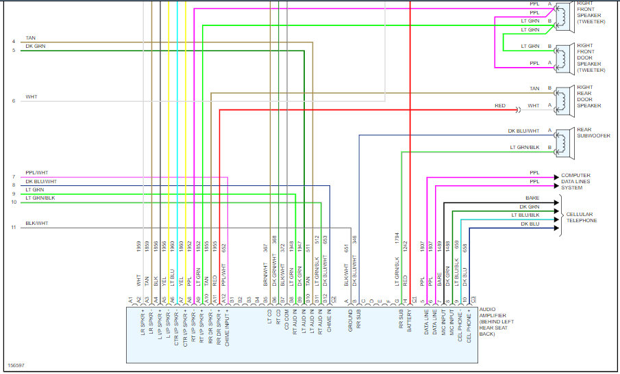

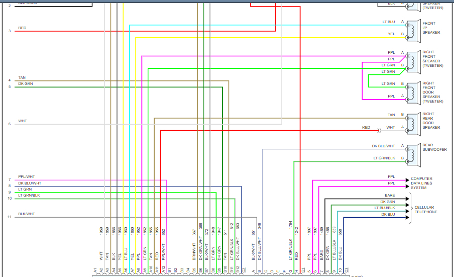

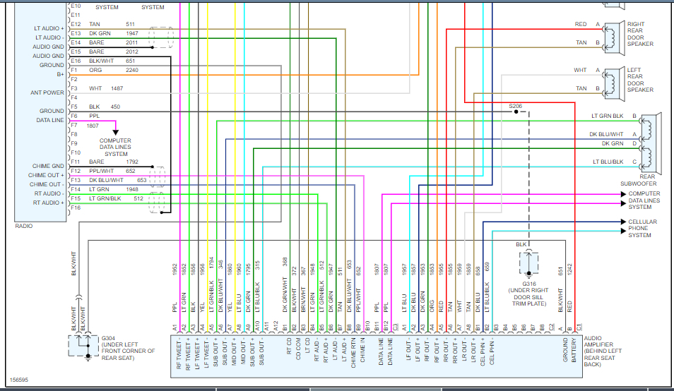

I've attached the radio wiring diagrams below for your car. I've cut the pictures into 3 pieces each so you can view larger. The first 6 pictures are for a Bose equipped audio system and the last 3 pictures are for without Bose system. Hope this helps and thanks for using 2CarPros.
