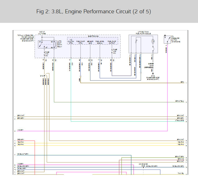

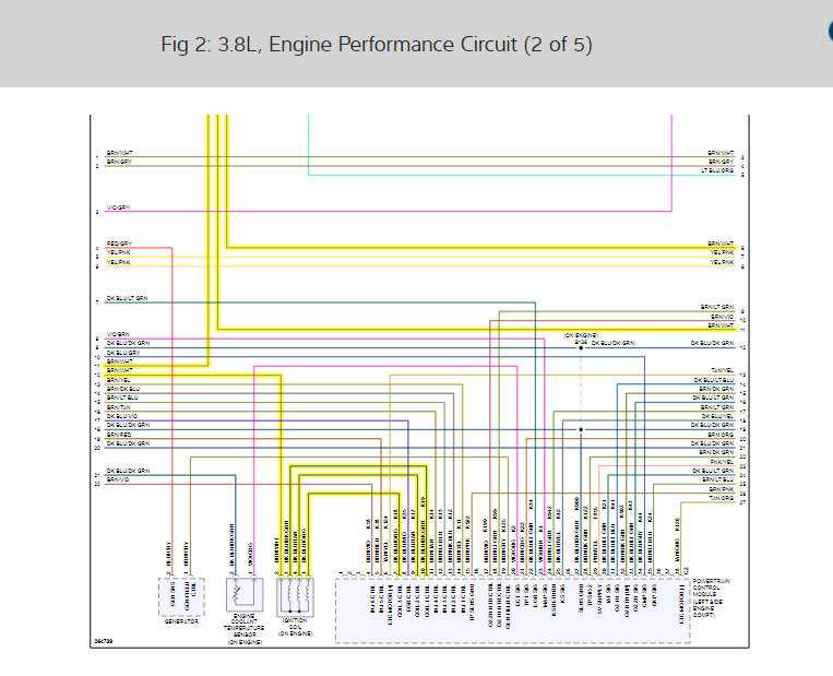

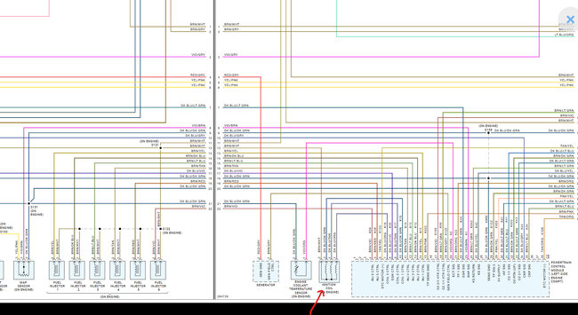

No signal from the PCM to the coil pack for cylinders 2/5. I am looking for a wiring diagram for the PCM to coil pack.
Aug 17, 2019 at 8:53 AM
SCGRANTURISMO
CERTIFIED EXPERT
4,897 POSTS
I have included the information that you requested in the diagrams down below. Please go through this guide and get back to us with what you are able to find out.
