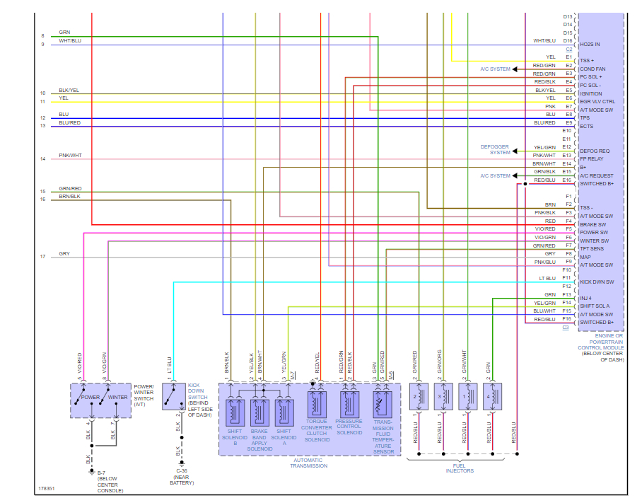

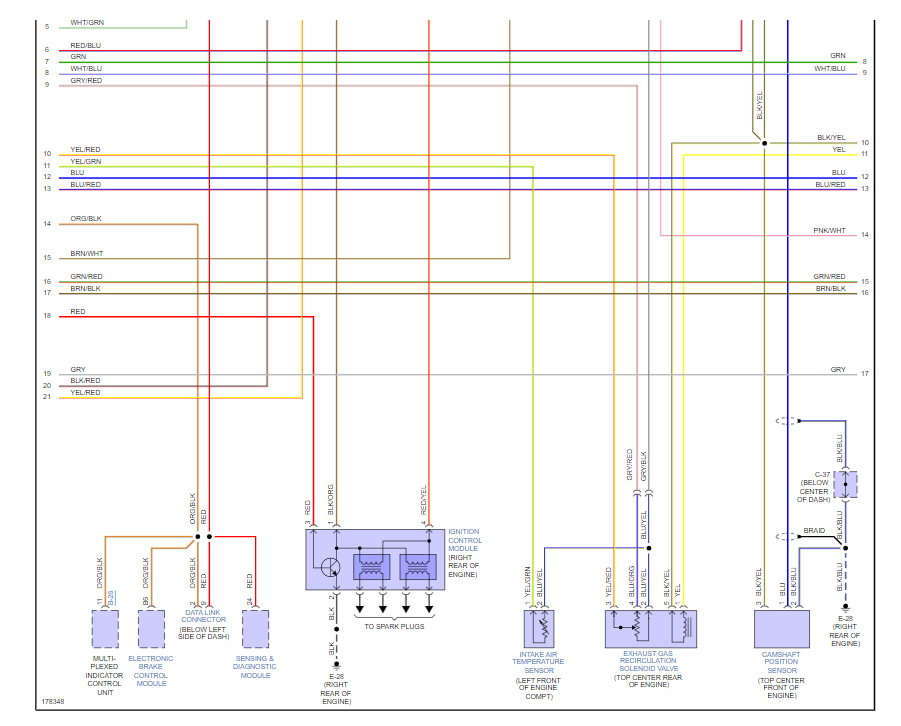

Anyone with a wiring diagram for Isuzu, engine C24SE, KB240 2005 petrol engine?
Aug 18, 2022 at 3:36 AM

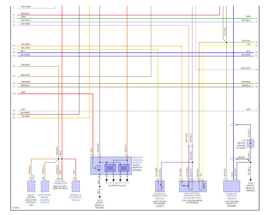

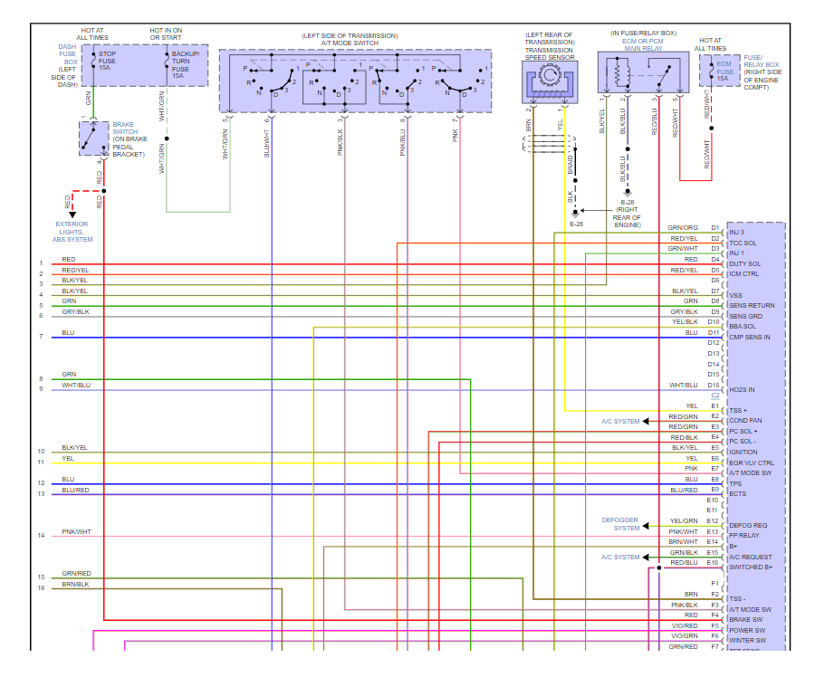

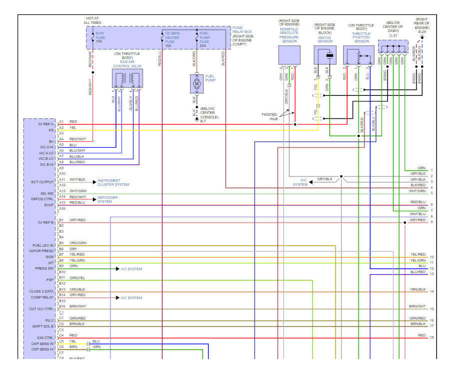

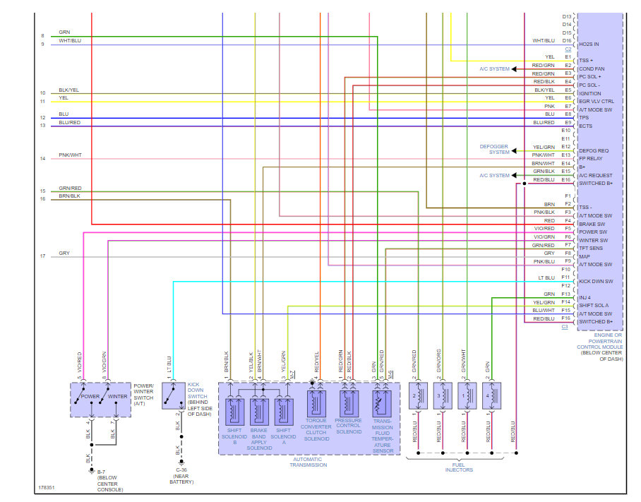

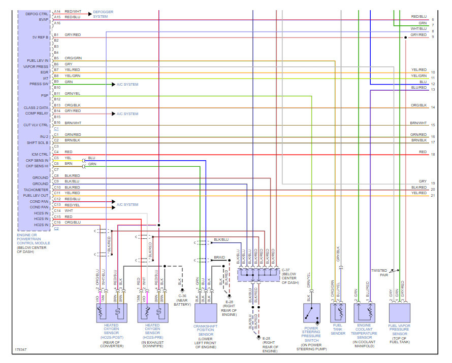

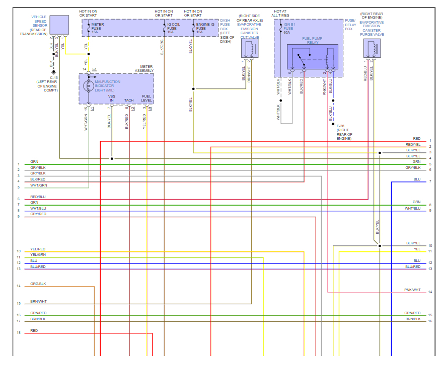

Here are the wiring diagrams they list for a 4 cylinder engine and a guide to help you test the connections:
Check out the diagrams (below). Please let us know what you find.
Aug 18, 2022 at 11:32 AM
