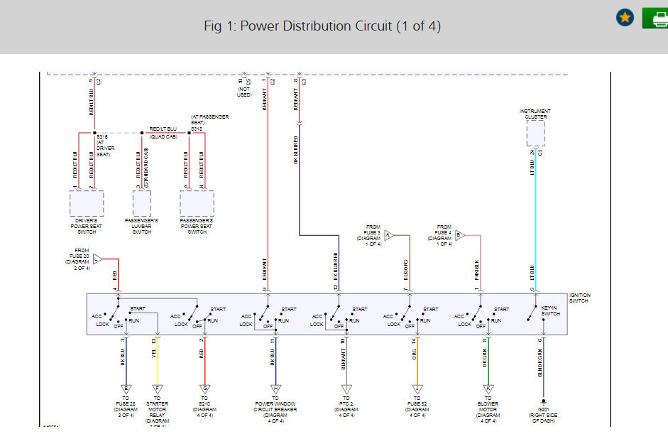

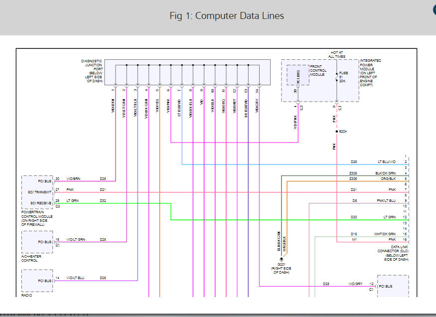

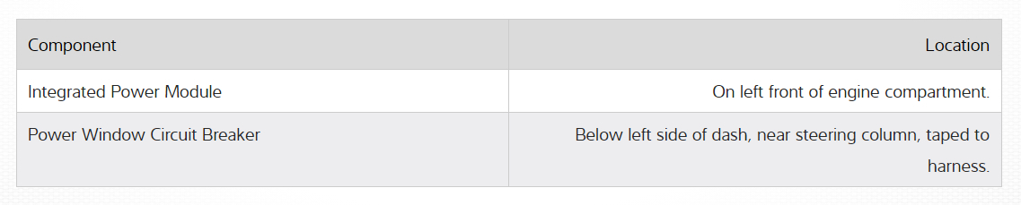

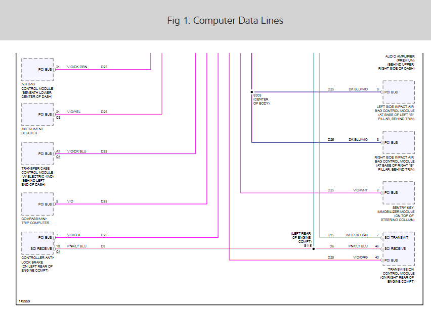

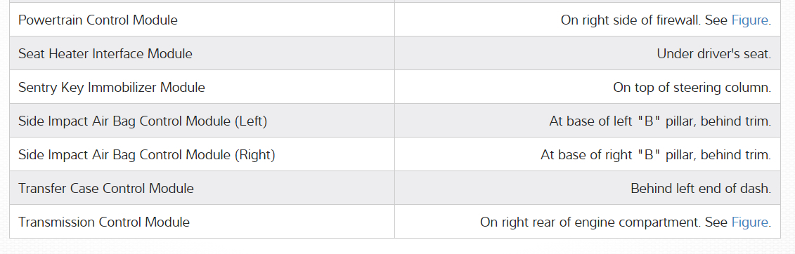

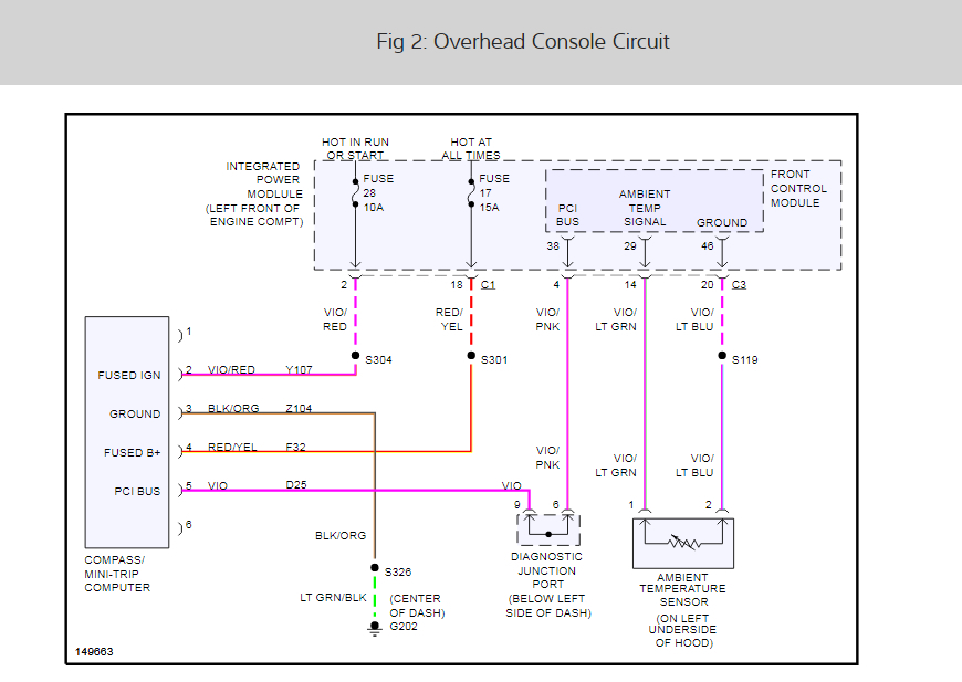

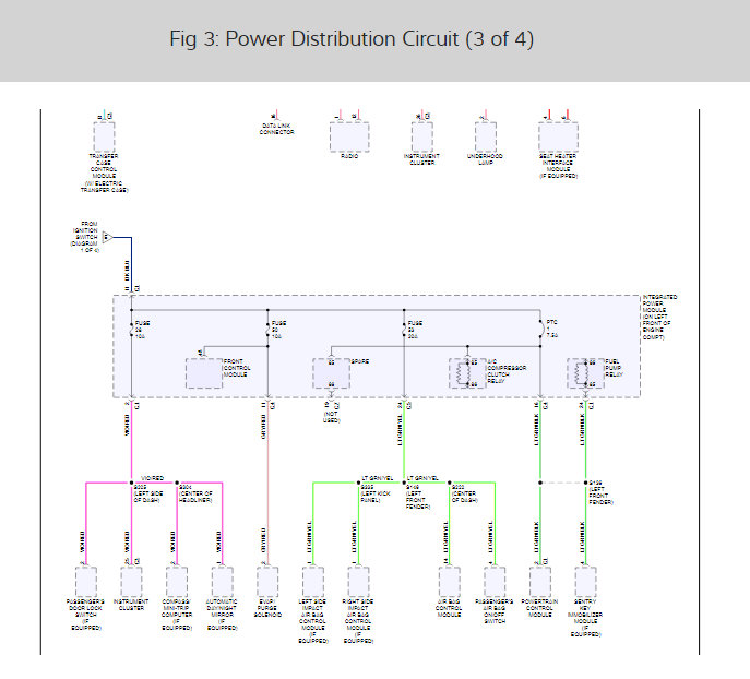

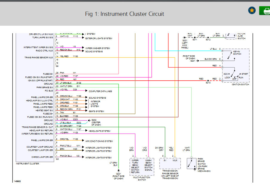

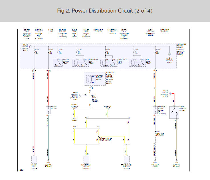

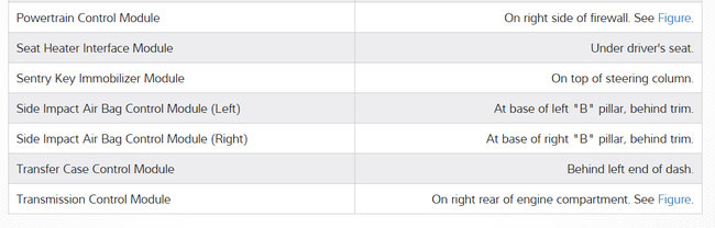

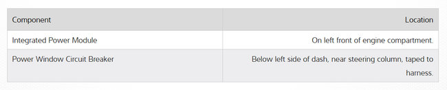

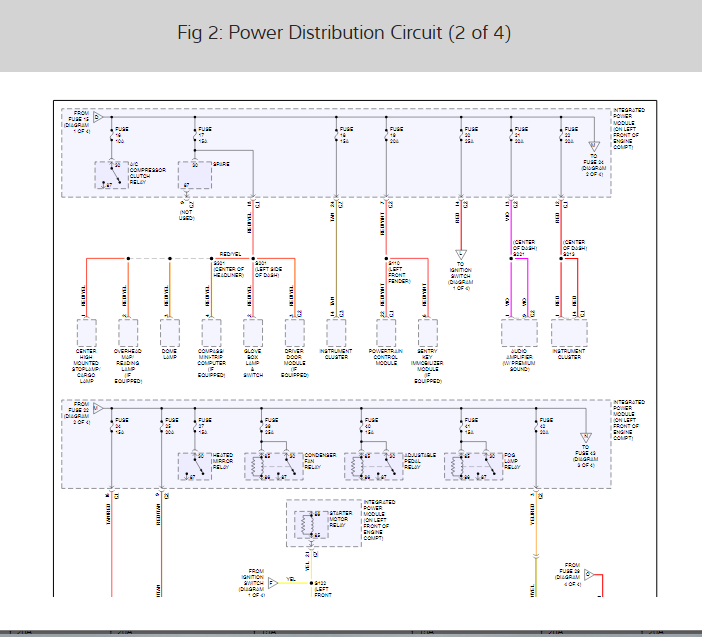

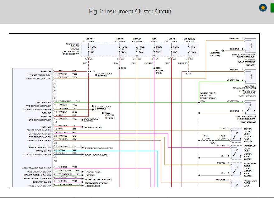

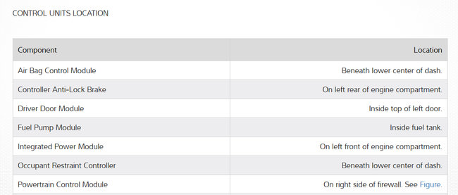

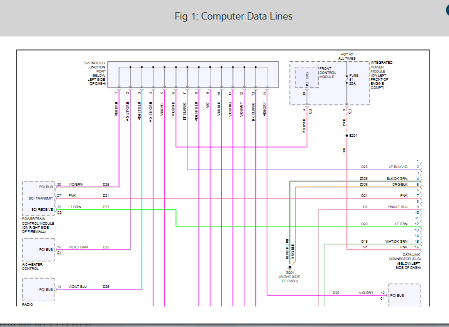

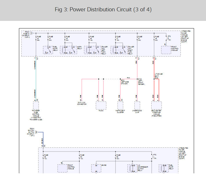

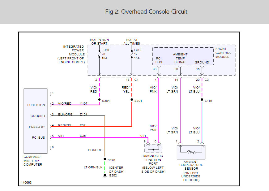

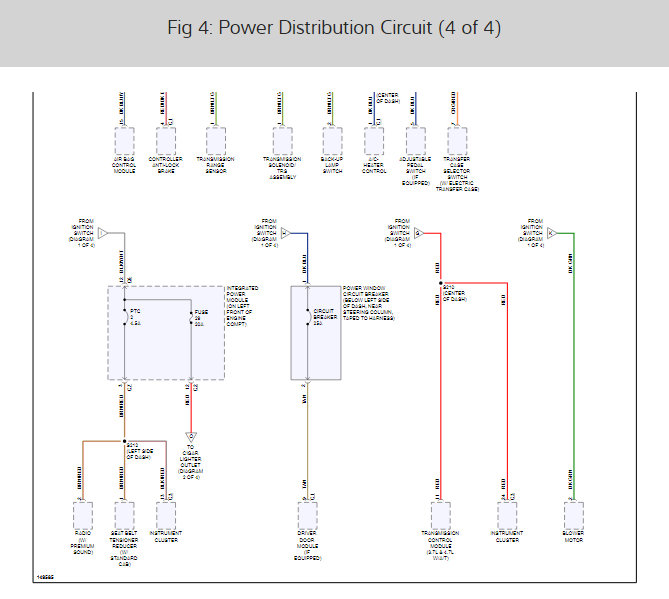

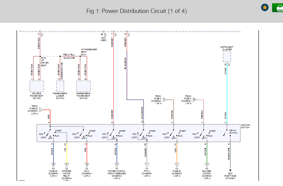

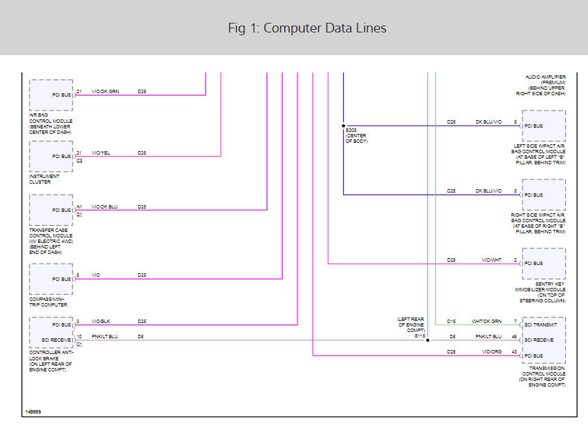

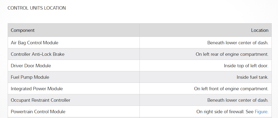

Hi, I am looking for the color codes for the BUS and the other wiring from the computers to the dash and fuse block. Also am looking for where the modules are in the My truck listed above is a 1500 SLT.
