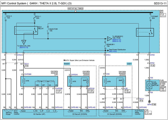

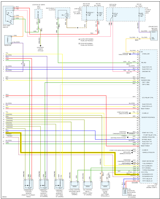

I need a color code wiring harness diagram for the car listed above.
Jun 28, 2023 at 2:26 PM
MATHGEN
  • 128 POSTS
Here you go. I hope these work for you. Let me know if you need any further assistance.

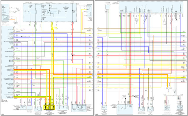

Can't read what's what on it.
Jun 28, 2023 at 7:03 PM
WOLFE4537
  • 5 POSTS
is there any way i can get it clear?
i can't make out any of the writing on it even on a pc.
Jun 28, 2023 at 7:18 PM
MATHGEN
  • 128 POSTS

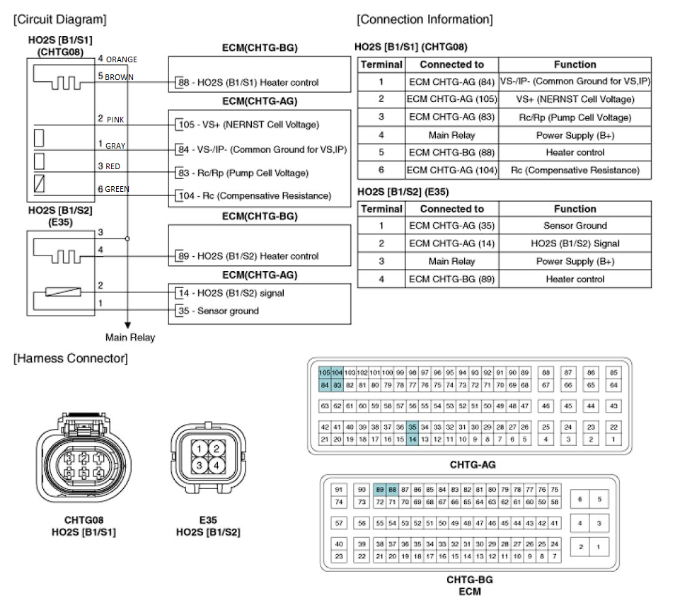

Sorry about that. These look better on my end. Let me know if they are okay.
Jun 29, 2023 at 5:15 AM
WOLFE4537
  • 5 POSTS

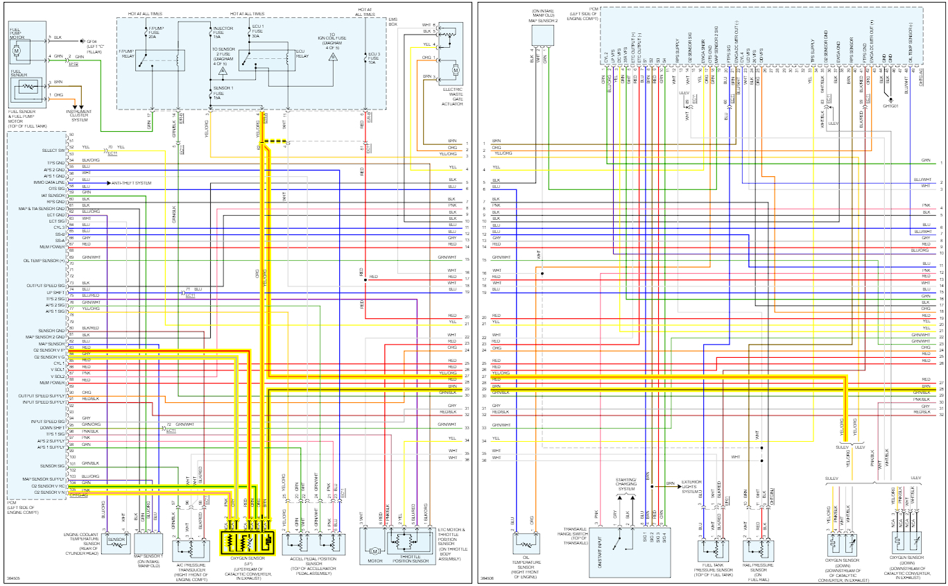

The lower one was the one I have, it would have been perfected but it does not give you the colors of the line. And you can't back track the wire to the harness because you can't take apart the ECM wiring harness to see what the color of the wire is.
Jun 29, 2023 at 5:21 AM
MATHGEN
  • 128 POSTS
I updated the image to add the wire colors. I hope this is what you need.
Jun 29, 2023 at 8:39 AM
WOLFE4537
  • 5 POSTS
Thank you so much, you're amazing.
