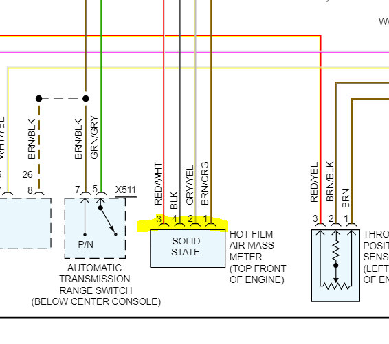

The plastic connector broke and I purchased a new one. Now I need where to place the four wires.

For some reason, the connector itself isn't provided in my manuals. I did find the wire colors at the sensor. See pic 1 below.
Let me know if that helps at all.
joe
See pic below.

This is helpful. Thank you.
