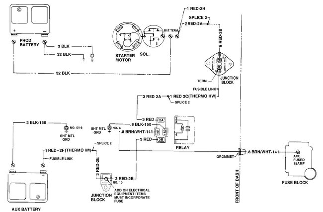

I was able to track down a wiring harness that should work. Some related electrical questions though: I'd like to replace the stock battery cables with some bigger gauge cables that attach to posts rather than the screw-in type stock cables. I'm thinking 02 gauge, will that be okay? Can you tell me what the little pigtail wires are for on each of the stock cables? And, can you also tell me where the red cable attaches to coming off of the battery?

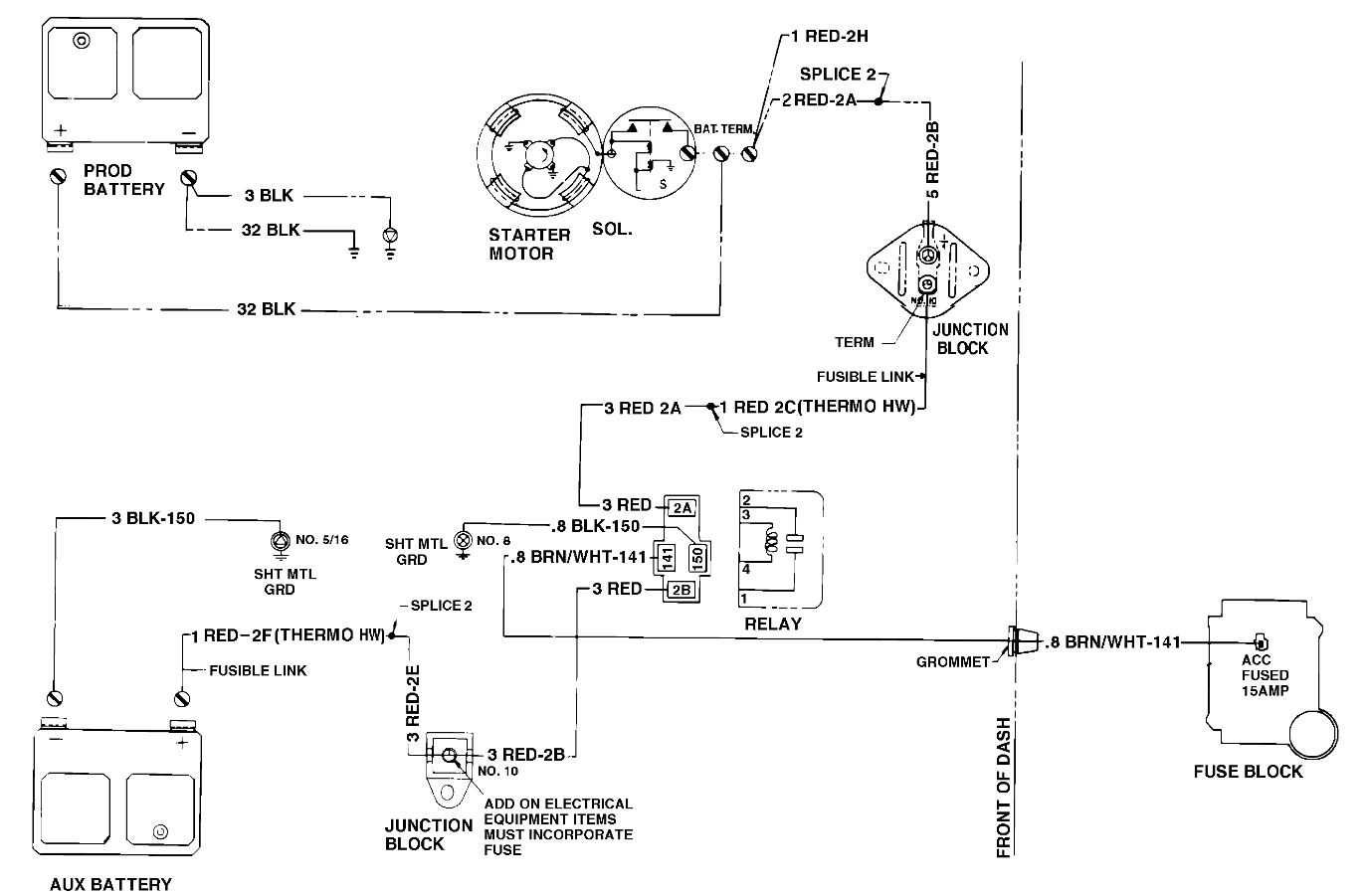

Bigger cables are not a bad idea but not really needed unless you are seeing voltage issues when starting. If possible just buy premade cables and install those, the clamp styles are available in many places. The smaller wires feed different things depending on the options. On the ground side they connect to the chassis. The battery feed should connect to the starter motor main terminal, with that having a jumper connection to the junction connector on the firewall and from that to the fuse panel. The attached is the wiring for the optional dual battery system. The relay acts to allow charging when the engine is running but disconnects the battery for starting. It basically splits the system so the main battery powers the starter and the auxiliary runs lights, winches and other loads.
