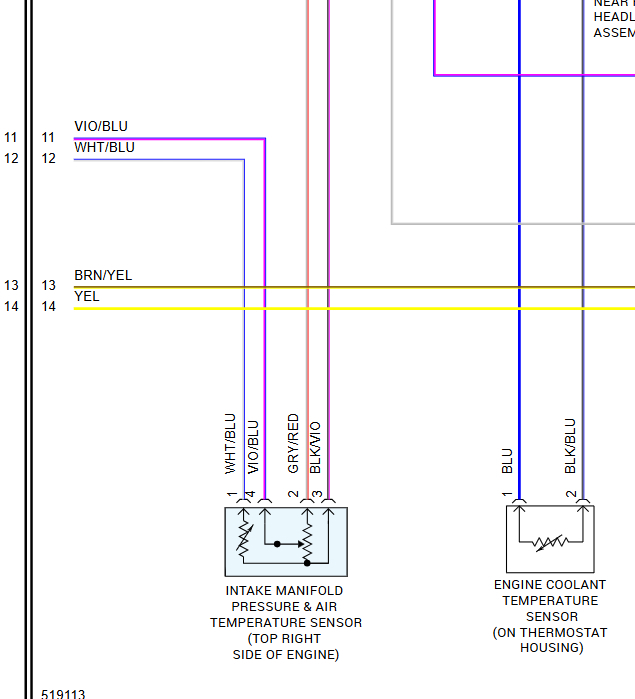

Air mass sensor wiring harness diagram
Apr 11, 2026 at 12:53 PM
CERTIFIED EXPERT
53,855 POSTS

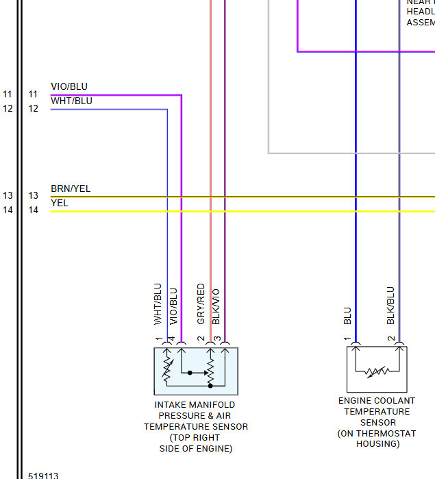

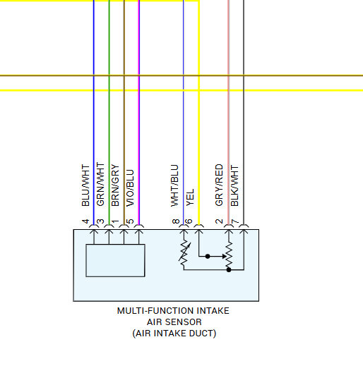

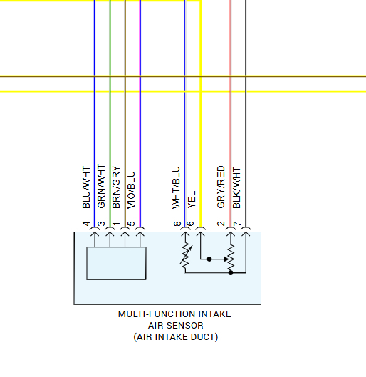

This car does not have a MAF sensor it has an intake manifold pressure sensor and a multi function intake air sensor. Here are the wiring diagrams for both. Check out the images (below). Let us know if you need anything else. Ken
