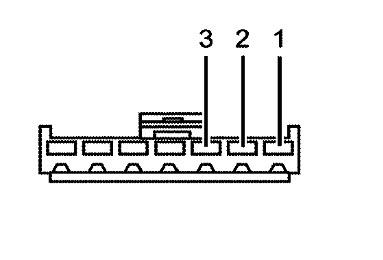

there has to be a connector and not just bare wires.there may be 3wires hanging dow or a connector like shown in pic.it can be either an automatic dimming mirror or a electronic compass mirror you will need to know the code for that which a dealer at parts counter can give you.
