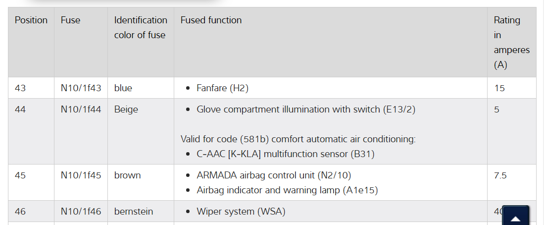

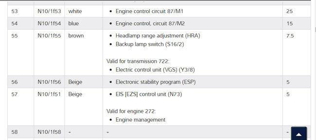

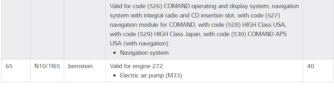

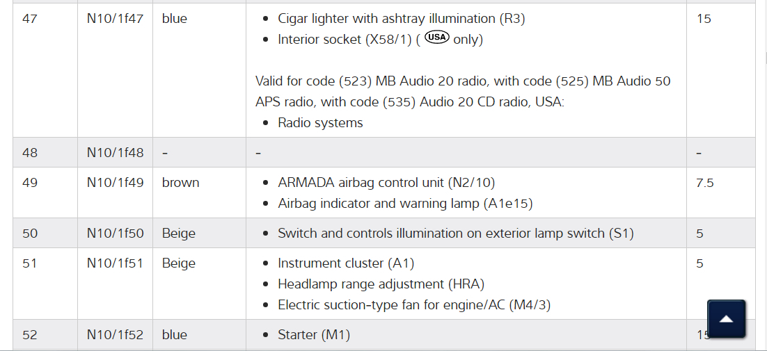

SCGRANTURISMO
  • 4,897 POSTS

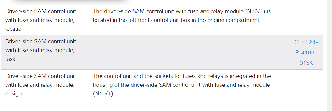

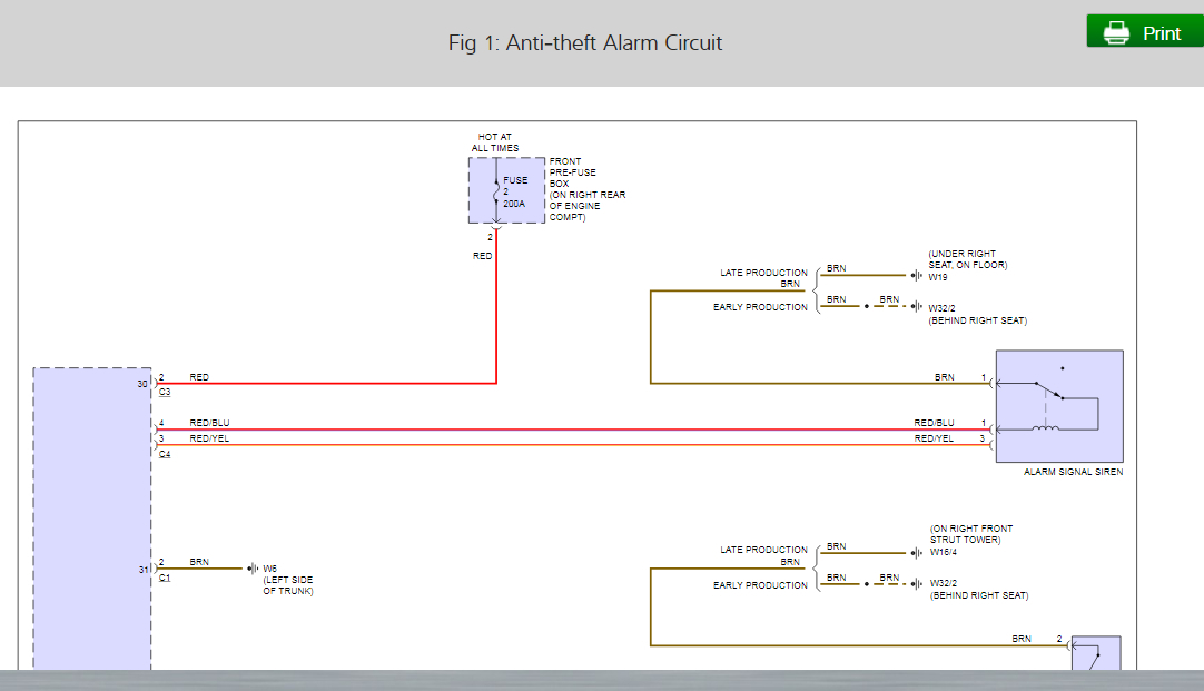

Hello again,

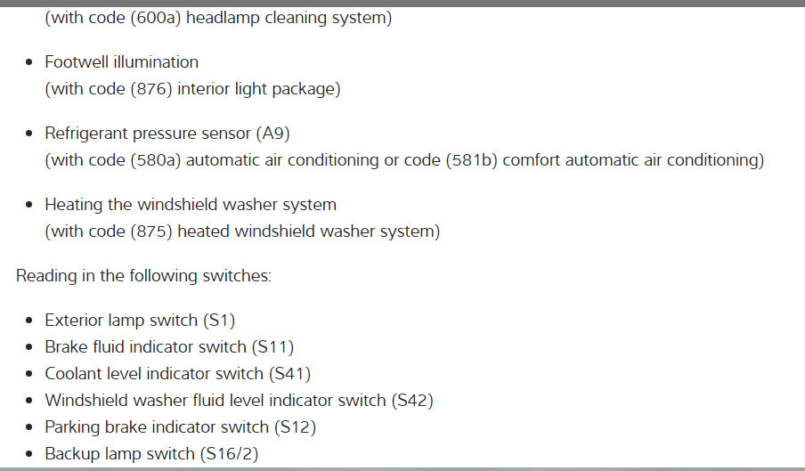

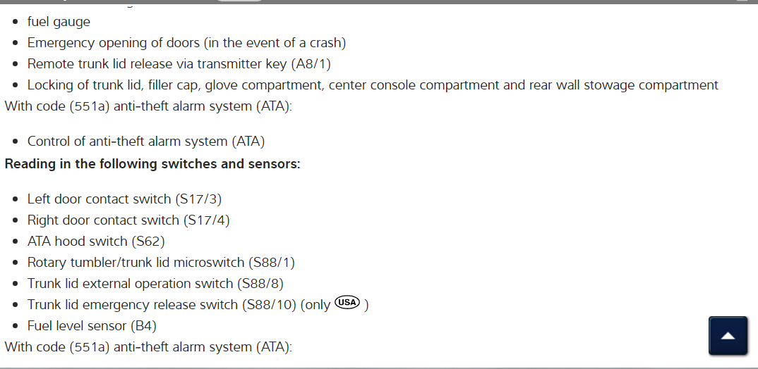

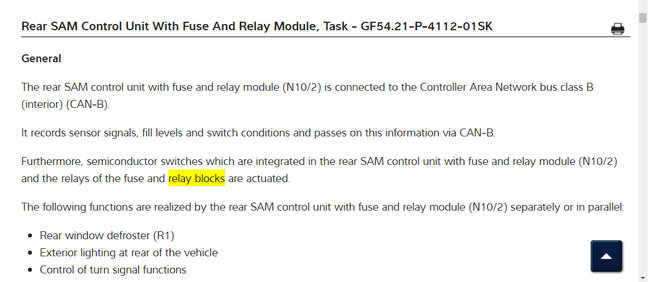

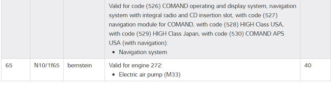

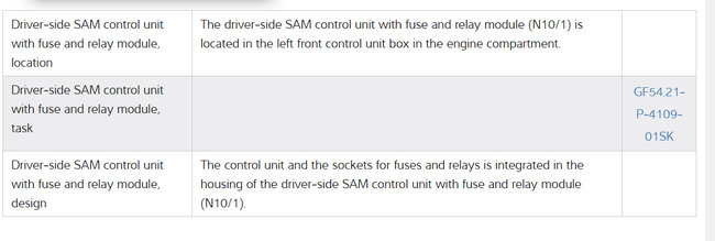

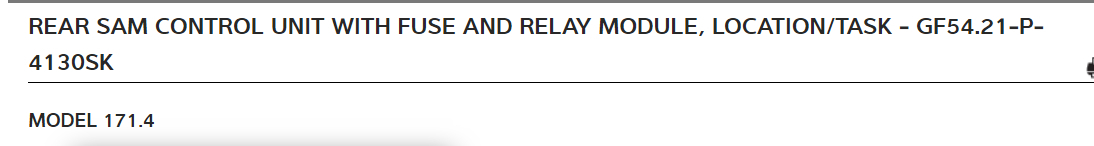

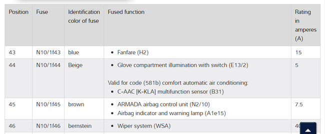

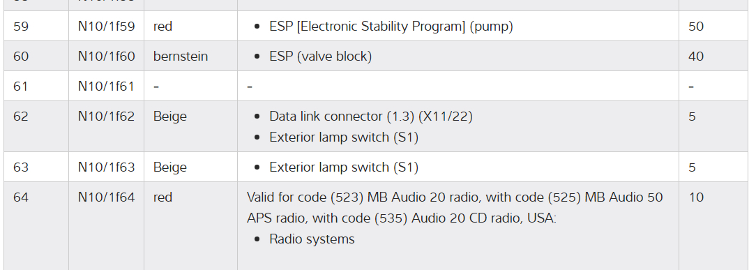

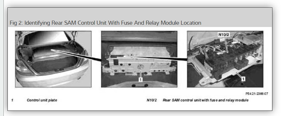

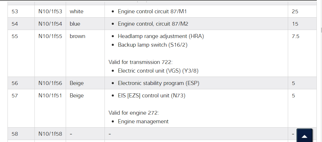

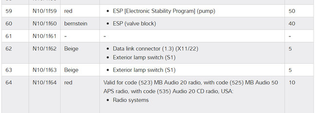

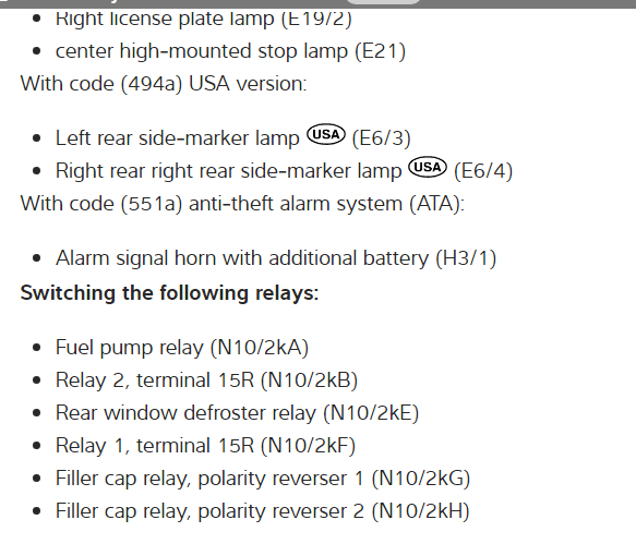

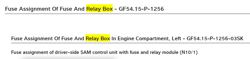

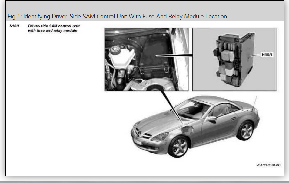

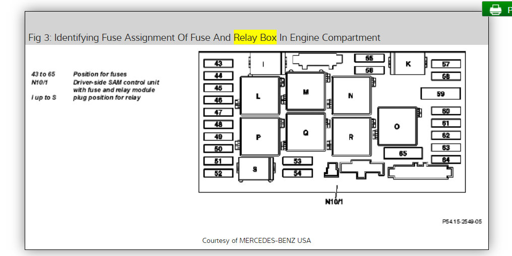

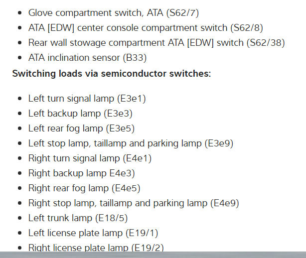

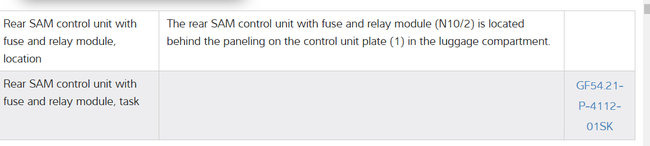

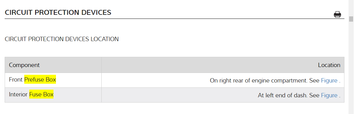

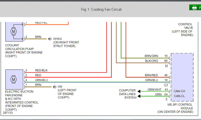

Okay, here is a sample of some Circuit Protection (Fuse Panels) from the closest vehicle I could come to yours. It is from a 2006 Mercedes Benz SLK280 with a 3.0L engine and an automatic transmission. Please compare these to what you have in your vehicle and get back to us with what you find out. There's a ton more stuff, this is just a sample for comparison.
Thanks,
Alex
2CarPros
Apr 26, 2019 at 10:18 PM
ROMANSING
  • 8 POSTS
Hi Alex,
Looks pretty much the same. Can you tell me how to test the harness between the ECU connector and the each of the sensors/actuators? And have you got the wiring diagram for the harness? Cheers
Suki

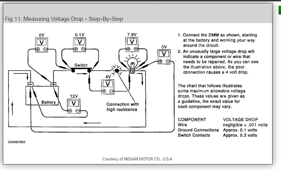

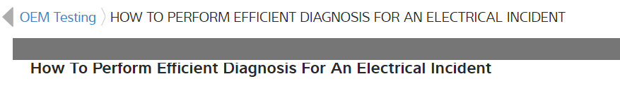

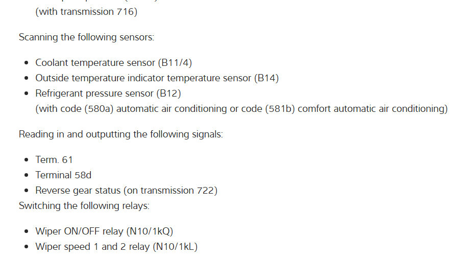

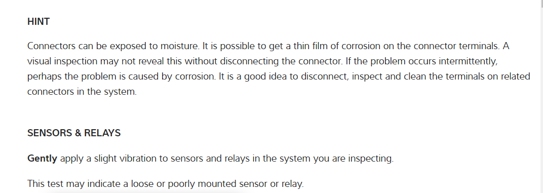

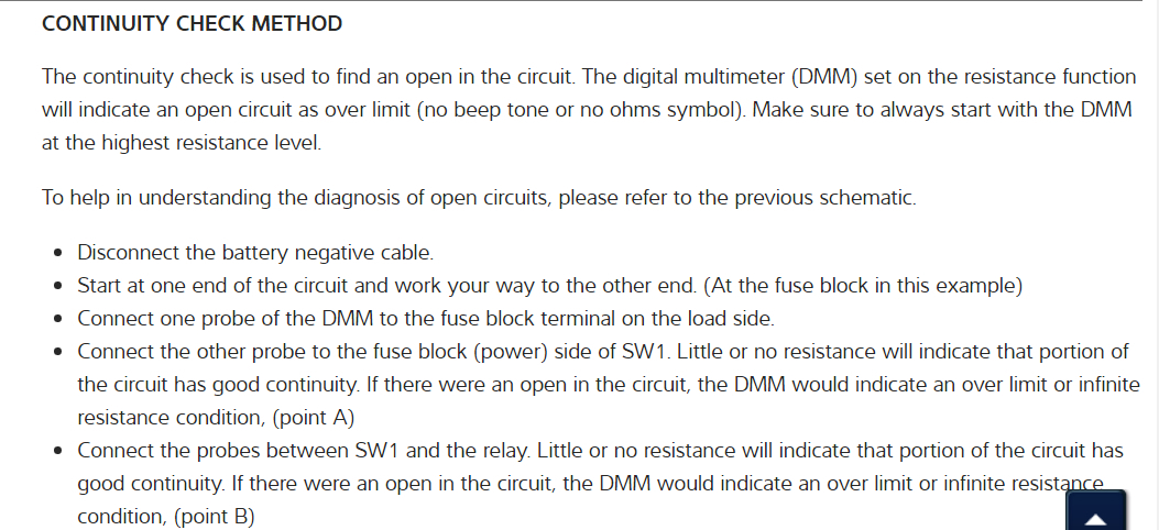

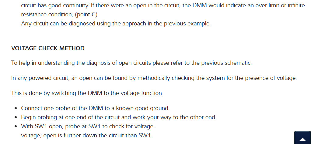

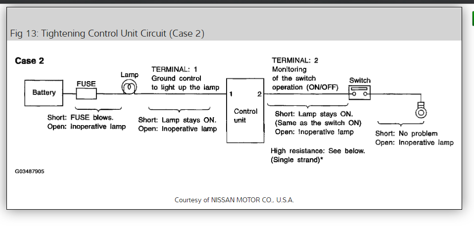

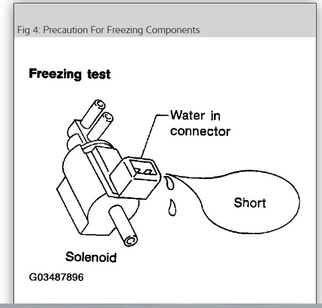

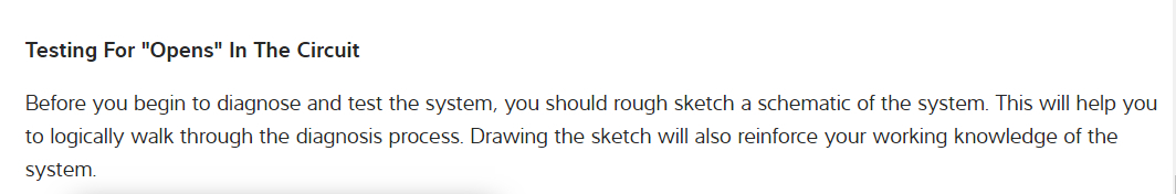

SCGRANTURISMO
  • 4,897 POSTS

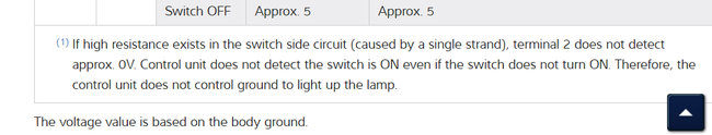

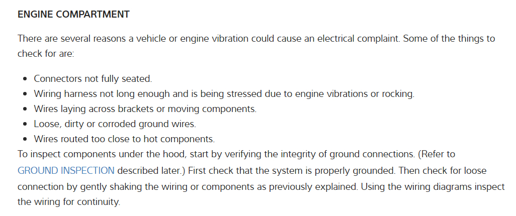

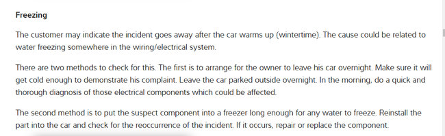

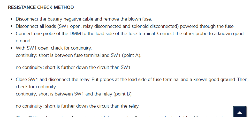

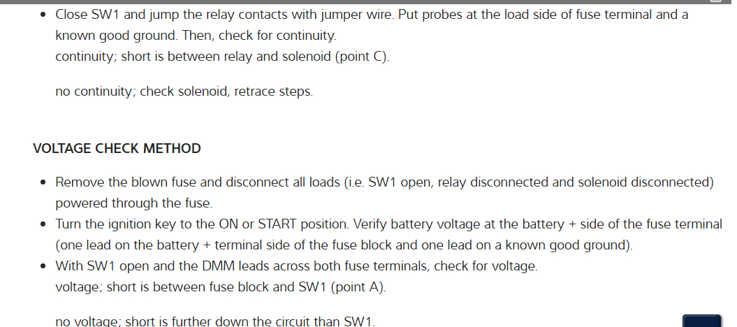

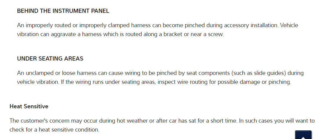

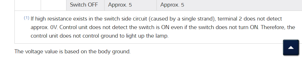

Hello again,

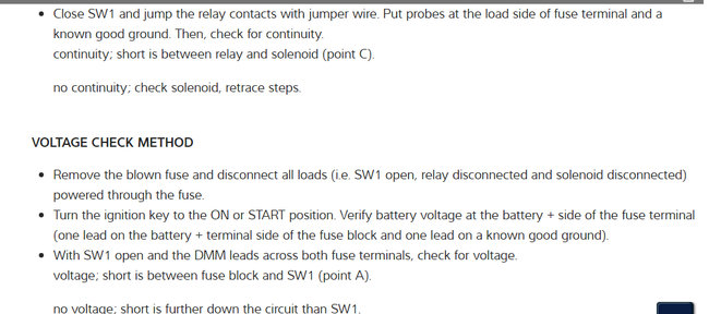

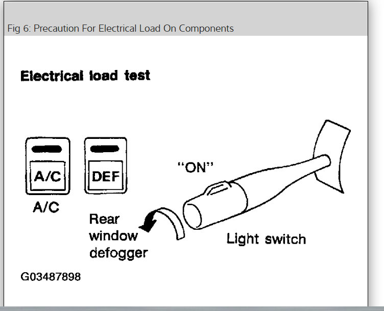

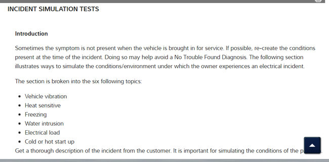

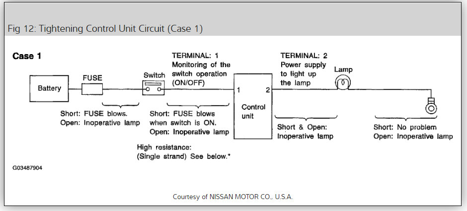

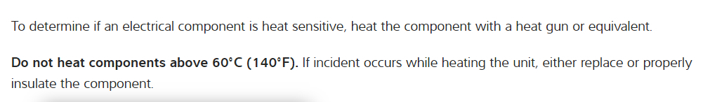

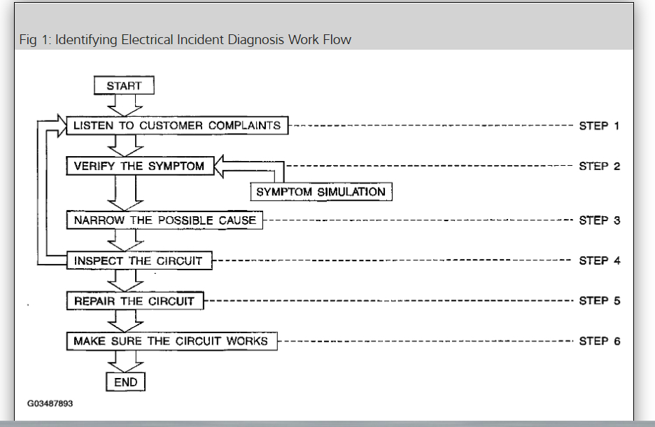

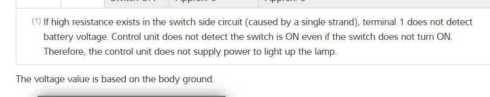

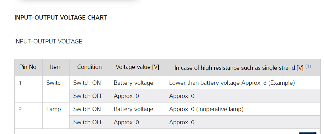

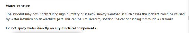

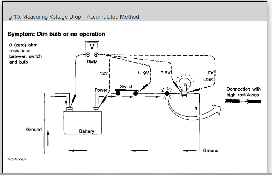

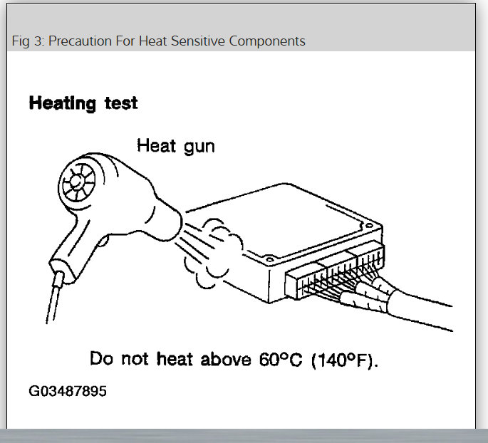

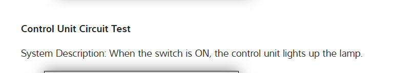

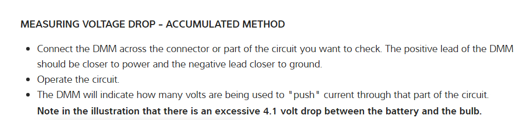

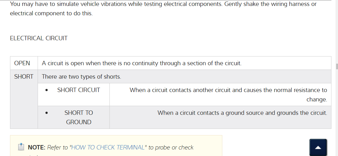

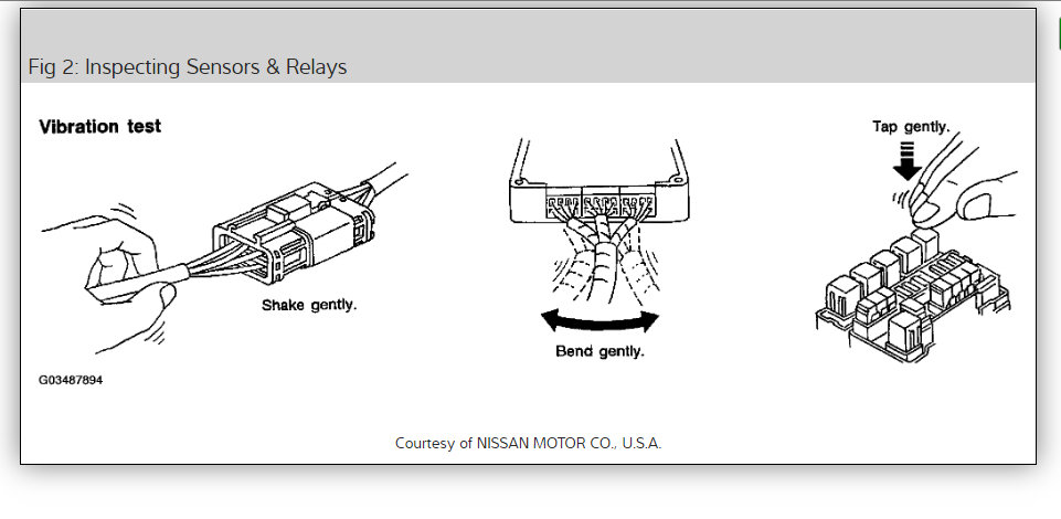

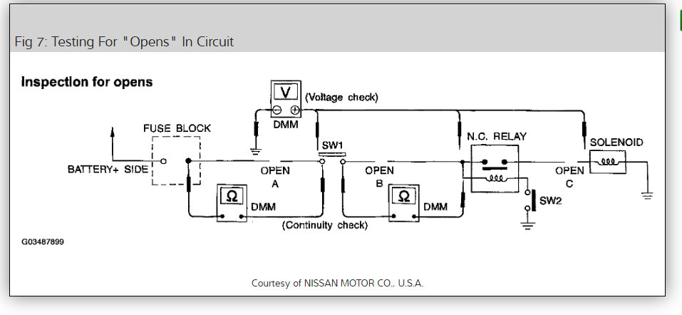

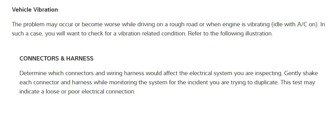

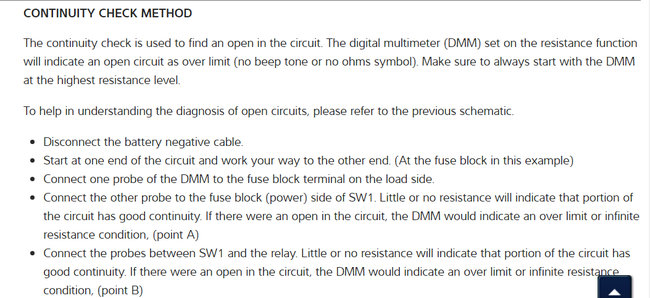

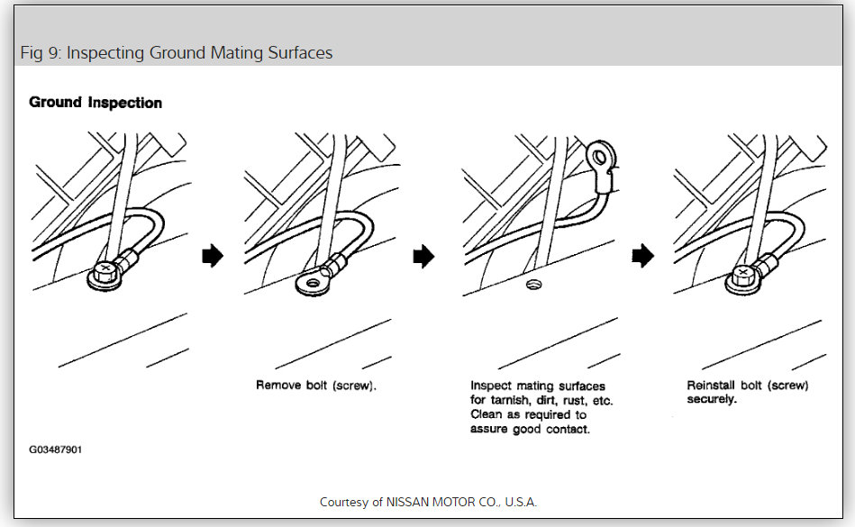

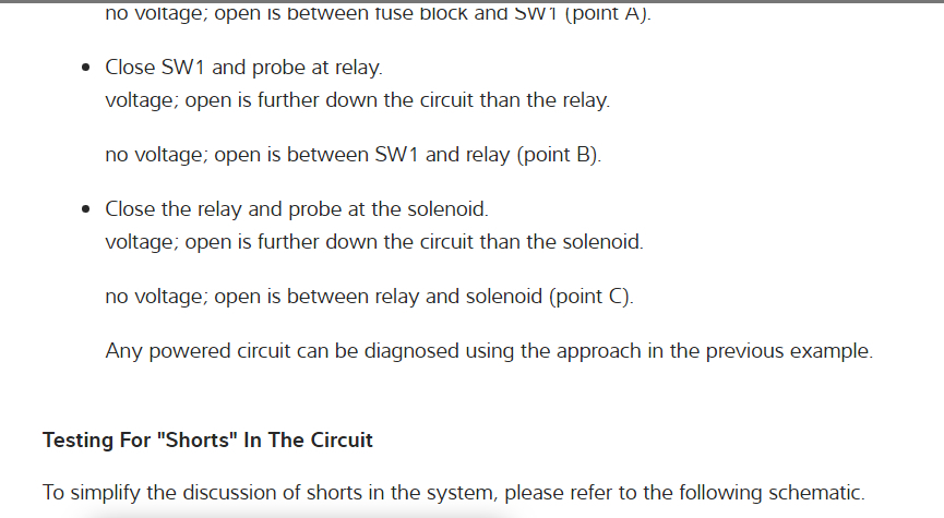

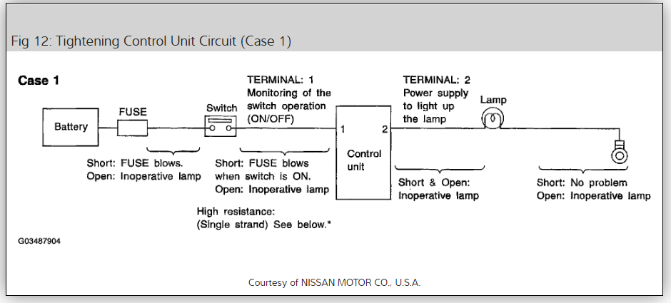

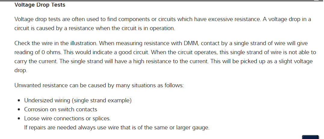

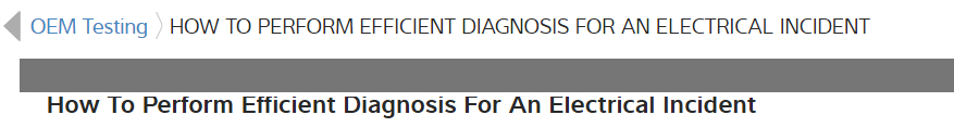

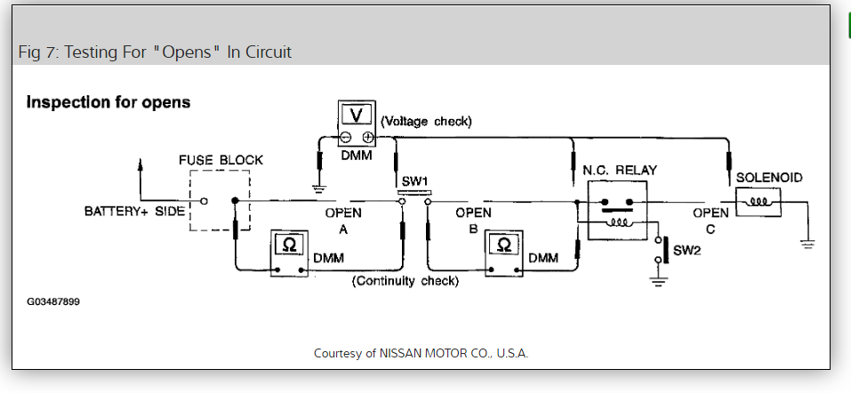

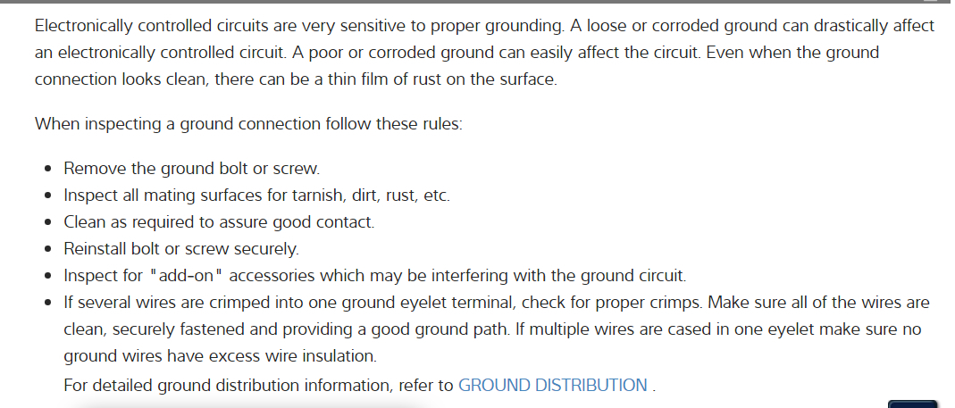

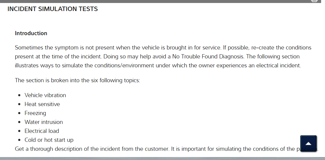

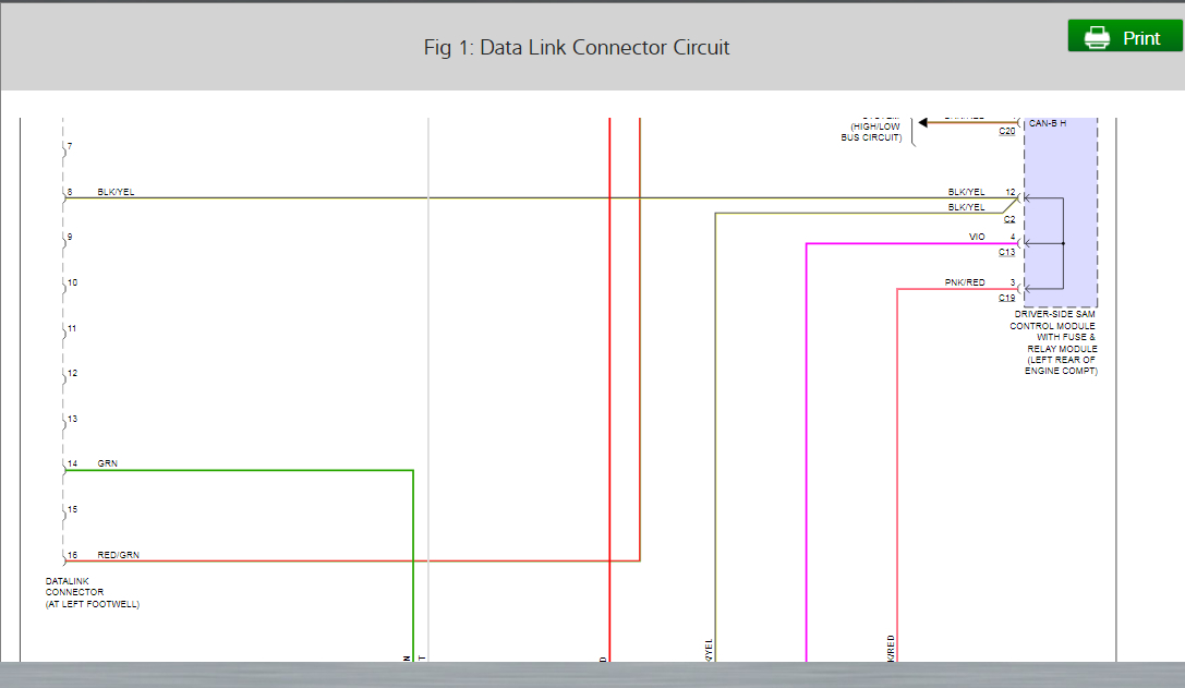

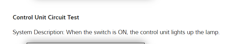

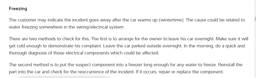

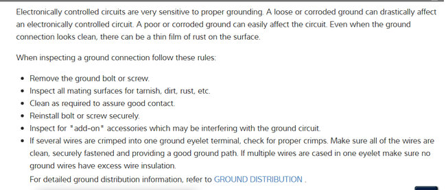

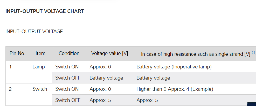

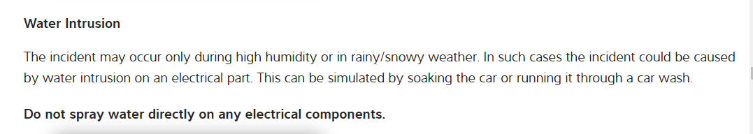

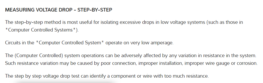

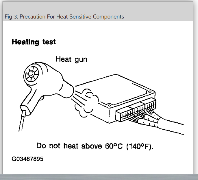

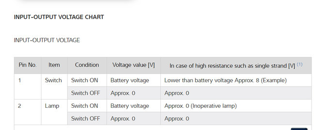

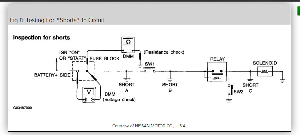

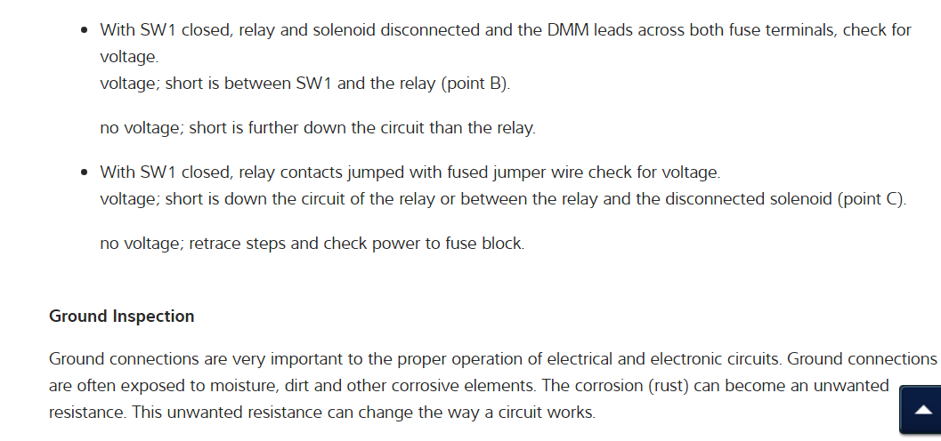

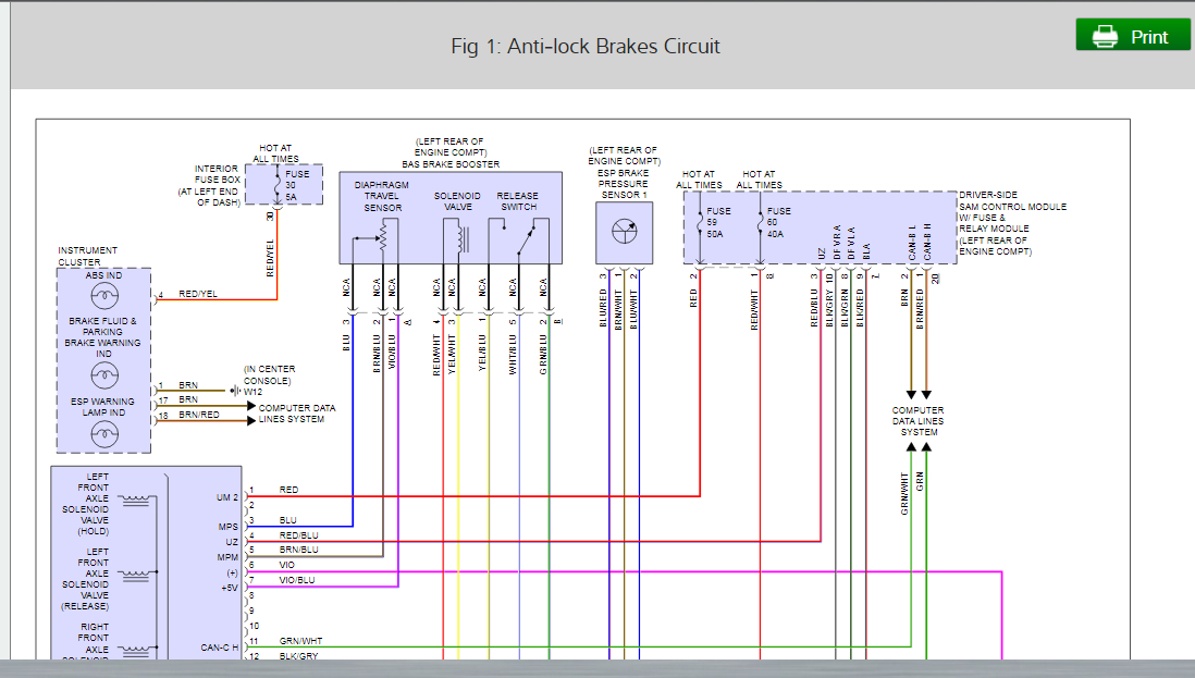

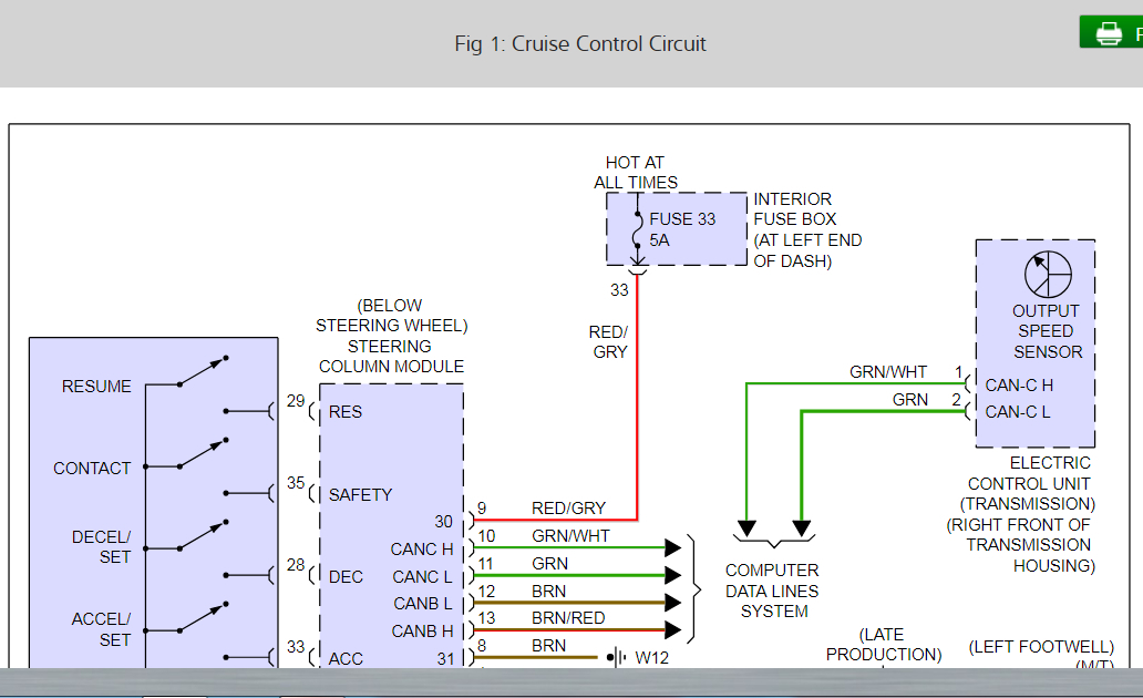

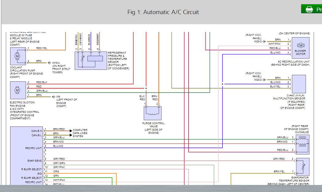

Okay Suki, there is going to be a lot of information here so we will have to do this in sets of diagrams. Here is your first set. It is instructions on how to properly test wires complete with do and don'ts and best techniques for testing them. The next set of diagrams will follow shortly.
Thanks,
Alex
2CarPros

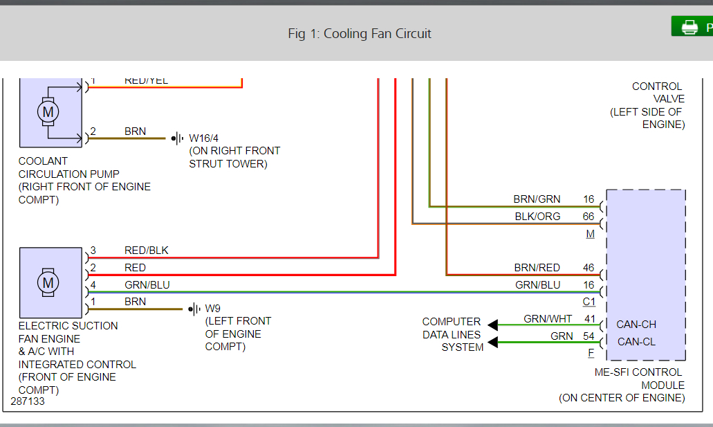

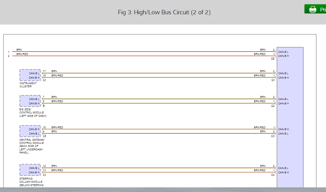

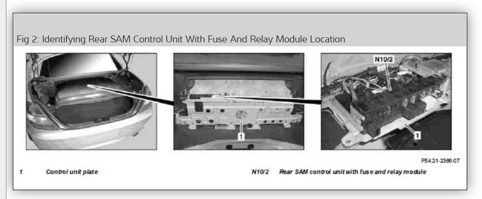

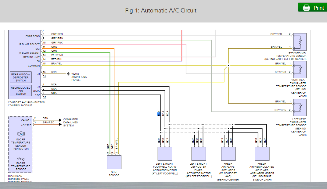

Apr 29, 2019 at 2:07 PM

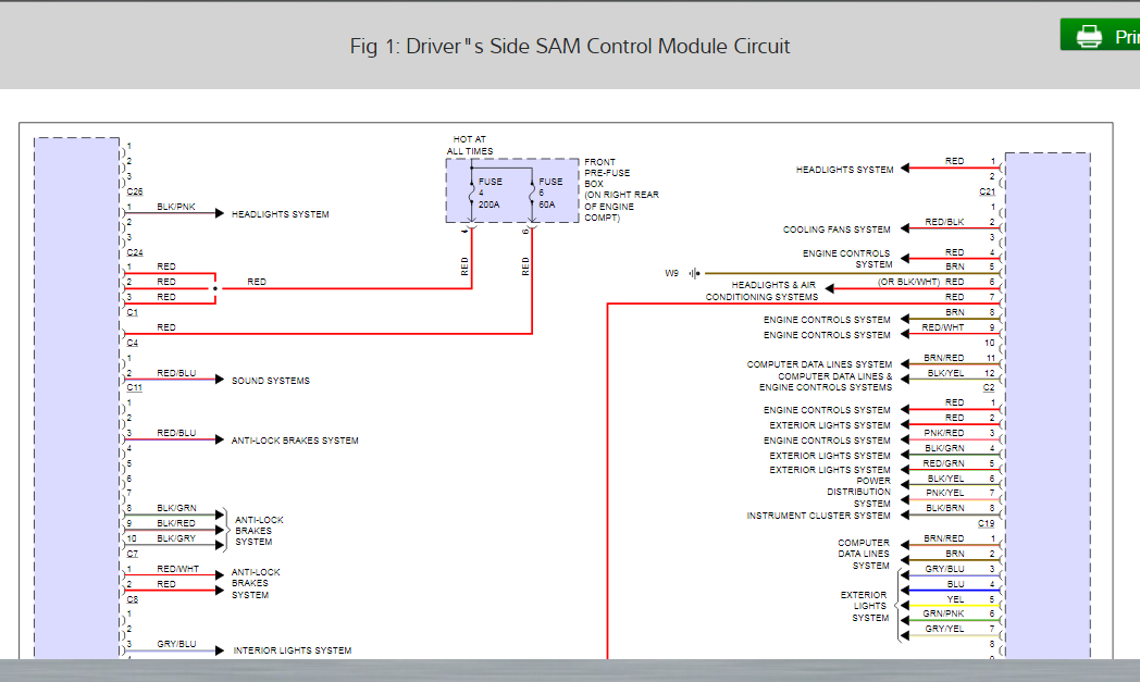

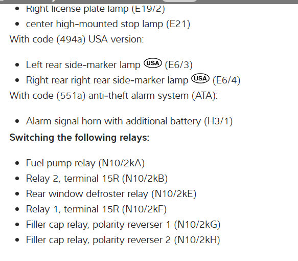

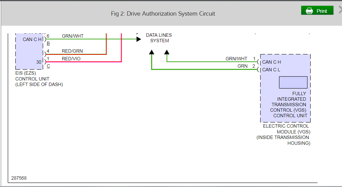

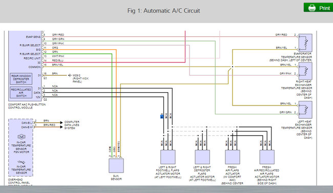

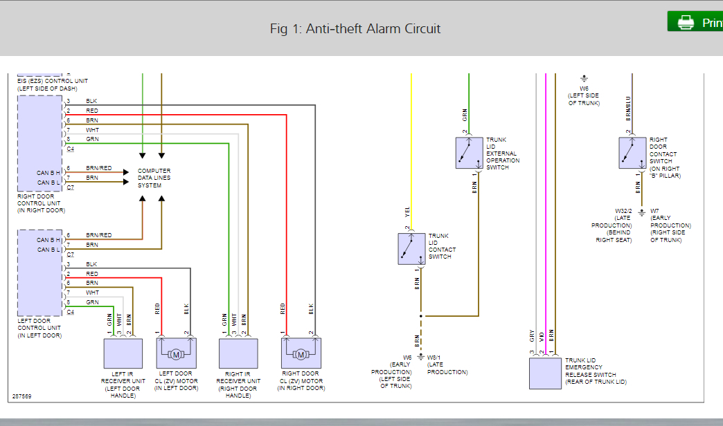

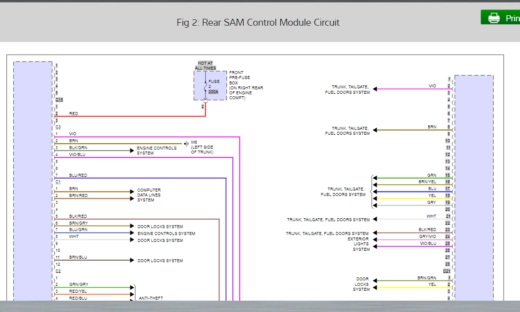

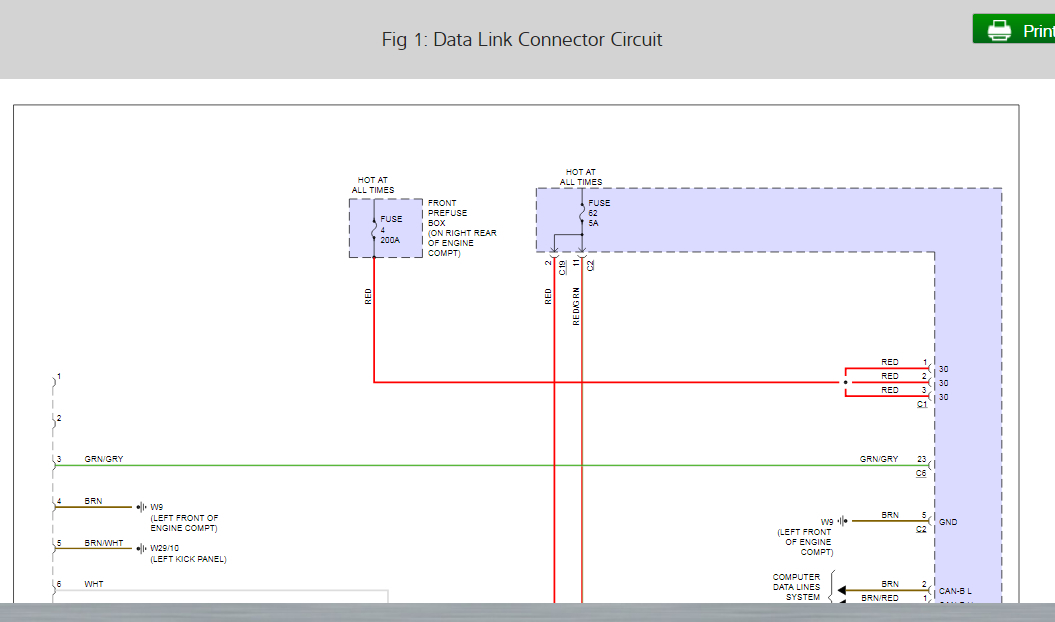

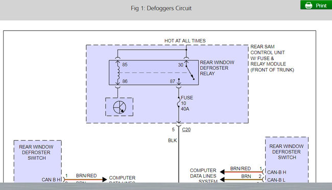

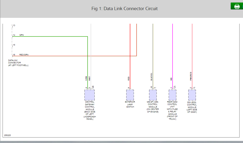

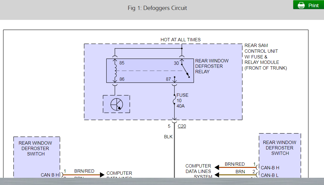

SCGRANTURISMO
  • 4,897 POSTS

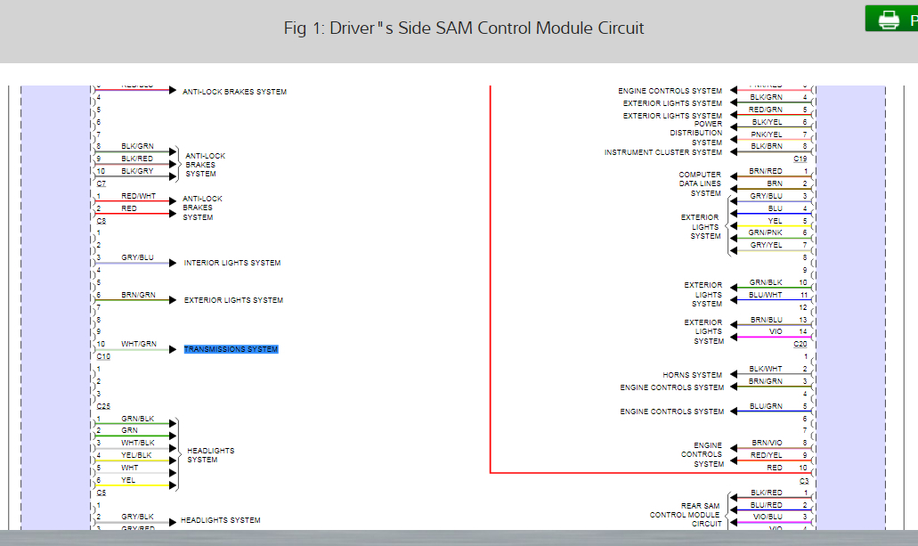

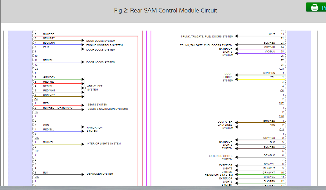

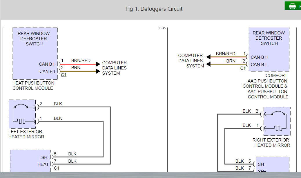

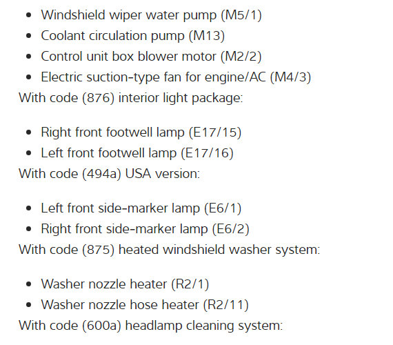

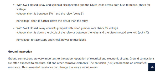

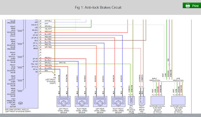

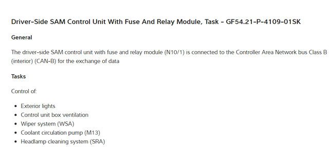

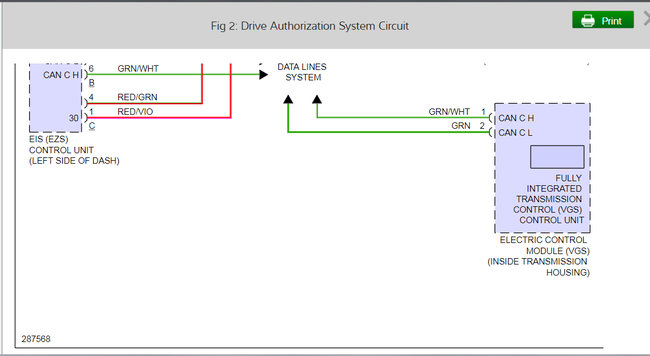

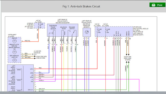

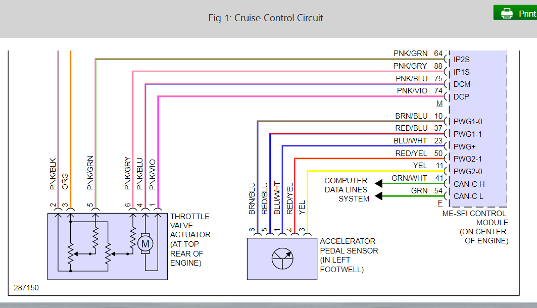

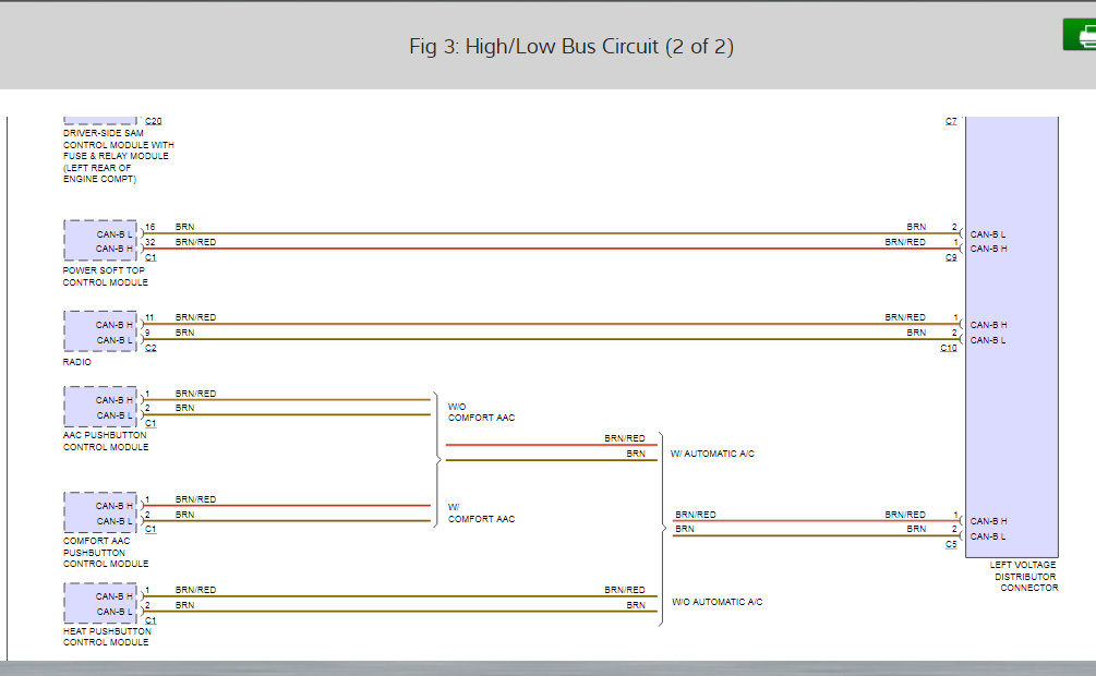

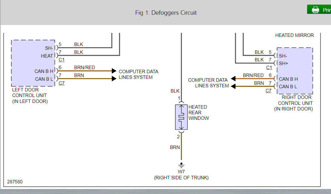

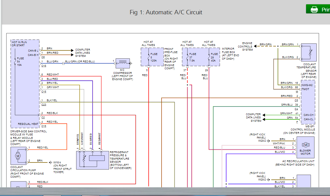

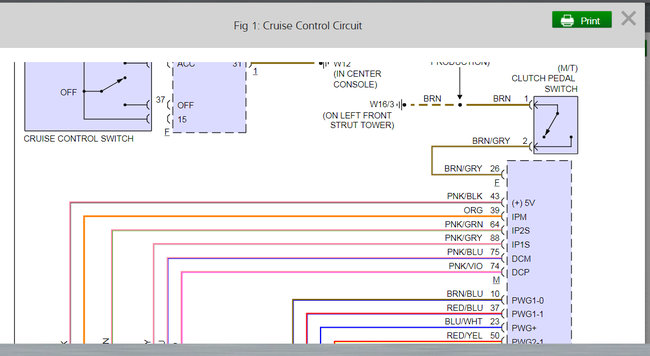

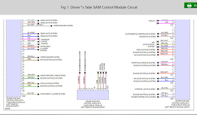

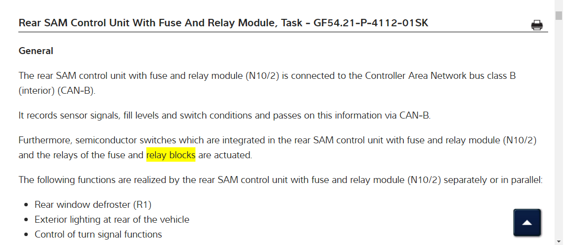

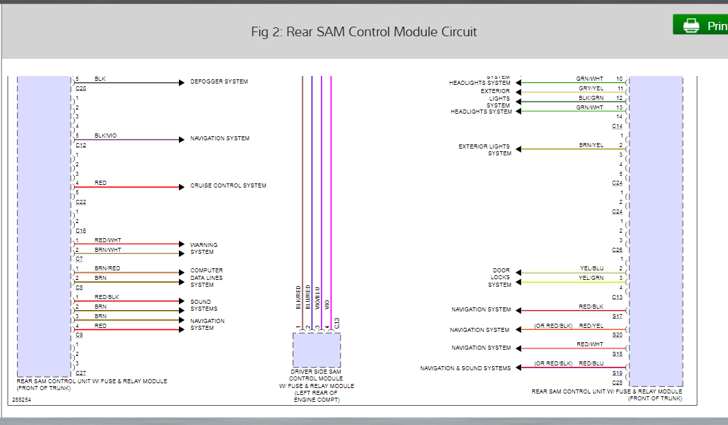

Hello again,

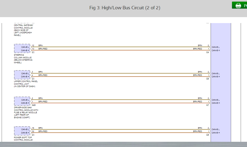

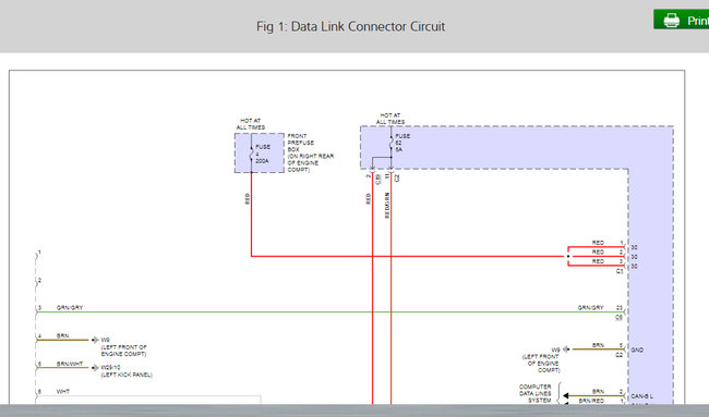

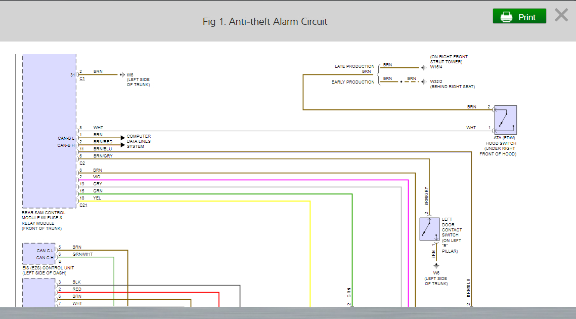

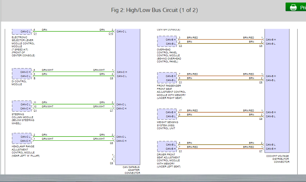

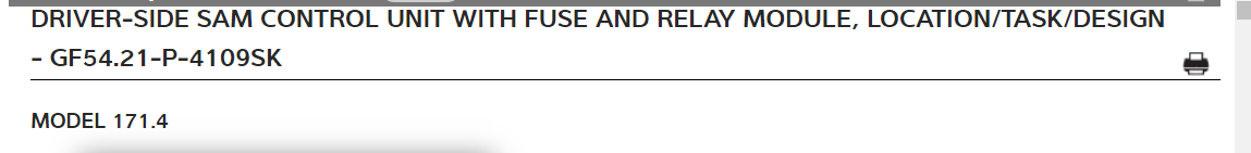

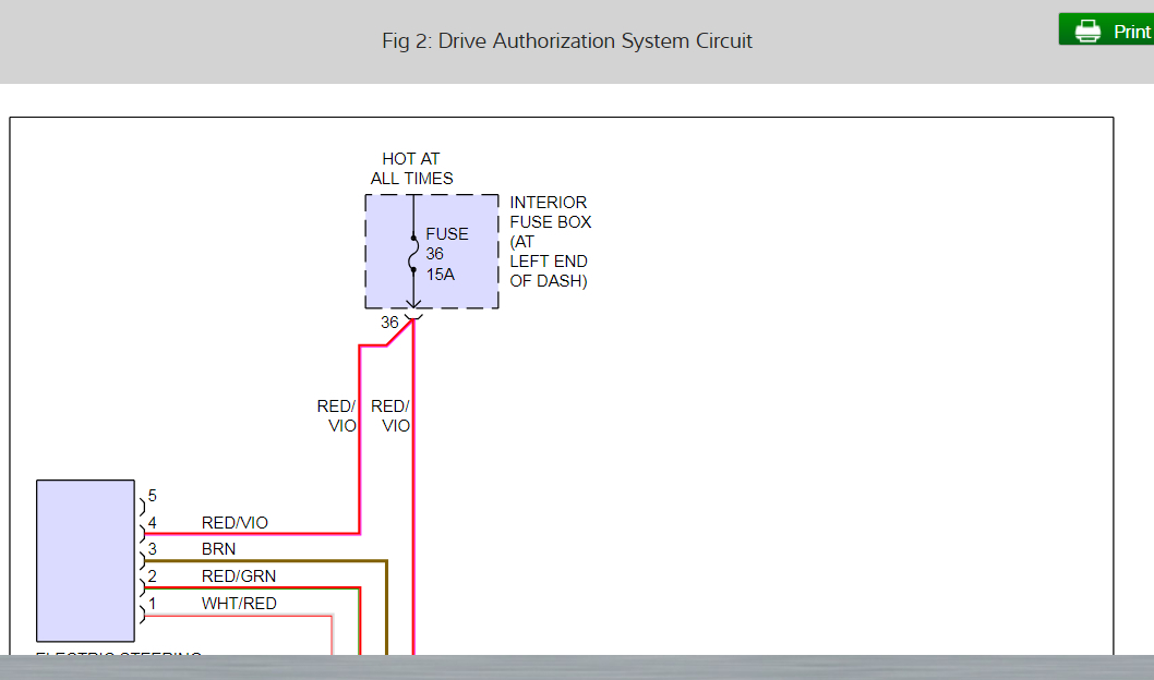

Okay, here is your first batch of wiring diagrams. I will send you your next batch after you've had a chance to digest this batch.
Thanks,
Alex
2CarPros
Apr 30, 2019 at 2:48 AM

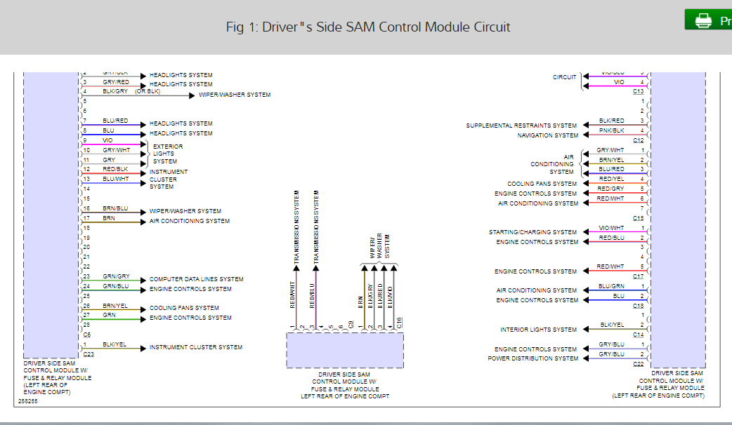

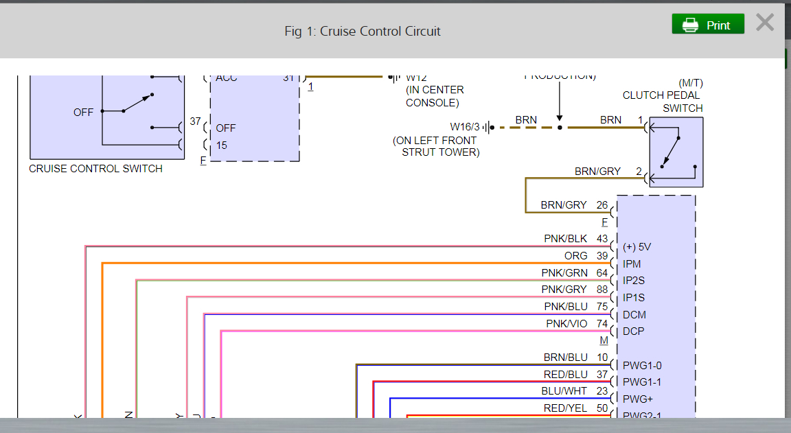

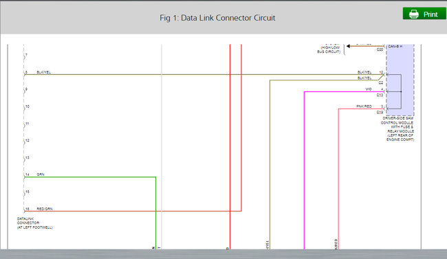

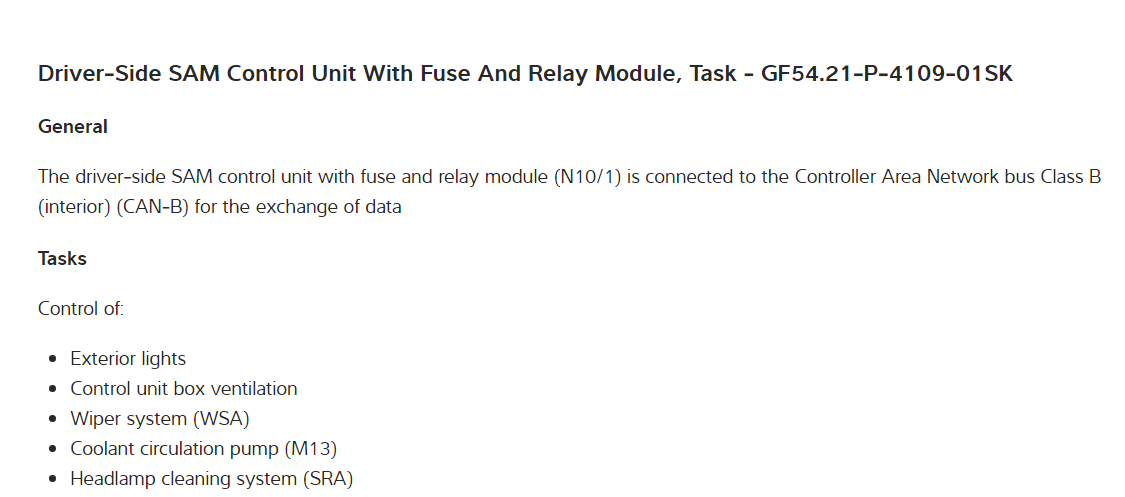

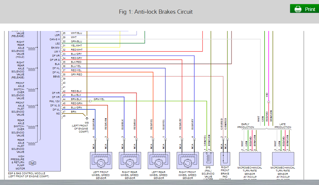

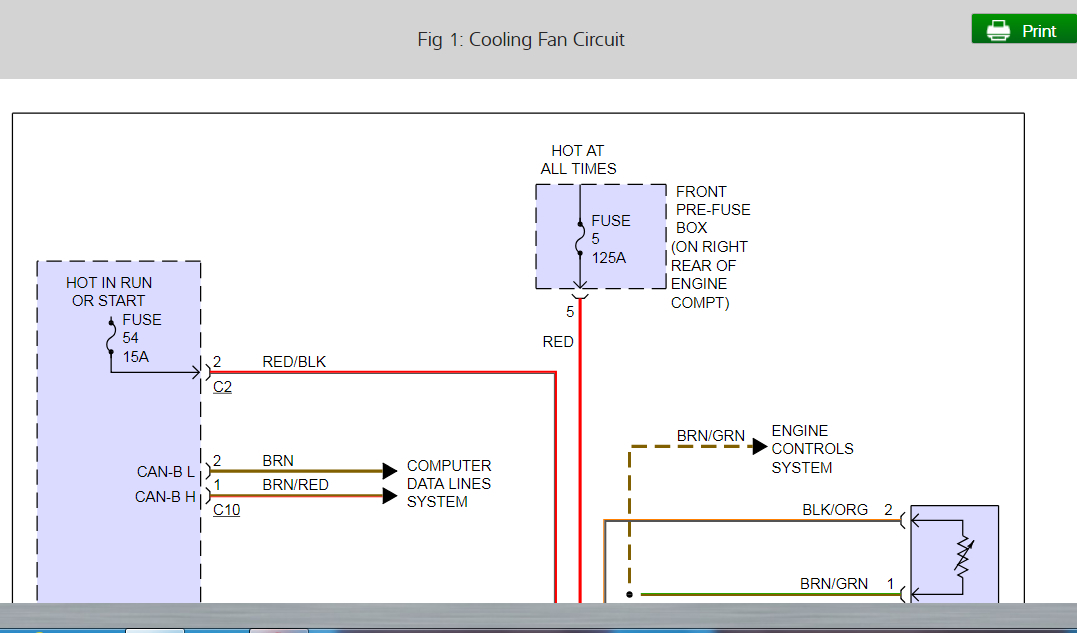

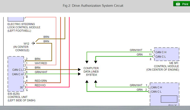

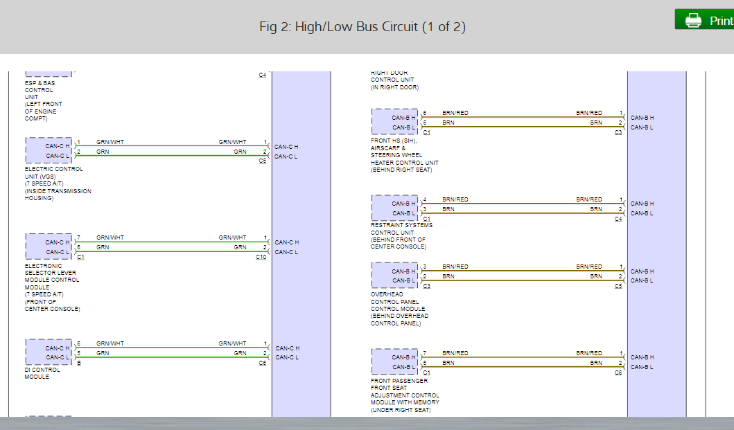

SCGRANTURISMO
  • 4,897 POSTS

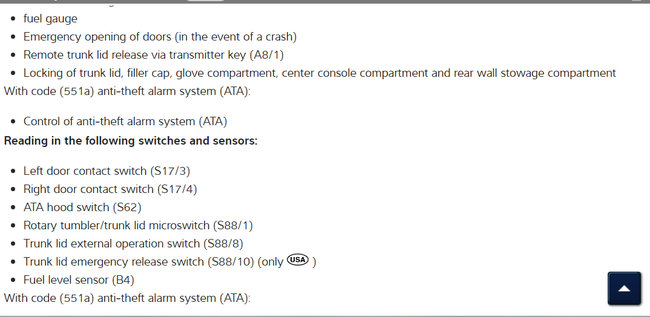

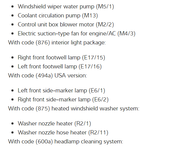

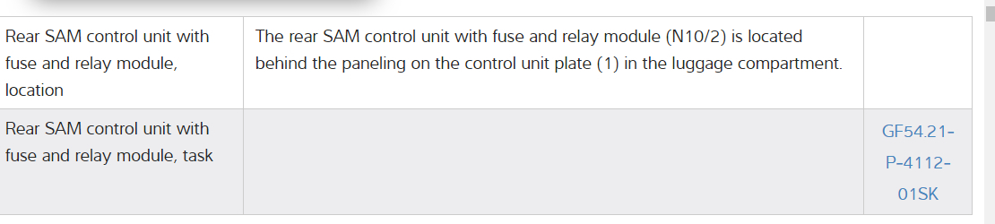

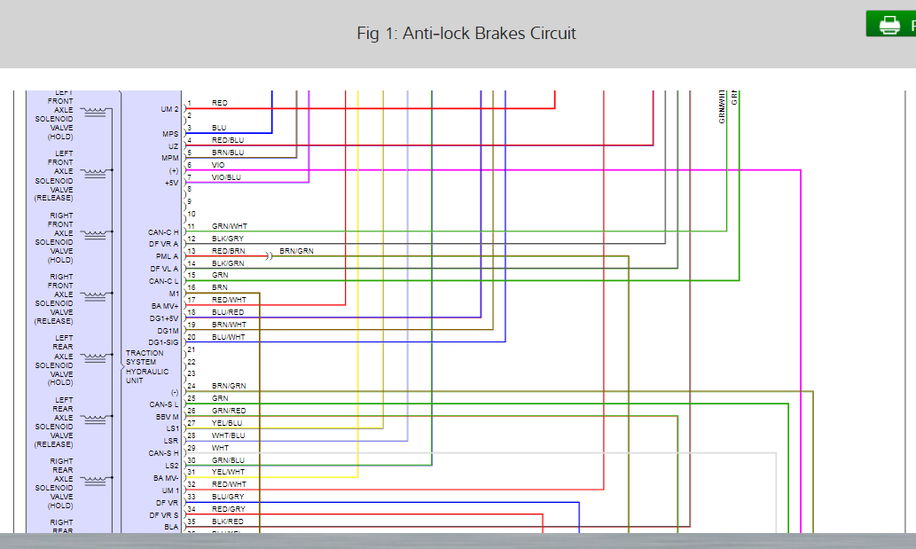

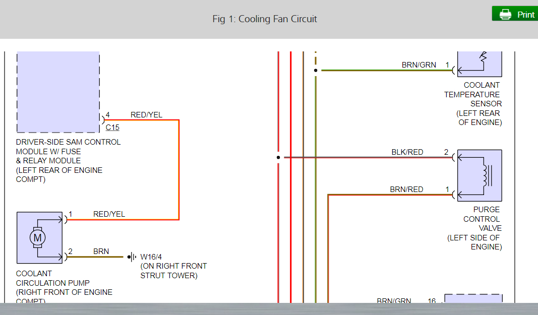

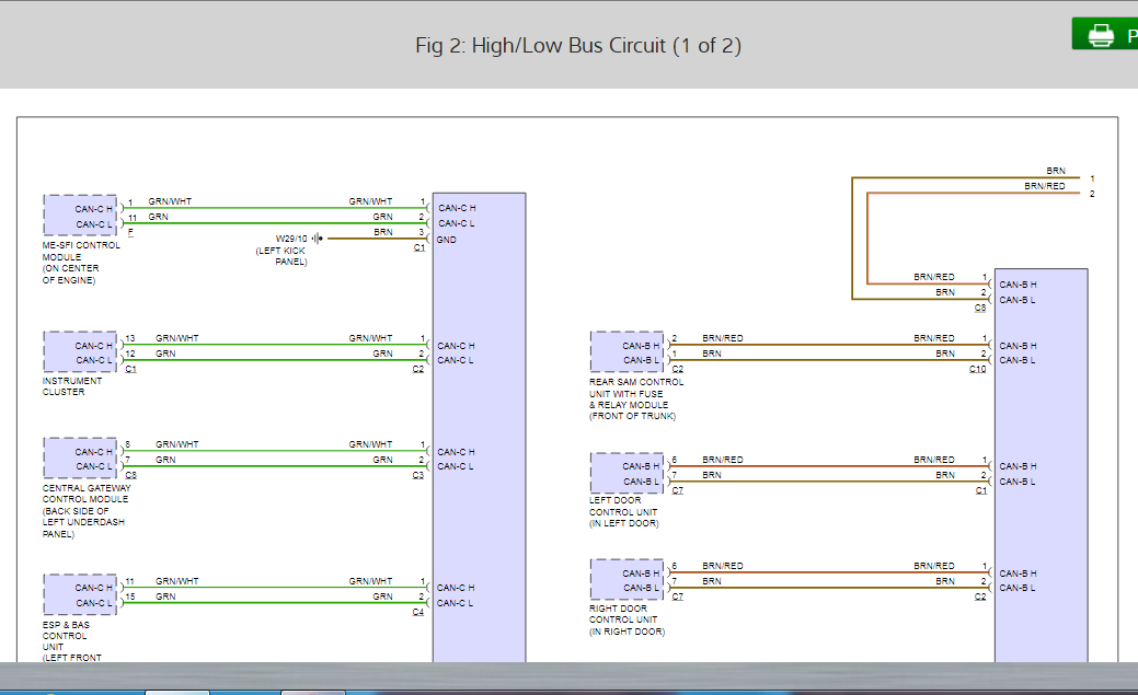

Hello again Suki,

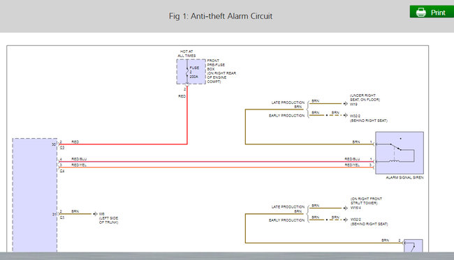

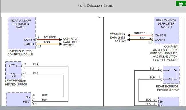

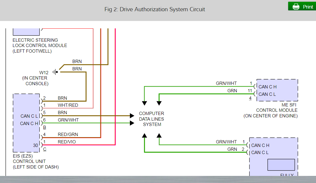

Here is your next batch of wiring diagrams. Have you run into any variations between the wiring diagrams I am sending you and the actual wiring of your vehicle? I will wait to send the next batch of wiring diagrams until I hear back from you letting me know you're ready form them.
Thanks,
Alex
2CarPros

Alex
This is the right stuff but I have to admit being a novice its over my head. Gonna take me a while to work out how to use the diagrams before being able to test the ECU wiring.
Suki
May 1, 2019 at 1:12 PM
SCGRANTURISMO
  • 4,897 POSTS
Hello again Suki,
It's just like reading a book. The electricity is always going to start at the top of the diagram. Notice how all of the fuses for the different circuits are at the top of the page. Then you just follow the wire down to the next component in the circuit, it could be a relay, a switch, a solenoid,eventually it will go to the circuits load. The circuits load is the whole point of the electrical circuit and all available voltage of the circuit should be dropped across the load. In a headlight circuit the load would be, you guessed it, the headlight. After the load, usually, there is going to be a ground. This is just as important as the voltage or (+) side of the circuit. You can tell a ground by three or four stacks lines with the shortest on top and progressively getting bigger on the way down. They look like a little pyramid. Let me know if that makes any sense or not, please.
Thanks,
Alex
2CarPros
