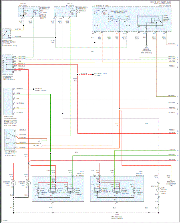

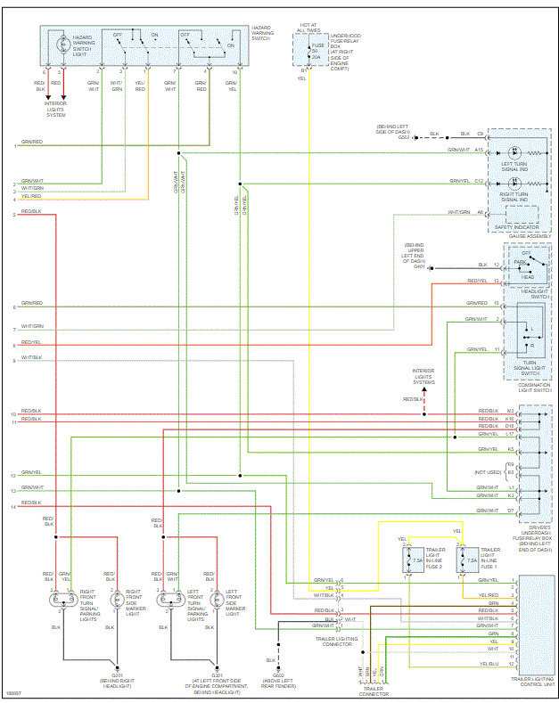

Does anyone have the rear trunk harness wire color to connect?
Dec 16, 2020 at 3:32 PM
CERTIFIED EXPERT
110,175 POSTS
I'm attaching the lighting schematics which include the rear lights. I'm not sure what you are actually looking for. If you have a specific component, let me know what if it.
