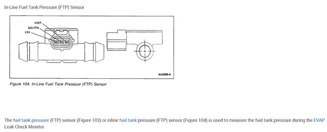

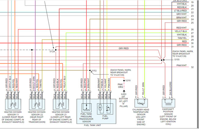

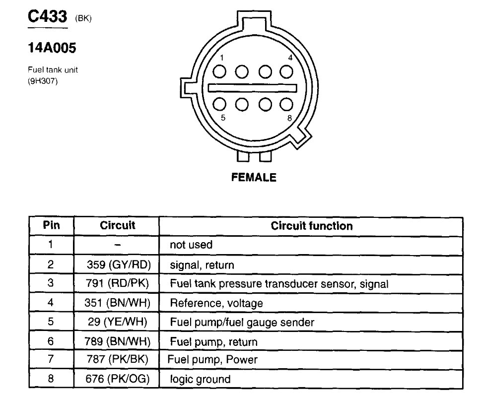

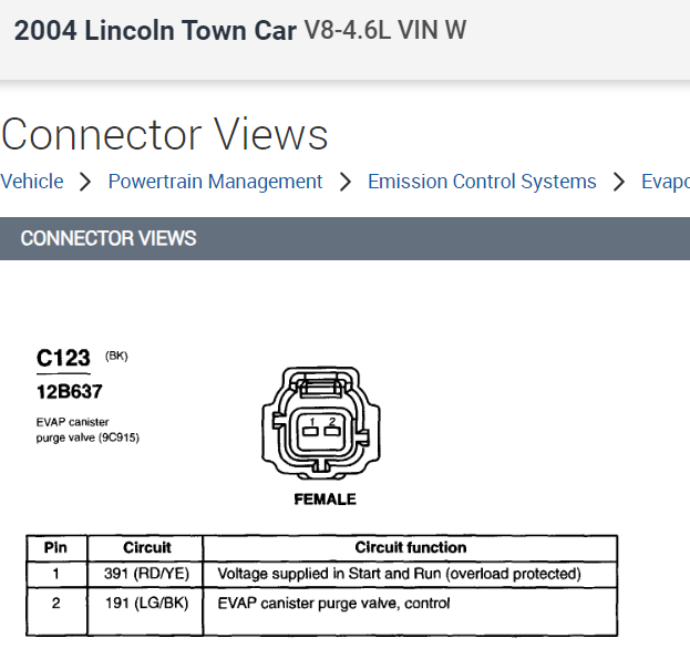

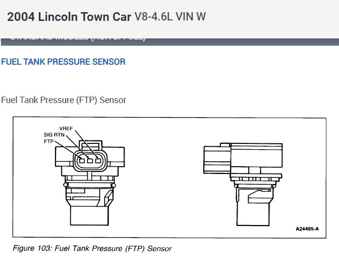

Changed fuel pump assembly. I have to cut and splice wires for purge valve. Wiring on the car has three wires, red, brown with red tracer and brown with white tracer.
New fuel pump assembly has three wires, red, black, blue. Which ones should be connected to which? I am assuming red to red, but the others I don’t know.
