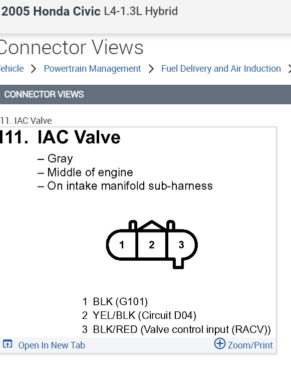

Don’t know the wire coloring code for the pigtail?

Sure, here is the connector pinout which shows the color of the wiring. Check out the images (below). Please let us know what happens.
Image (Click to enlarge)
