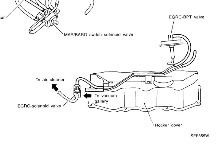

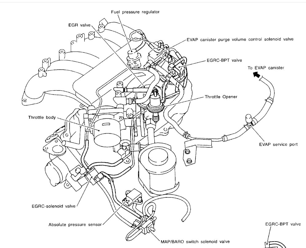

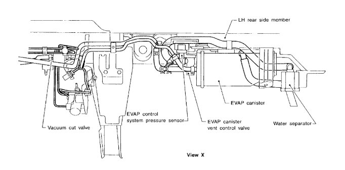

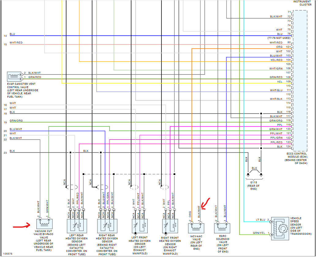

How can I tell which prong on the idle control valve is the is for the hot wire and which prong is for the single one? and what happens if I hook them up backwards? Do you have a diagram for the vacuum hoses back from the throttle body? and I was control about them and all that.
Feb 9, 2025 at 11:20 PM
Here are the vacuum line diagrams and the wiring diagrams for the vacuum cut valve and the IAC valve as well. Check out the images (below). Let us know if you need anything else.
