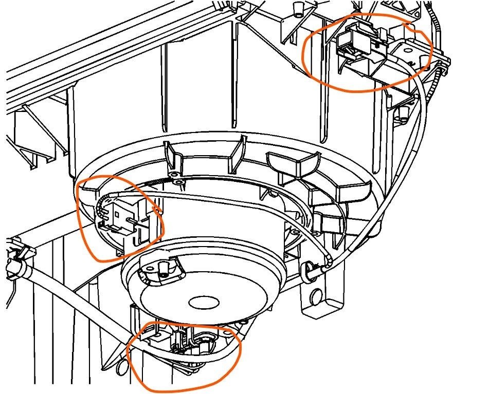

STEVE W.
  • 15,113 POSTS
No. It should plug in above the blower motor as shown to the upper right in this image.

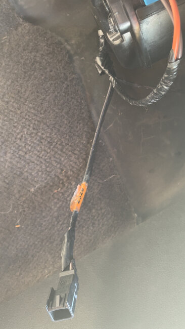

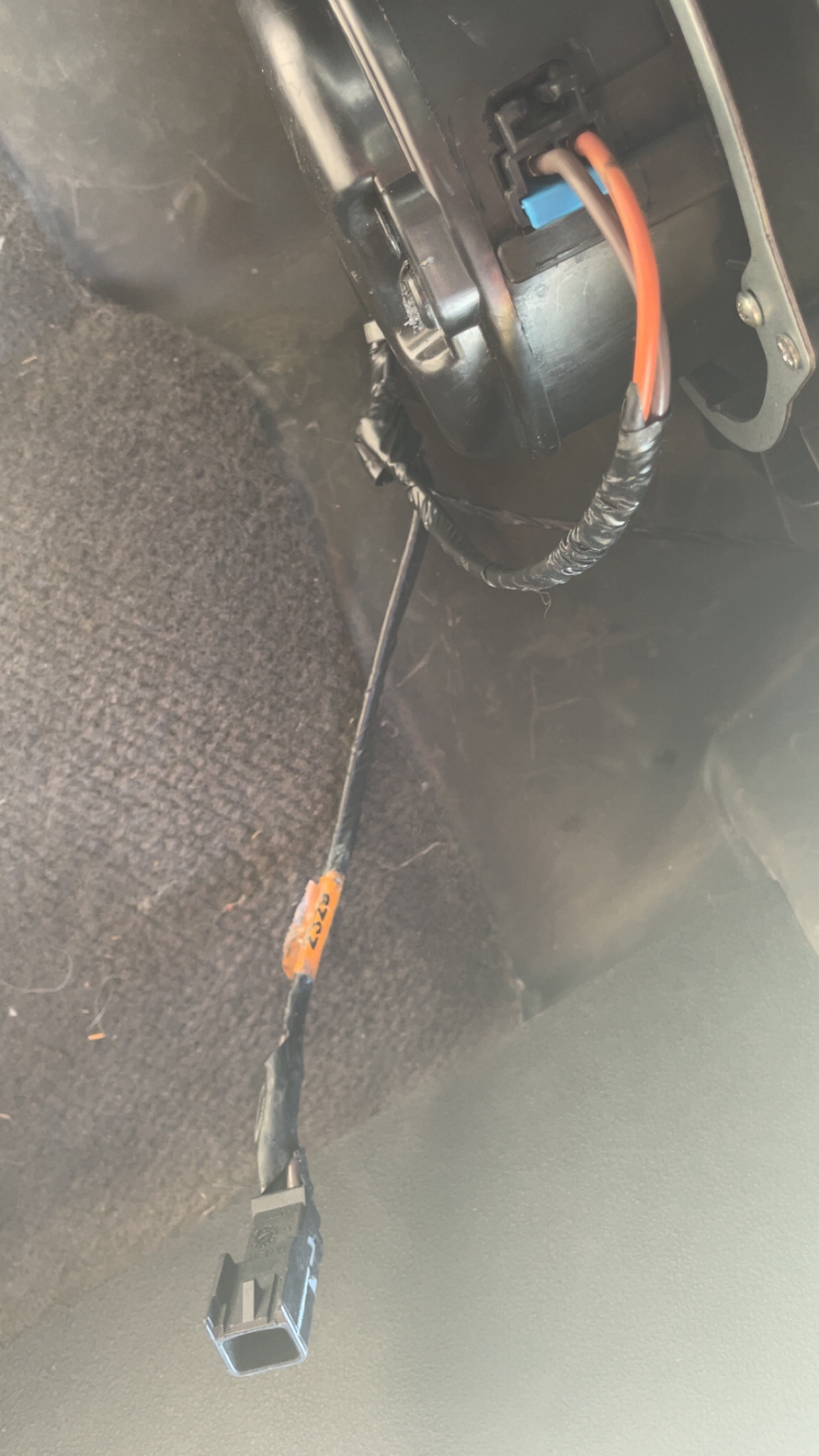

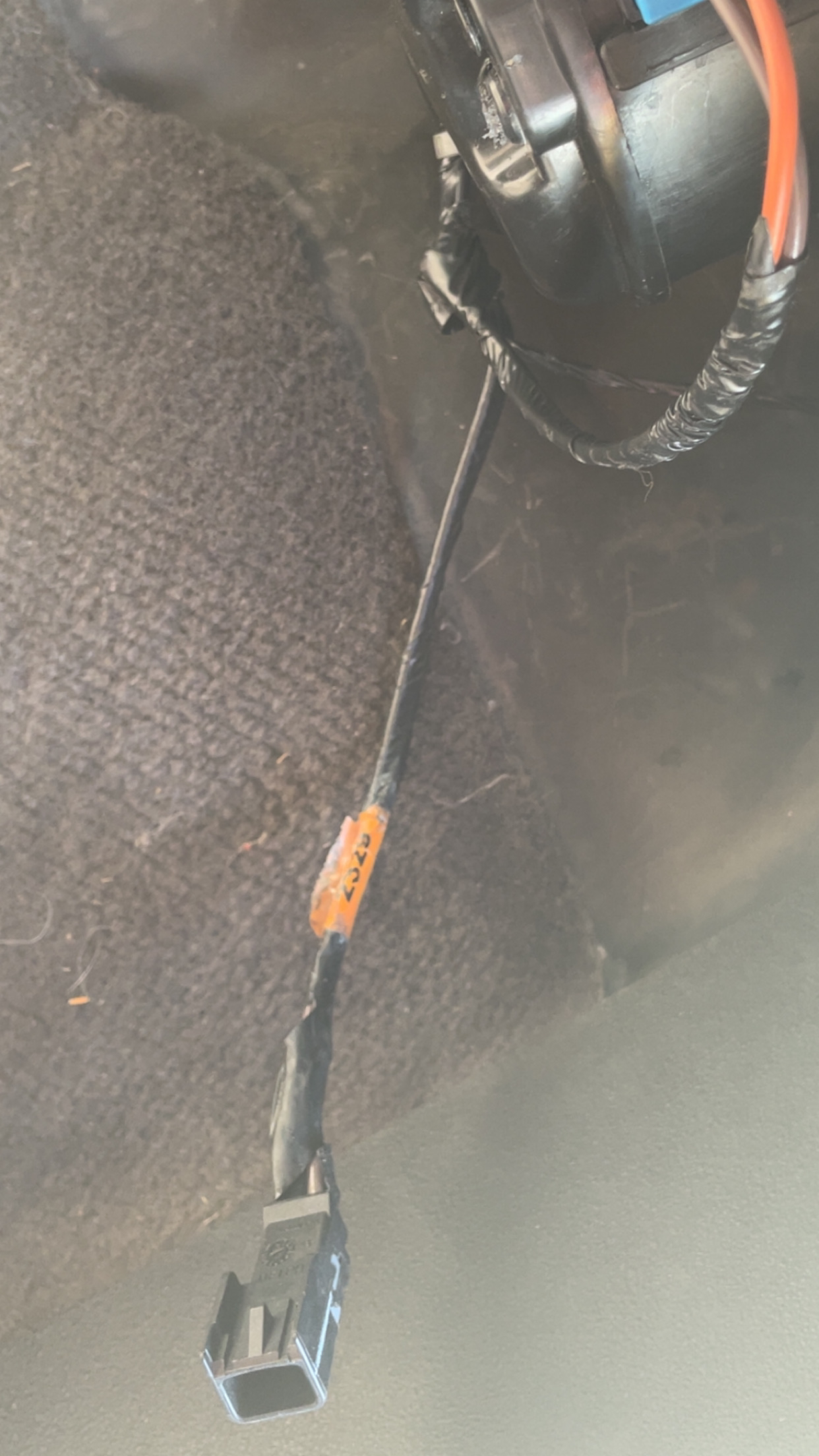

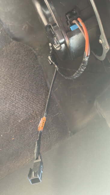

HARKLESS278
  • 7 POSTS
I figured it out the Plug itself is missing do you know what it is called?

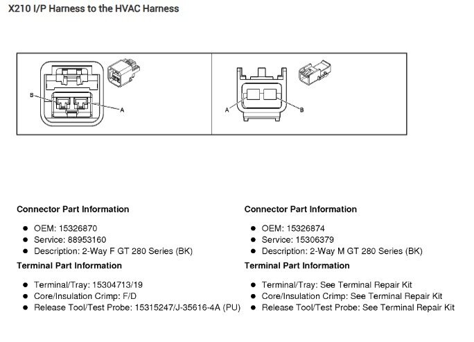

STEVE W.
  • 15,113 POSTS
It is connector X210 Just an inline connector. The brown wire powers the blower while the black wire is a ground. The attached is the OE info on it.
