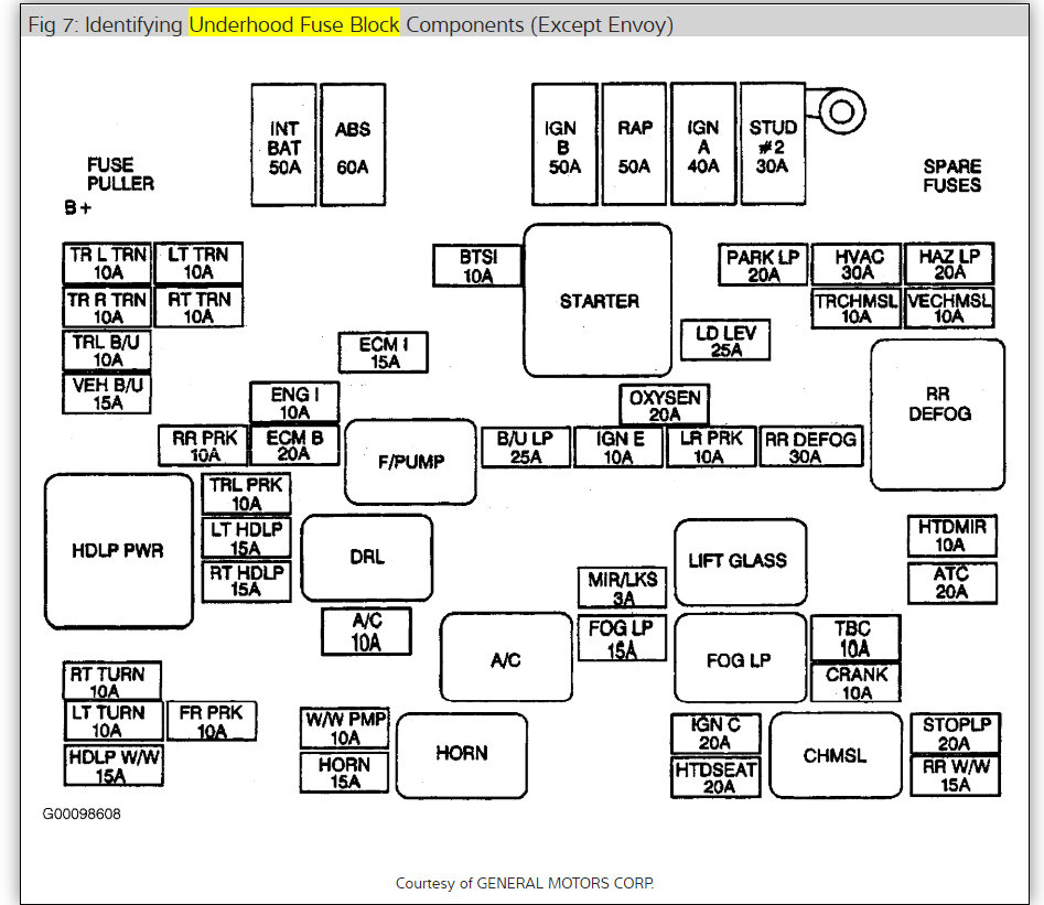

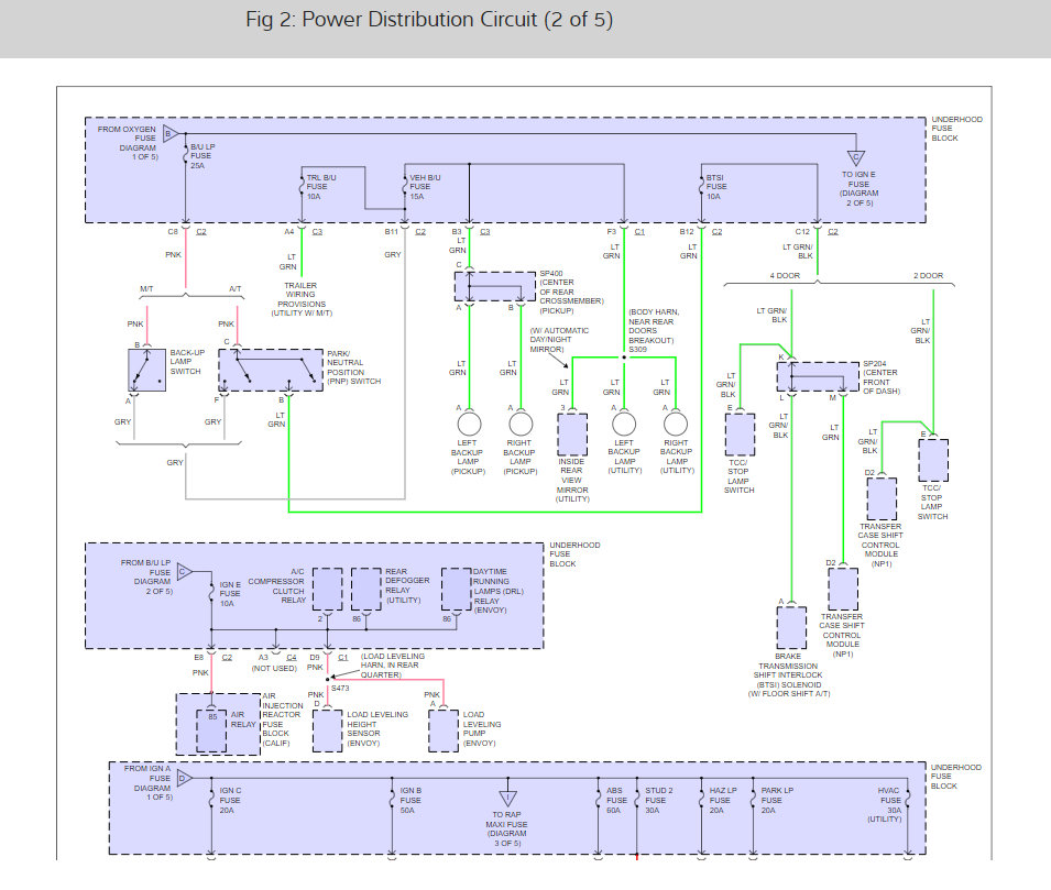

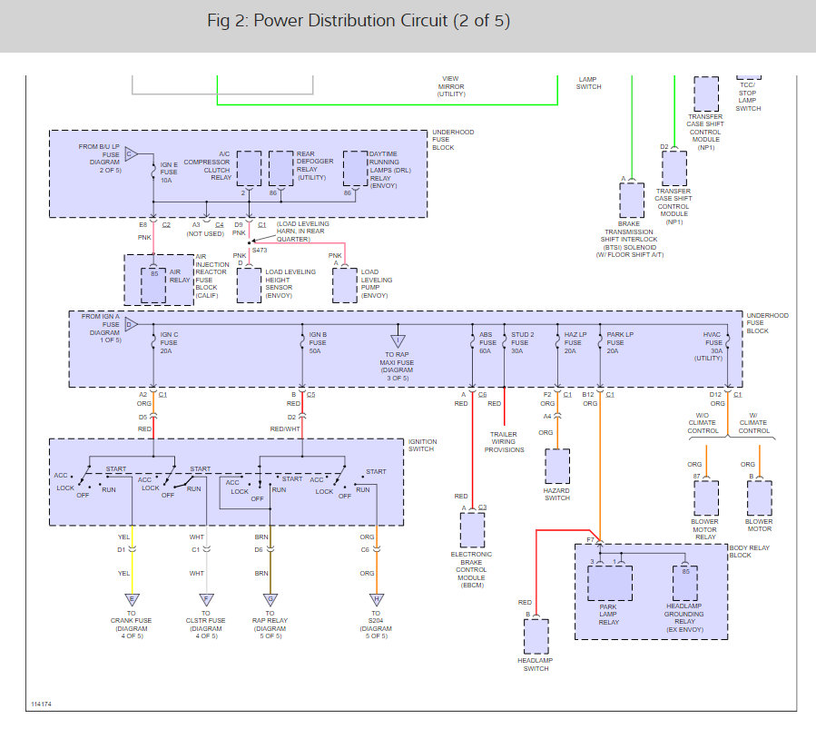

I am having electrical problems in my research I found out that the wipers, temperature gauge,and blower motor for the heater take power from the ignition switch. So I pulled the switch out and I jumped power between the switch and the blower motor, temperature gauge, an wipers all started to work. So I figured I had a bad ignition switch so I replaced the ignition switch and I am still not getting power to these things. The truck will turn over and start just fine but it seems like I am not getting power through the switch in run. Any help would be appreciated. Thanks
